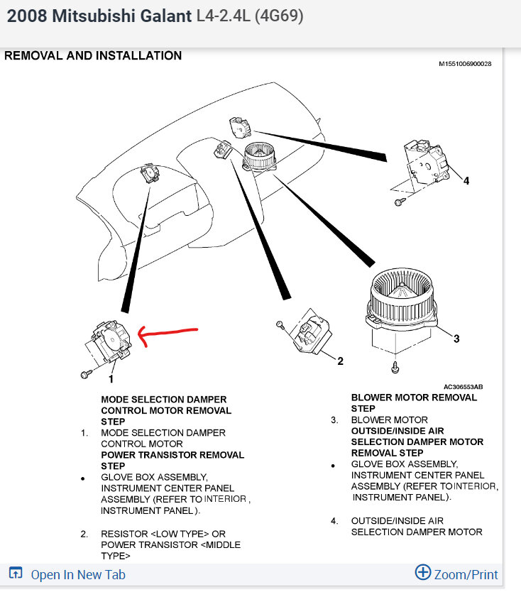

Okay, it sounds like the A/C is working, I would start the engine and turn the system on and then grasp the larger refrigerant line to see if it is cold, if so, there is a mode blend door actuator that would like it is not working.
Here is a guide to help and the location of the actuator so you can check it out:
Check out the images (below). Let us know what you find.

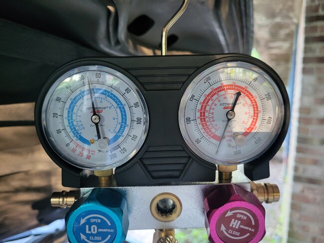

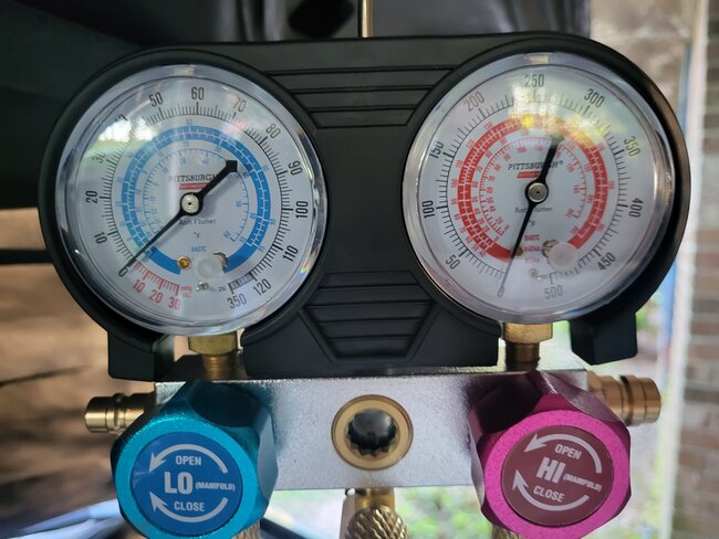

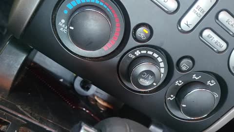

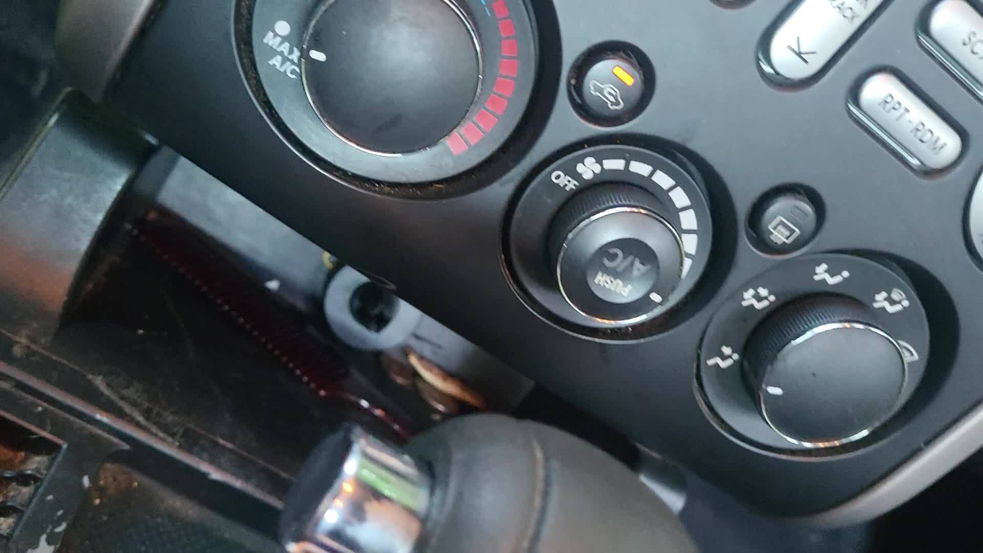

A/C light flashing when both needles drop when clutch is engaged.
Clutch not engaged low side 55 PSI high side 0 PSI.
Jun 24, 2024 at 11:09 AM
  • 55,421 POSTS
Nice work, but I don't see any pressure on the high side is the gauges connected? Please connect the high side gauge. The #1 reason the A/C light will blink is low refrigerant levels. We should run a CAN scan to see if there are any codes stored of other issues such as a pressure sensor that has shorted, please go over this video to show you how.
