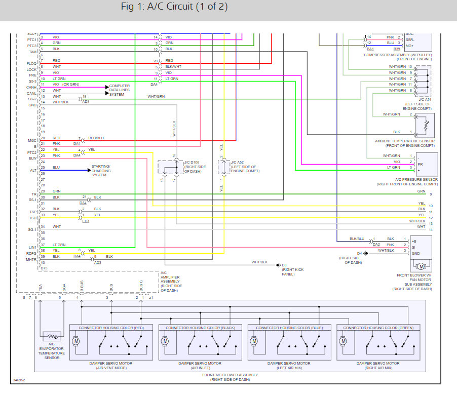

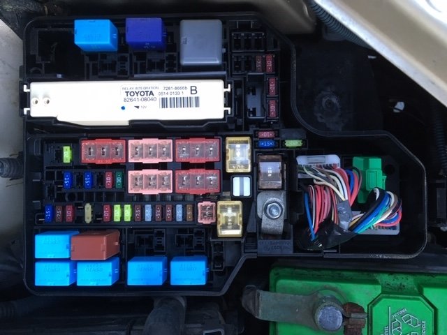

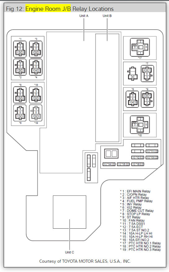

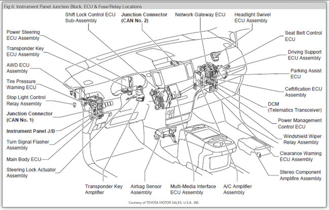

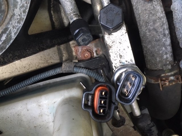

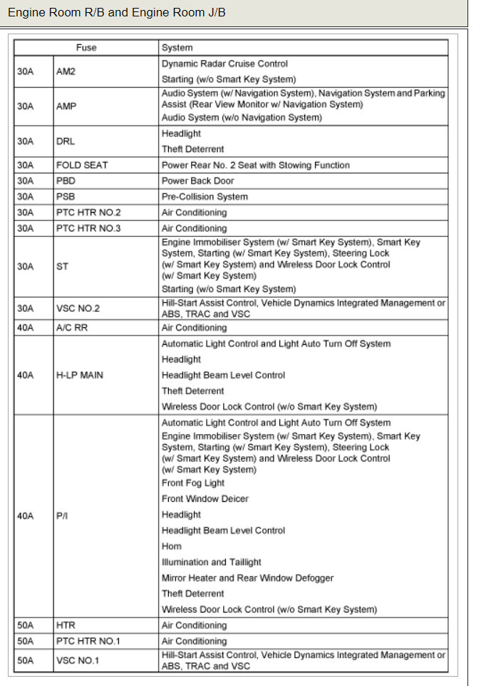

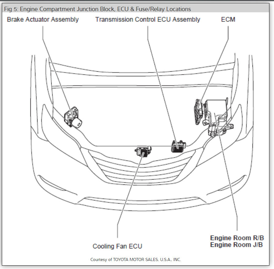

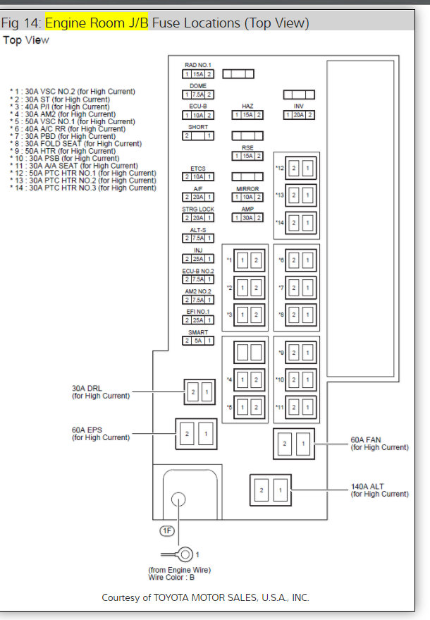

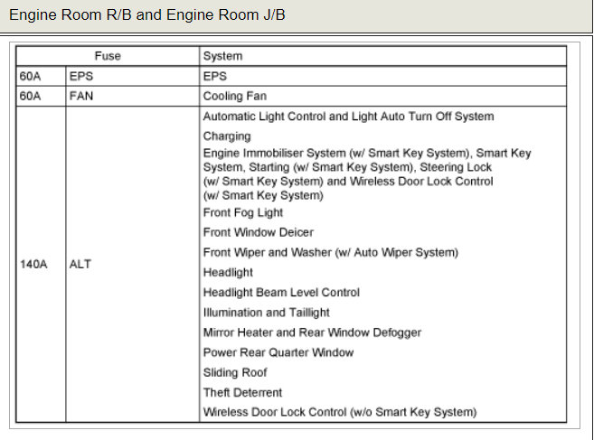

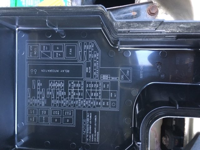

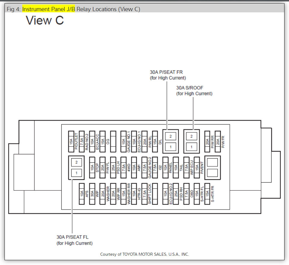

Van listed above is the Limited model. A/C blowing hot air and compressor not engaging. Not sure which relay is for the A/C compressor. It won't take Freon since the compressor won't engage. Not sure if it is the relay integration switch since I don't know how to check that. And I don't know how to jump the pressure switch since it has 3 slots. Pictures attached.
Appreciate your help!.
Sep 29, 2019 at 3:50 AM
  • 55,844 POSTS

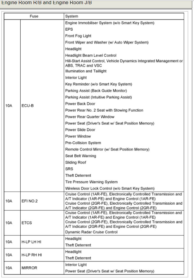

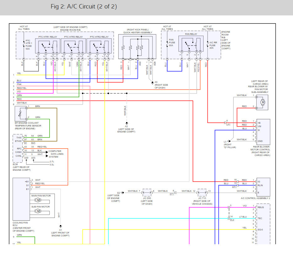

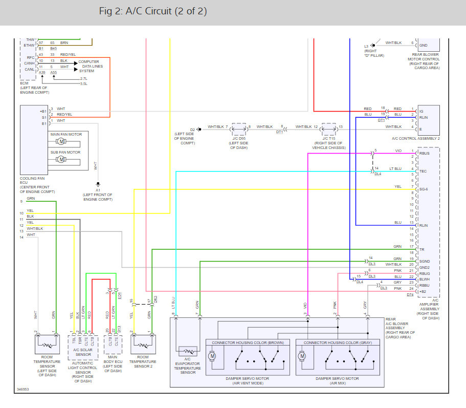

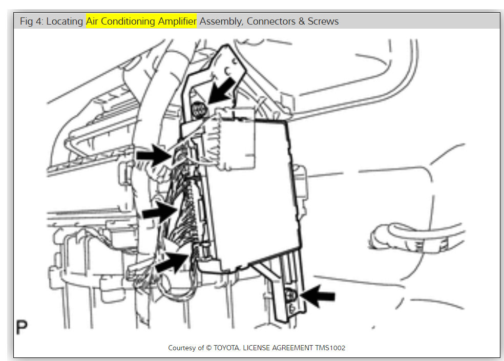

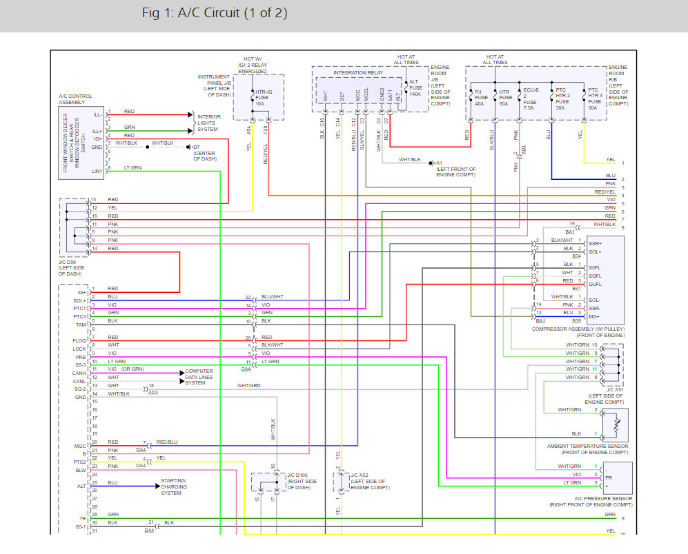

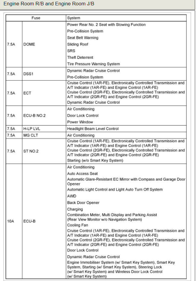

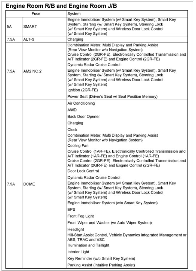

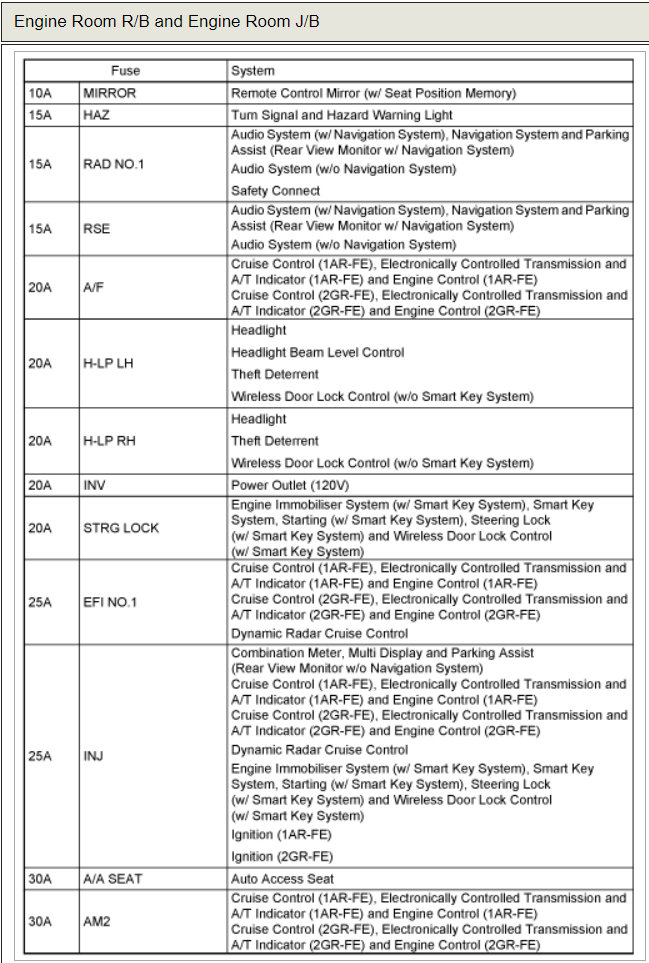

There is an air conditioner amplifier that runs the compressor along with 7 fuses. here are the wiring diagrams for the system so you can see how it works and a guide to help you test for power:

I took it to Toyota and they said that the fuses and relay are fine. They won't diagnose the problem for free. Any other suggestions?

Does the system have pressure? Here is a guide and a video to help us:
