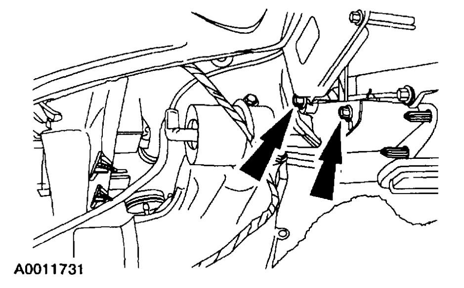

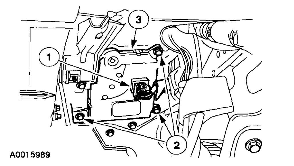

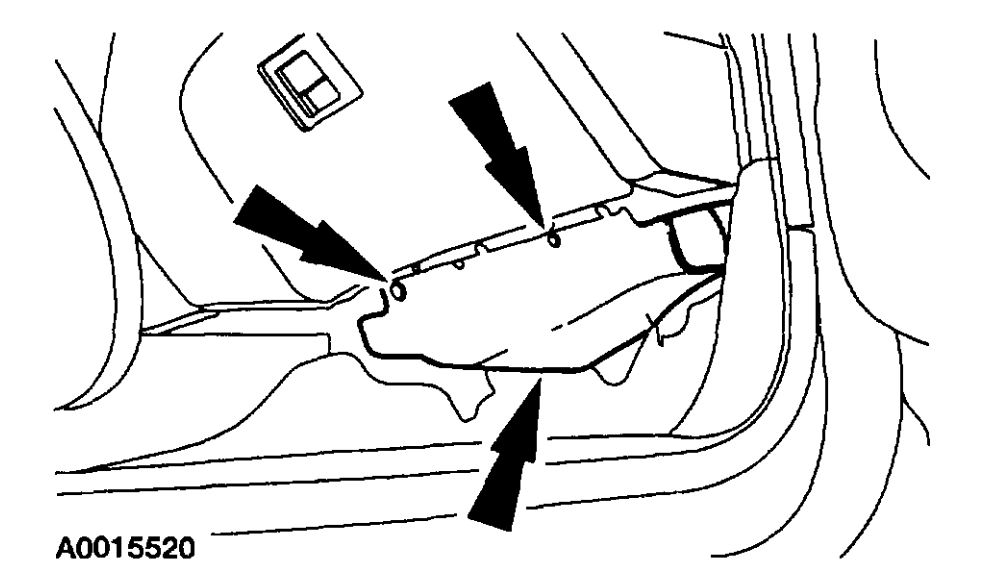

Can you hear the blend door move back and forth when you command heat and cold?
REMOVAL
1. Remove the integrated control panel. Refer to Climate Control Assembly-Integrated Control Panel.
2. Remove the right-side lower instrument panel insulator.
3. Remove the temperature blend door linkage shield.
4. Remove the temperature blend door actuator.
1. Disconnect the electrical connector.
2. Remove the screws.
3. Remove the temperature blend door actuator.
INSTALLATION
1. To install, reverse the removal procedure.
