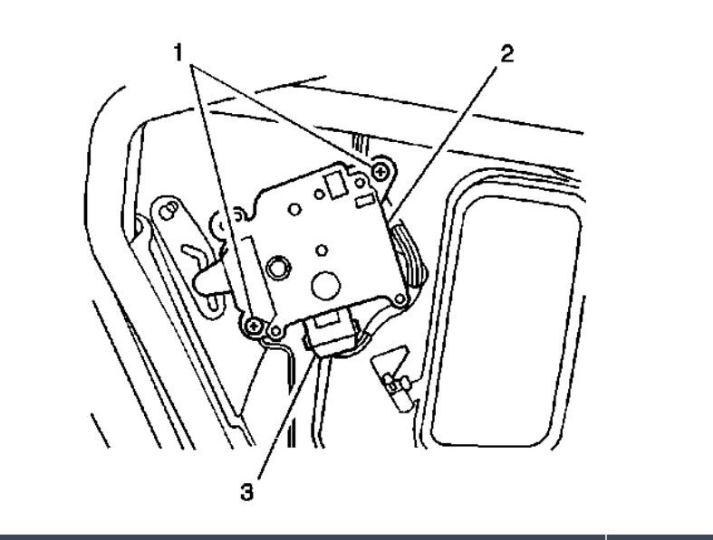

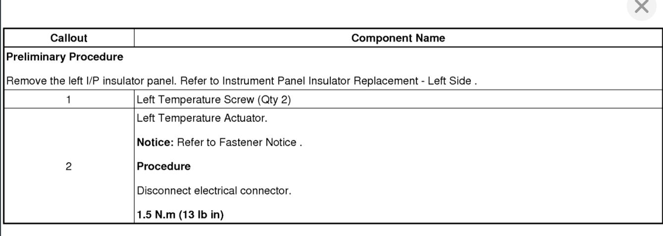

Can you include the blending door actuators the right #89023390 and left #89023389 instructions?
I am waiting for them all and in the mean time I would like to study the proper procedure to remove and replace these blend door actuators as well..
Thanks, Floyd
Aug 24, 2020 at 2:37 PM

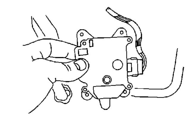

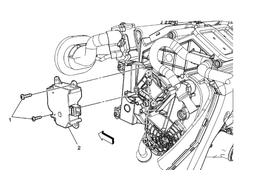

Good morning,
II attached the procedures for you for the replacement.
It is a straight forward replacement.
Air Temperature Actuator Replacement - Right Side
Removal Procedure
1. Remove the blower motor control module. Refer to Blower Motor Control Module Replacement (See: Control Module HVAC > Removal and Replacement > Blower Motor Control Module Replacement) .
2. Remove the right air temperature actuator screws (1).
3. Remove the right air temperature actuator.
4. Disconnect the right air temperature actuator electrical connector.
Installation Procedure
1. Connect the right air temperature actuator electrical connector.
2. Install the right air temperature actuator.
Notice: Refer to Fastener Notice (See: Vehicle > Vehicle Damage Warnings > Fastener Notice) .
3. Install the right air temperature actuator screws (1).
Tighten the screws to 1 N.m (9 lb in).
4. Install the blower motor control module. Refer to Blower Motor Control Module Replacement (See: Control Module HVAC > Removal and Replacement > Blower Motor Control Module Replacement) .
