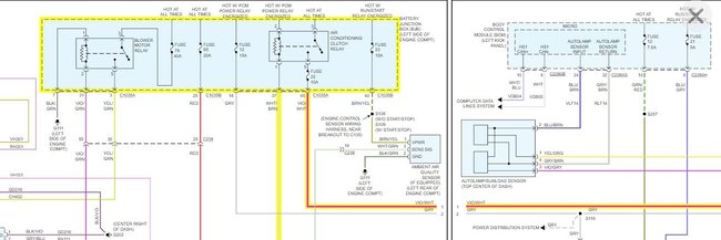

First my car is an MKC not on list provided so I marked MKX. My air is blowing hot air. I bought A/C PRO and when I put tester on it went straight to the red which says see service tech.
Jul 10, 2019 at 9:37 PM
PATENTED_REPAIR_PRO
  • 1,853 POSTS
Are you saying the A/C is overcharged with R134A?
Jul 10, 2019 at 10:11 PM
Good morning,
Does the compressor turn on when you command A/C?
You need a set of gauges to give me the high and low side readings so I can see the readings.
Do you have a test light or voltmeter to check voltages for the system?

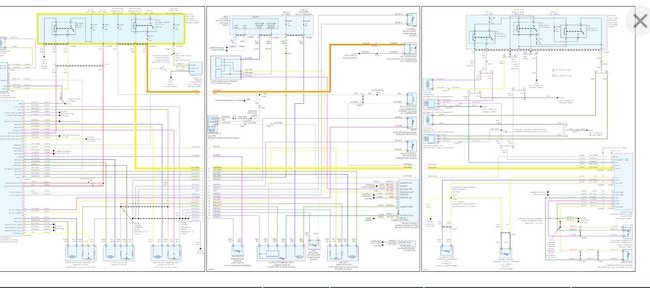

I attached a wiring diagram for you to view. Check the fuses for power on both sides with the key on.
