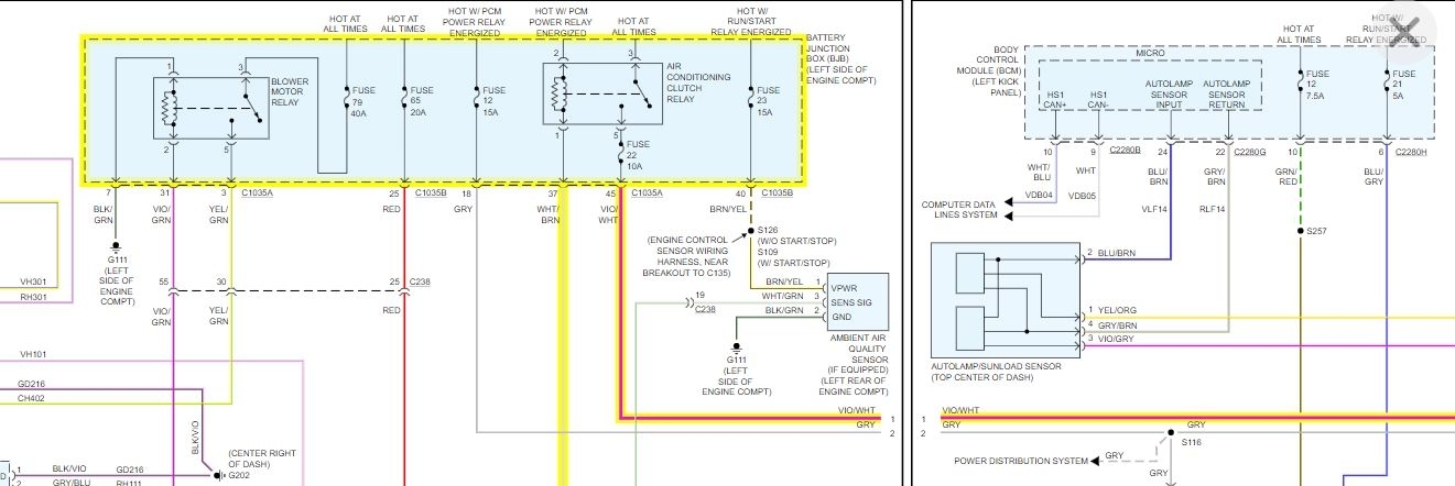

First my car is an MKC not on list provided so I marked MKX. My air is blowing hot air. I bought A/C PRO and when I put tester on it went straight to the red which says see service tech.

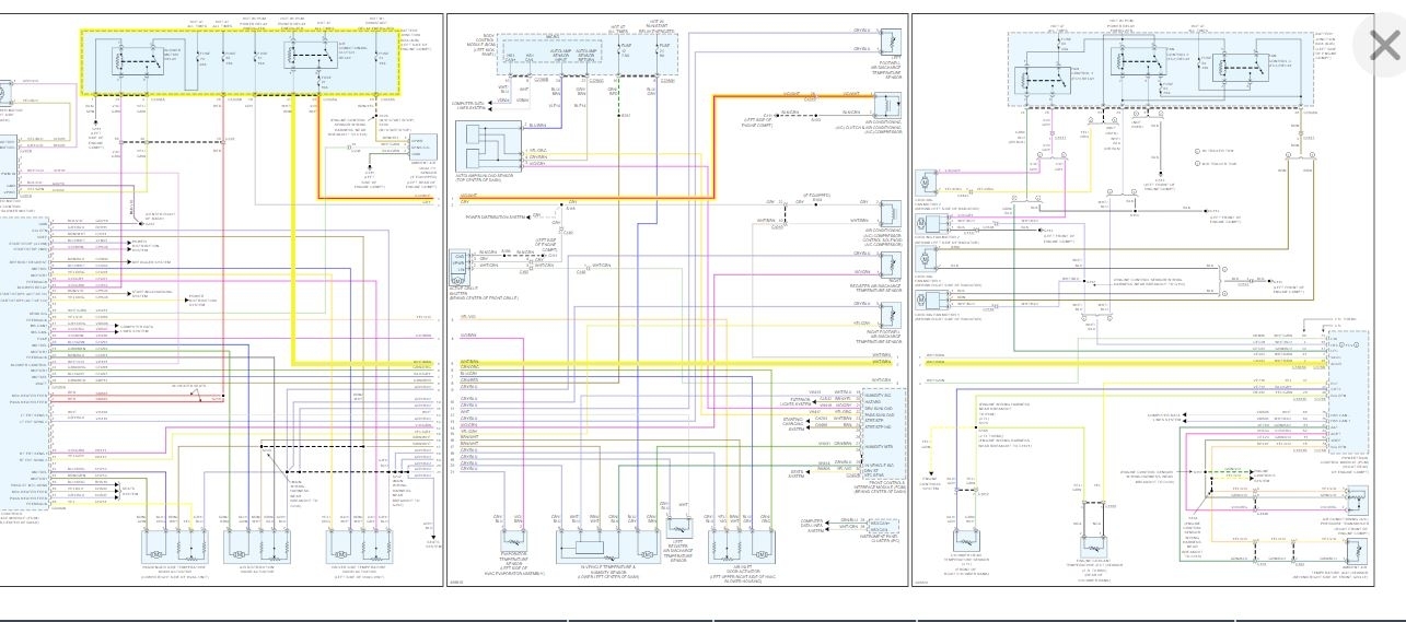

Good morning,
Does the compressor turn on when you command A/C?
You need a set of gauges to give me the high and low side readings so I can see the readings.
Do you have a test light or voltmeter to check voltages for the system?
I attached a wiring diagram for you to view. Check the fuses for power on both sides with the key on.
