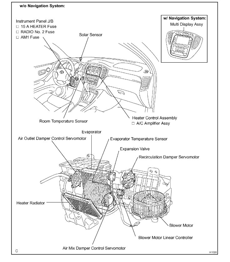

I had to come to a sudden stop today and the A/C started blowing hot. The A/C light stayed solid on. Sometimes when I go through a puddle, the A/C will stop working for a bit. But at those times the light will flash. Then when the A/C starts up again, the light will go solid.
To troubleshoot this issue, I pulled the fuse for the A/C (even though everything else on that fuse was working fine.). When I pushed it back in, the A/C worked again. I can't imagine what could have happened. Can you give me any professional insight? I don't want this happening again.

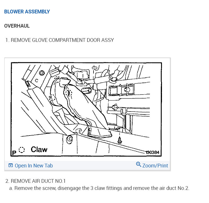

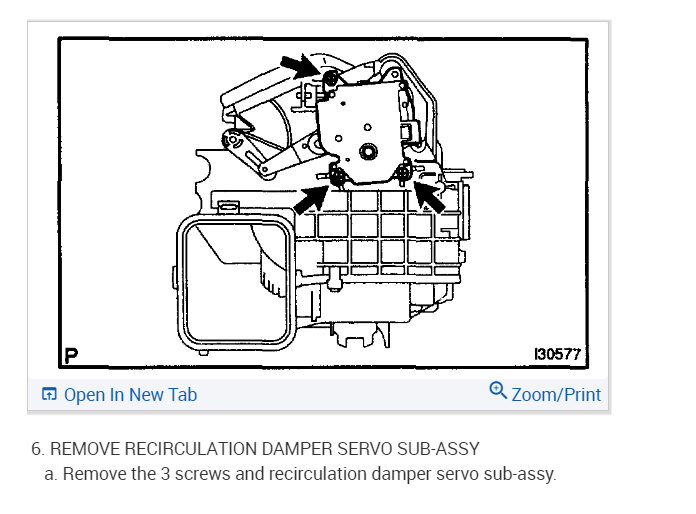

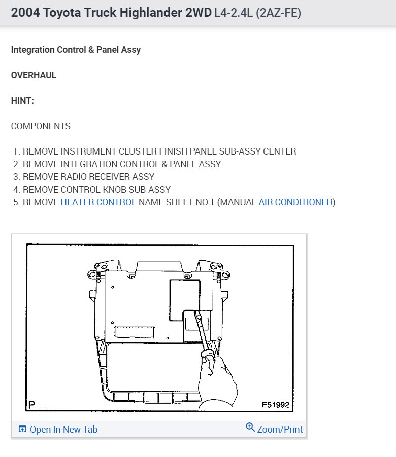

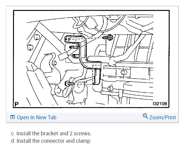

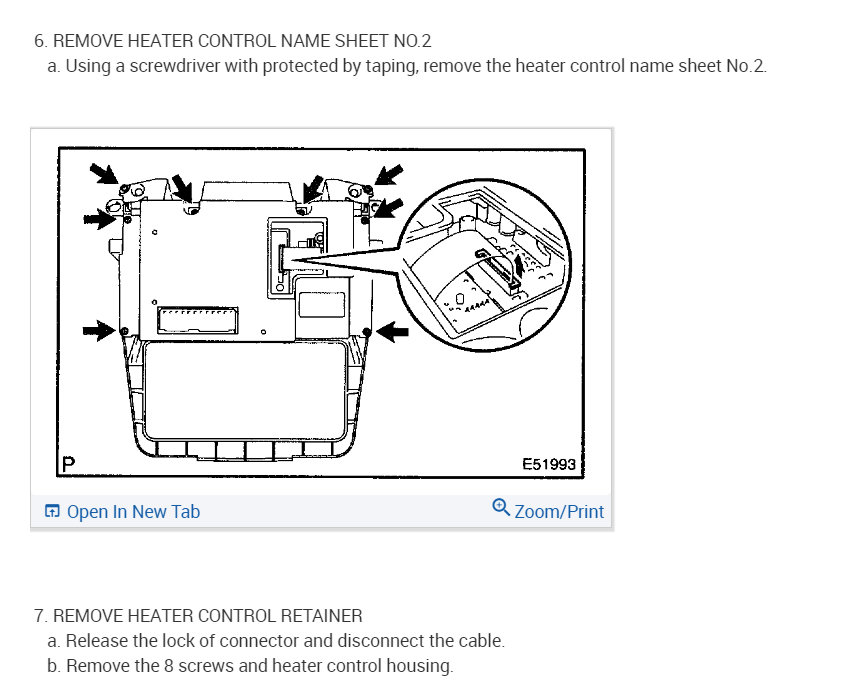

The fact you went through a puddle, it probably got the A/C belt wet and that made it slip or the compressor clutch slip, please check the belt. Also, if you let the system cool a bit it sounds like it starts working again which it telling me you might have too much refrigerant in the system, can I ask if you had the system recharged recently? If not, I would lean towards a temperature blend door actuator, they call it an air mix servo motor. This can guide can help and I have included the location of the actuator in the diagrams below. I would remove the actuator and then work the temperature knob to see if it moves okay.

It sounds like you reset the system when you pulled the fuses which can be the air mix door actuator. Also, the system can be low on refrigerant. This guide can help:

Charged the system. Blows cold, but I am still having the problem where the A/C unpredictably cuts out. I don't hear any clicking sound that would indicate a bad actuator. Sometimes if I smack the center of the dashboard, the A/C will pop on. I'd just buy an actuator to give replacement a shot, but they are not cheap; What would you suggest to do next?

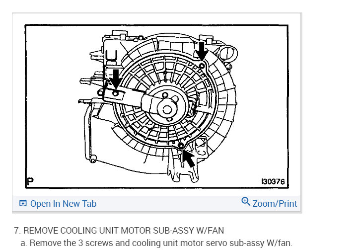

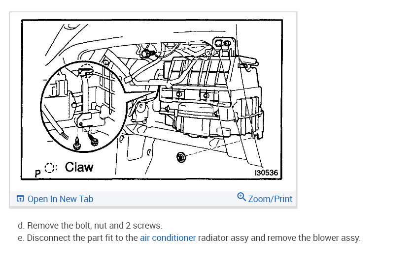

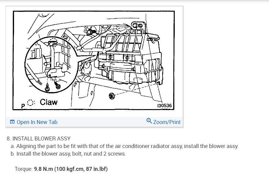

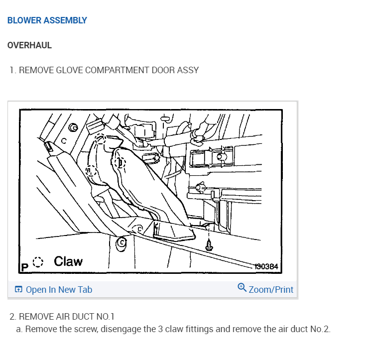

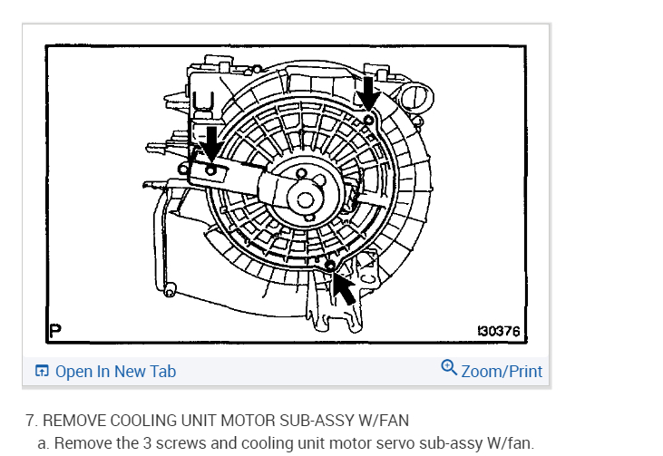

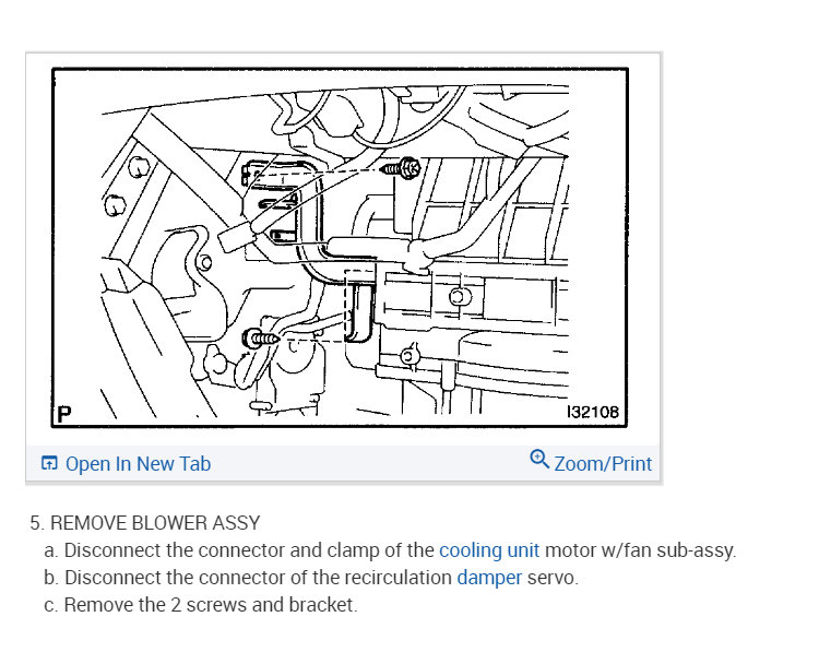

This sounds like the blower motor is going bad. To be sure let's check the power and ground to the blower motor once the air stops, this guide can help:
https://www.2carpros.com/articles/blower-fan-motor-works-on-high-speed-only
The blower motor location is tin the images below. Check out the diagrams (below). Please let us know what happens.

There doesn't ever seem to be a problem with air blowing through the vents. The air blows fine, it just doesn't blow cold. That's why your suggestion about the actuator made more sense. Does the A/C have a separate blower? Your thoughts?
Aug 12, 2022 at 6:17 AM
  • 55,732 POSTS

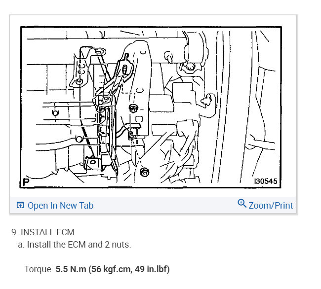

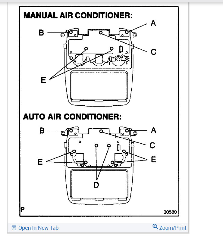

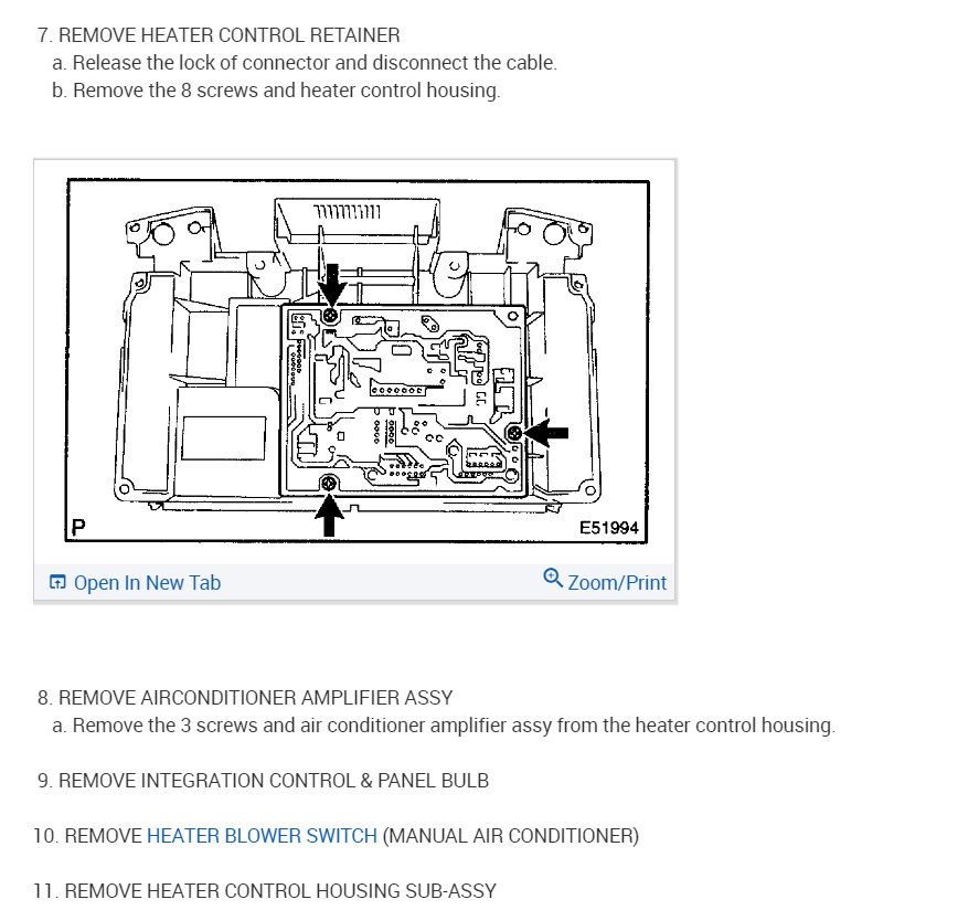

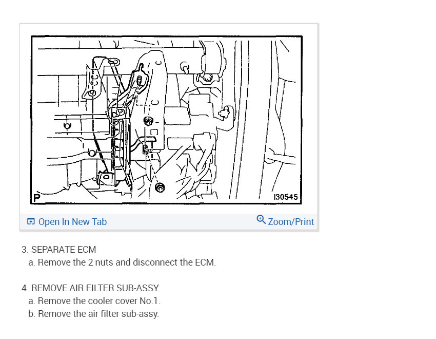

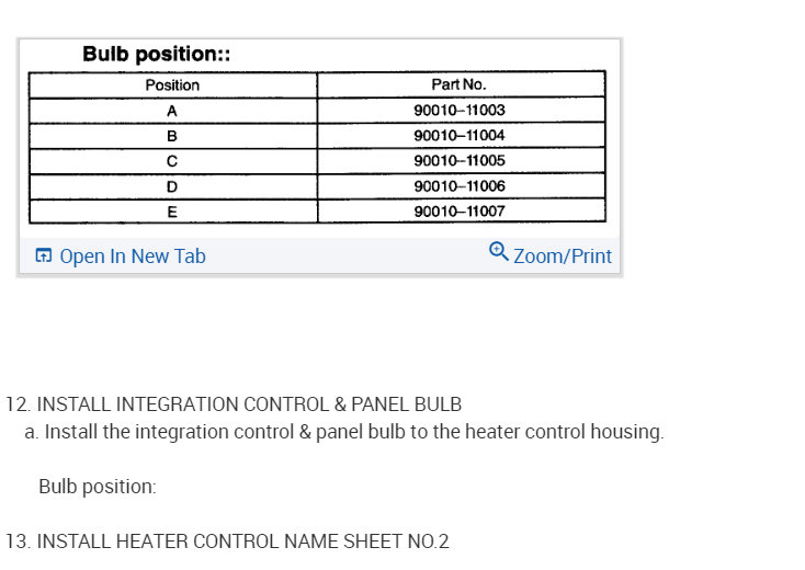

No, it doesn't. it could be the HVAC controller if it isn't the blend door actuator. Let me know. Check the images below.
