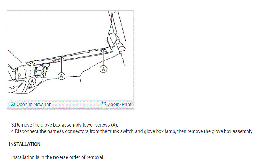

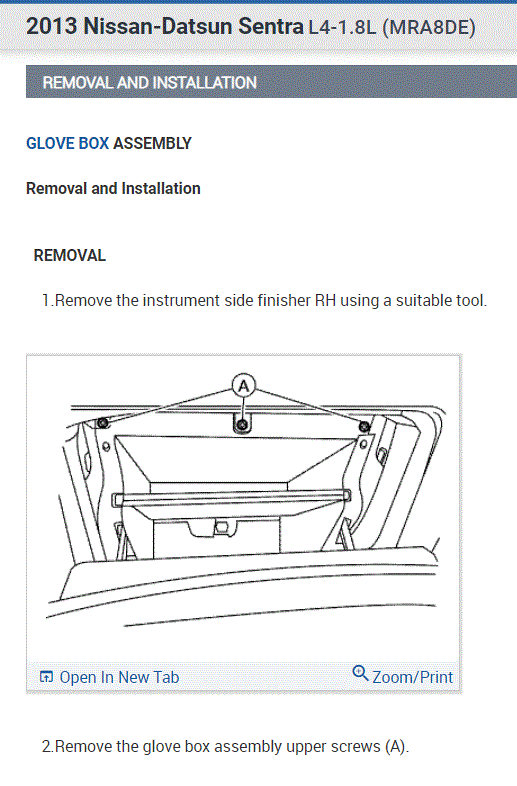

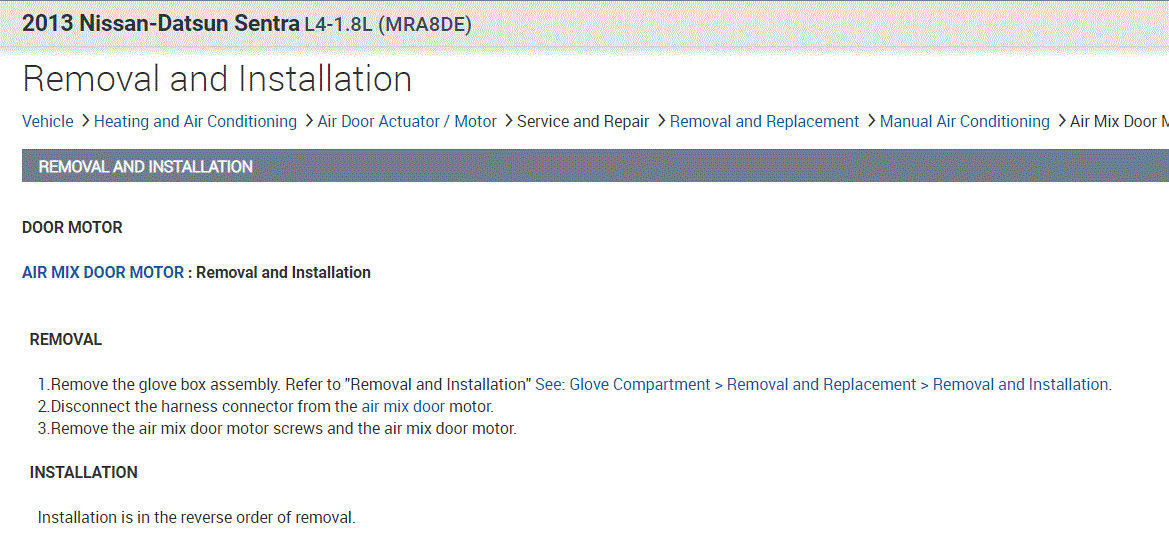

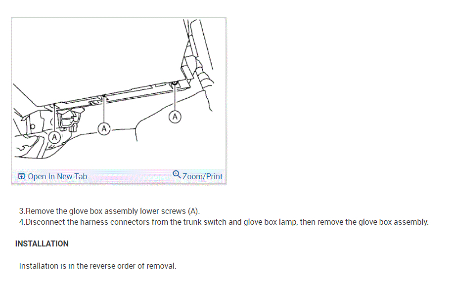

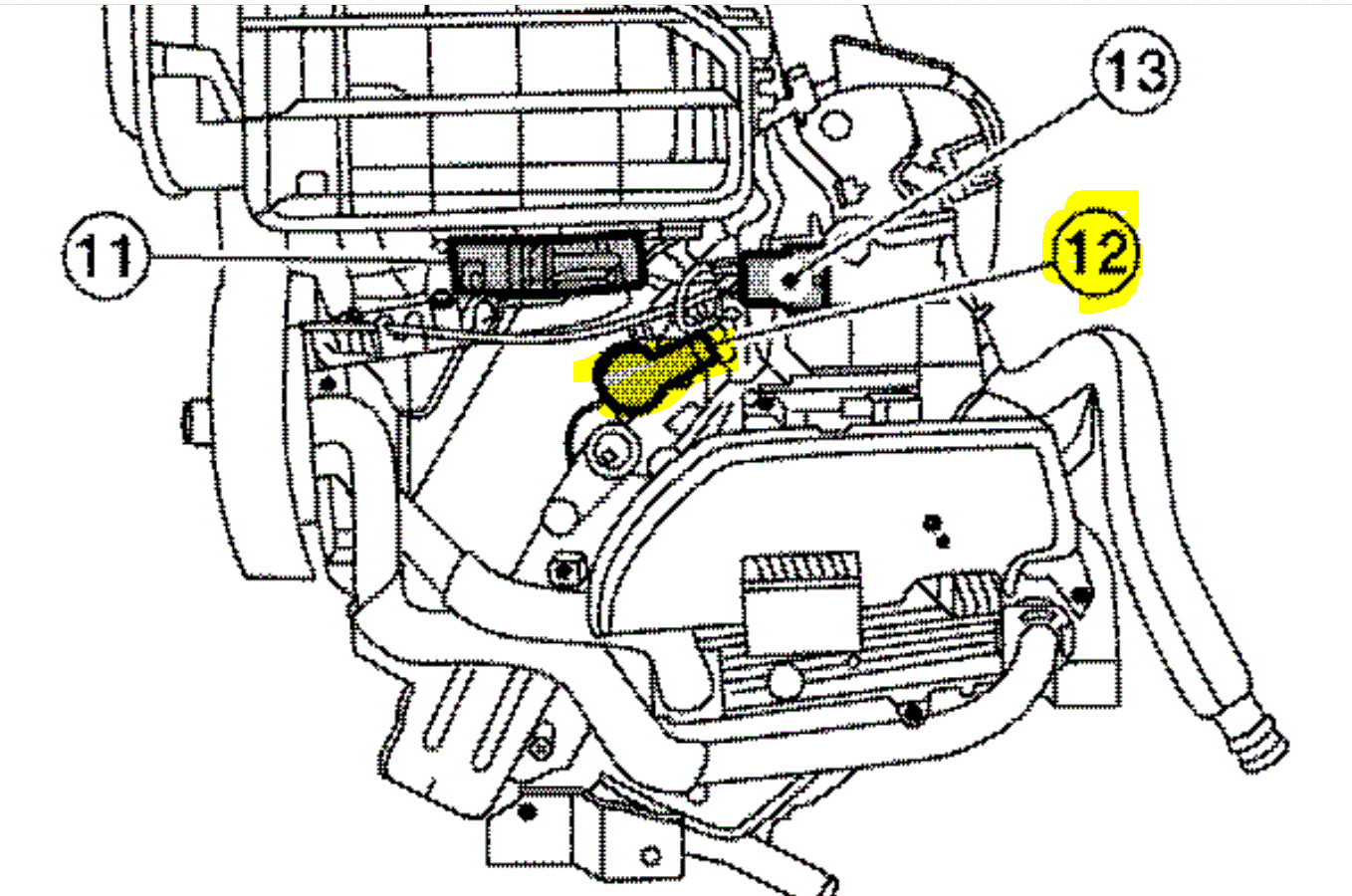

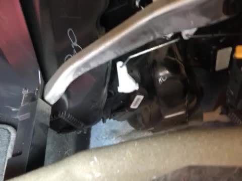

There is a chance the blend air door (air mix door) actuator is not working. This actuator is what determines the air temperature entering the vehicle.
What I would suggest is to remove it from the HVAC box and while it's still connected to power, see if it responds when you change from hot to cold on the controller.
This actuator is behind the glove box. If you look at pic 1 below, I highlighted the actuator. Pic 2 includes the directions for removal and replacement.
The last two pics show how the glove box is removed.
Note that I am basing this on a manual system. If this vehicle has dual climate control and automatic temp control, let me know.
Also, here is a link you may find helpful. It explains how to replace a blend air door in general. I'm adding it because the directions from my manual are somewhat vague.

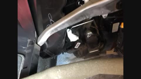

It’s moving under the dash but that only controls the area like head or feet, when I spin the dial to cold nothing happens.

But there is a noticeable difference between the air when it’s on heat and cool it’s just when it’s on cool with the A/C on, it doesn’t cool the air at all. the Freon is still showing full, when you turn the A/C on the RPMs drop about 3-400 but it’s in a position I can’t see with my own eyes the clutch engaging. The actuators moved the air from head to toe to defrost smoothly but couldn’t find anything that would control the air from hot to cold under the dash.

I found the one you referenced on the drivers side, it’s working properly.

The video was the mode door actuator. That changes the airflow direction. If the compressor is working and it is fully charged, that actuator has to be causing an issue. At this point, I would recommend removing it to confirm nothing is disconnected or damaged.
If it is working properly, there is an issue with the AC system. If you turn the on, open the hood and listen. The compressor clutch will make a click sound when it engages and disengages. See if that is happening. Also, take a look through this link you may find it helpful:
