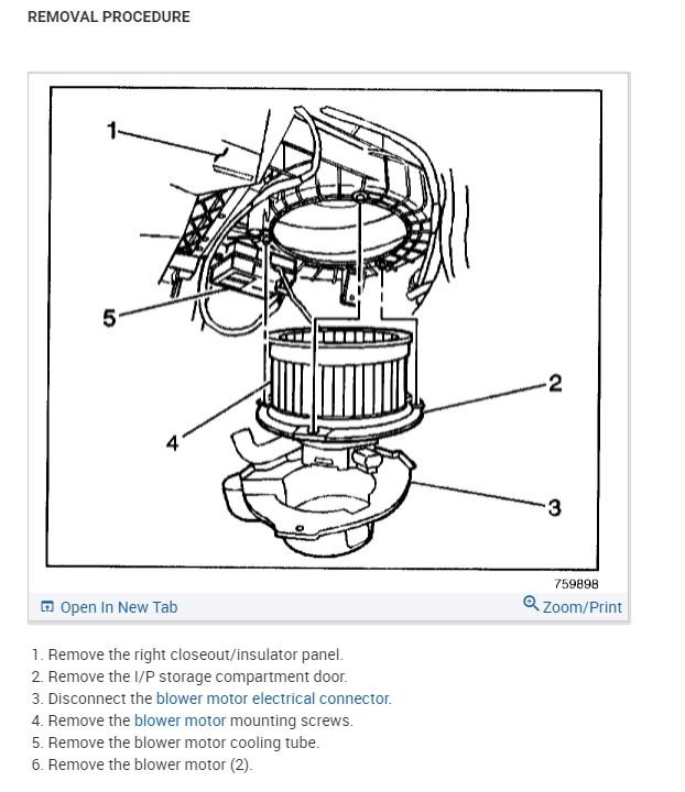

I recently had my auto's motor blower replaced (underneath and behind glove compartment). Will that/did that cause a loss of R134a (Freon)?
Mar 11, 2022 at 5:45 PM
Experienced Mechanic
52,796 POSTS

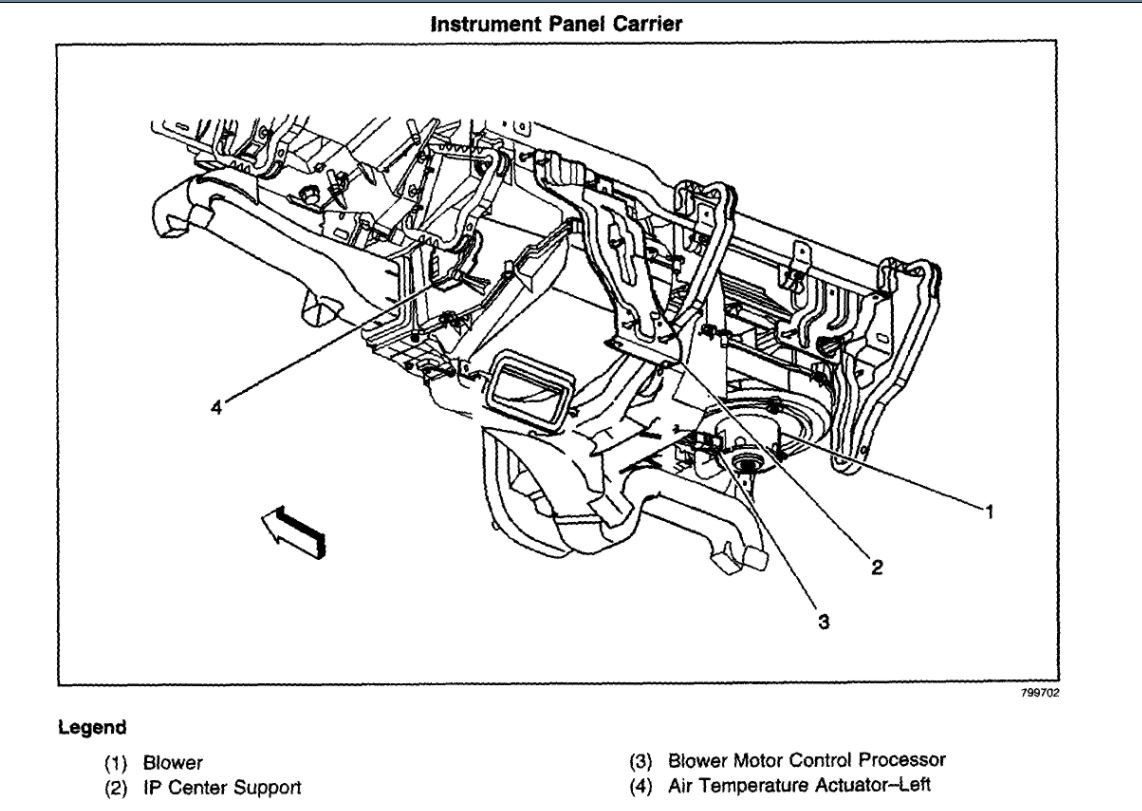

Good morning,
I attached the procedure for you for the replacement. It is located under the right side of the dash and is easily accessible.
https://www.2carpros.com/articles/blower-fan-motor-works-on-high-speed-only
As far as a loss of Freon, no. There are many other components that can cause the loss of Freon.
You will need to have a dye installed and charge the system and use a good bright LED light to find the leak.
https://www.2carpros.com/articles/air-conditioner-leak-detection
Let us know if you have any other questions.
