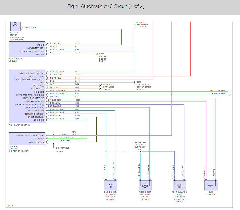

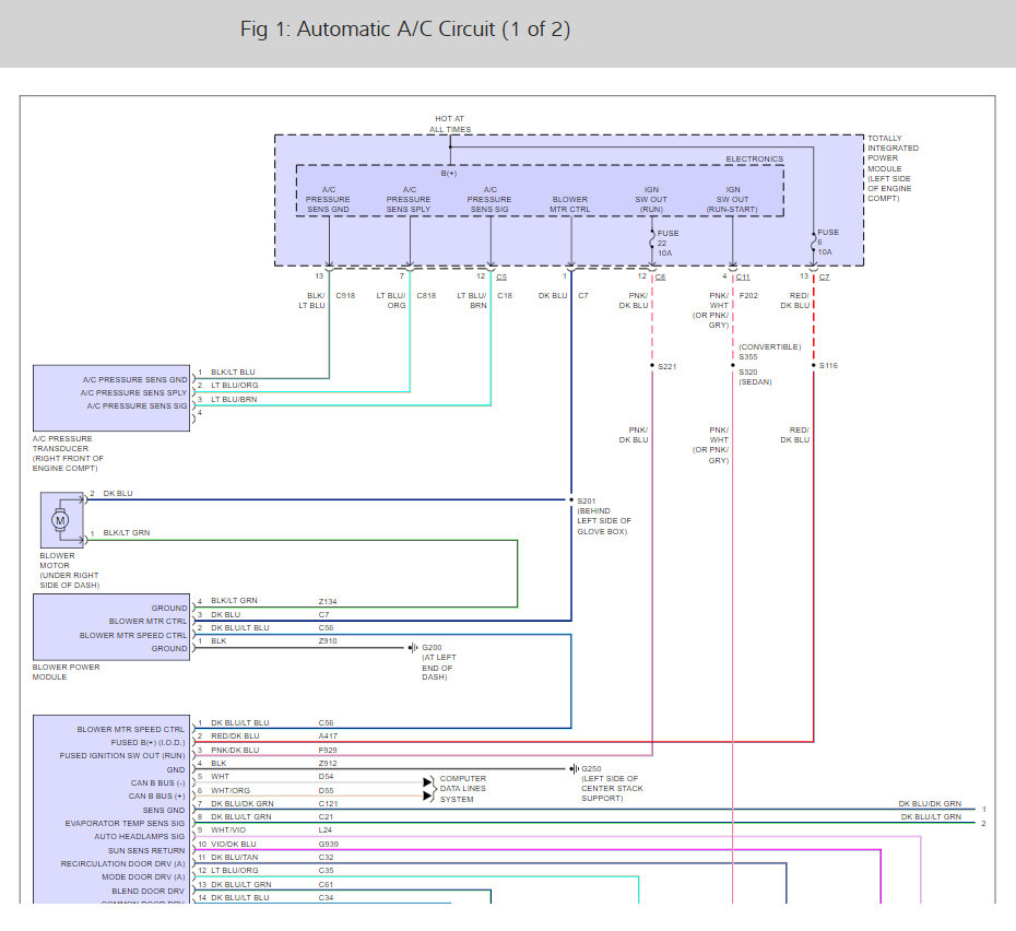

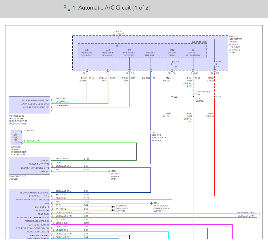

It sounds like the blower motor went out but to be sure lets run a simple test. Here is a guide to show you how to test the wiring and then replace the blower motor:
https://www.2carpros.com/articles/blower-fan-motor-works-on-high-speed-only
Here is the blower motor wiring diagrams and where the blower motor is.

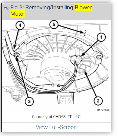

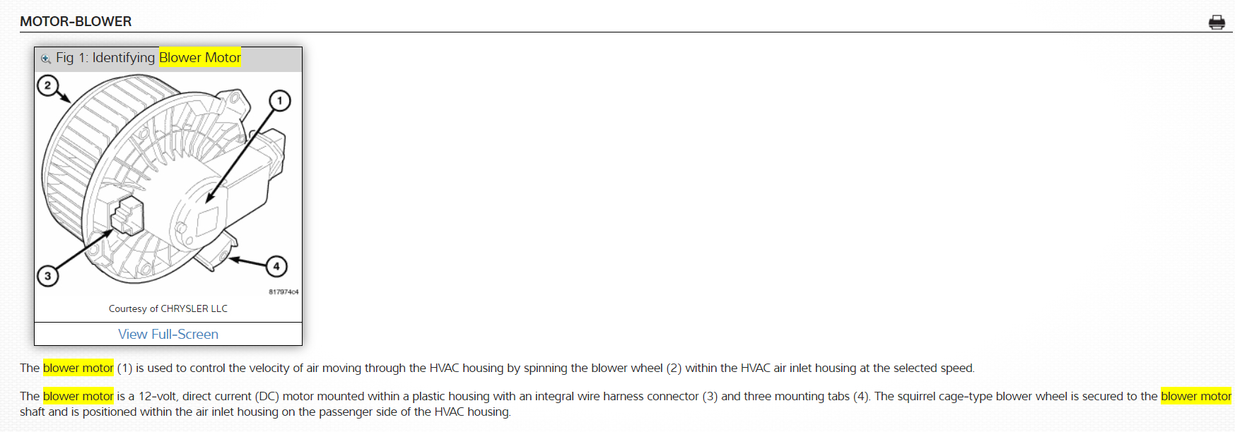

Yesterday i open the glove box and gave the blower motor a knock with my hand and it turn. each time a gave a knock the speed changes. you think there is something inside obstructing the fan?
Apr 5, 2018 at 7:45 PM
  • 55,333 POSTS
No it sounds like the fan motor is bad. Here is a link to a new one on Amazon for $47.00:
https://www.amazon.com/gp/product/B0031GT3IK/ref=as_li_qf_asin_il_tl?ie=UTF8&tag=2carprcom-20&creative=9325&linkCode=as2&creativeASIN=B0031GT3IK&linkId=9cf75b8ee85b0a516774f02d15d59f57
