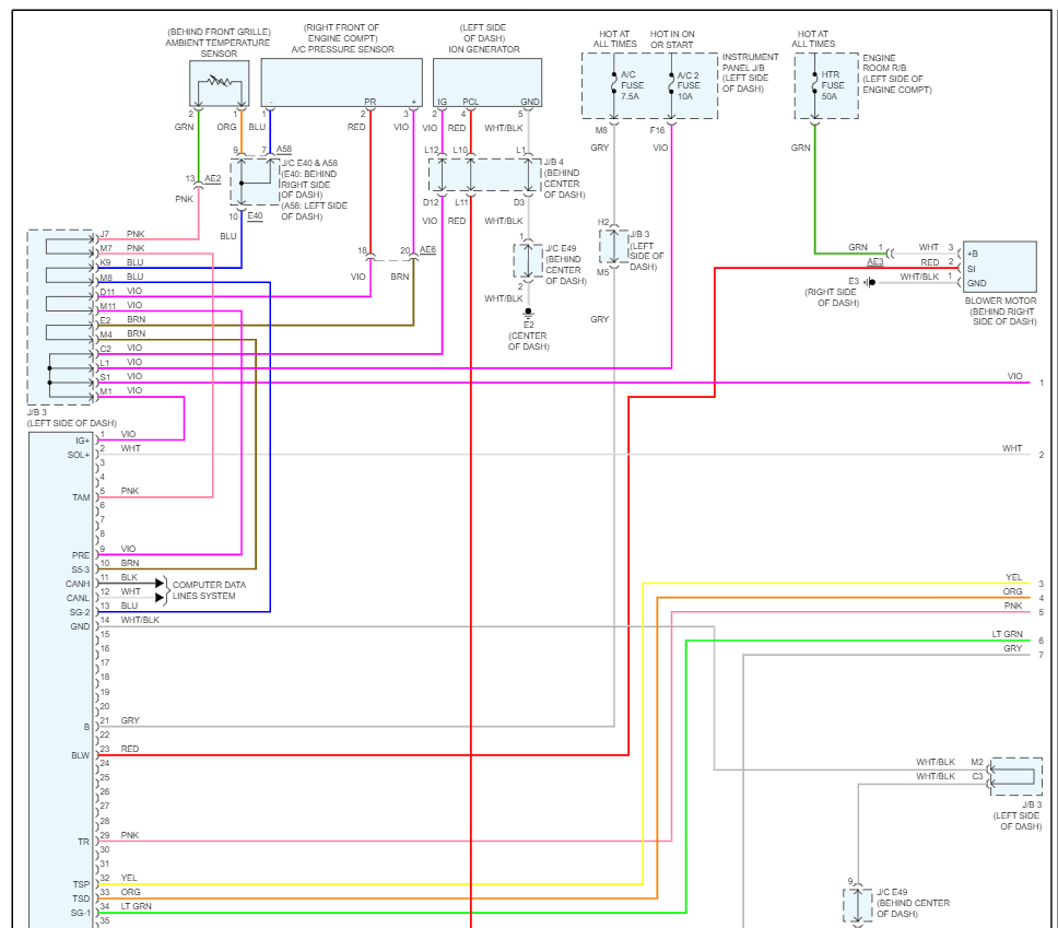

A/C blower is not working?
2011 TOYOTA CAMRY
55 MILES • 1.2L • 4 CYL • 2WD • AUTOMATIC
MAKANAKI007

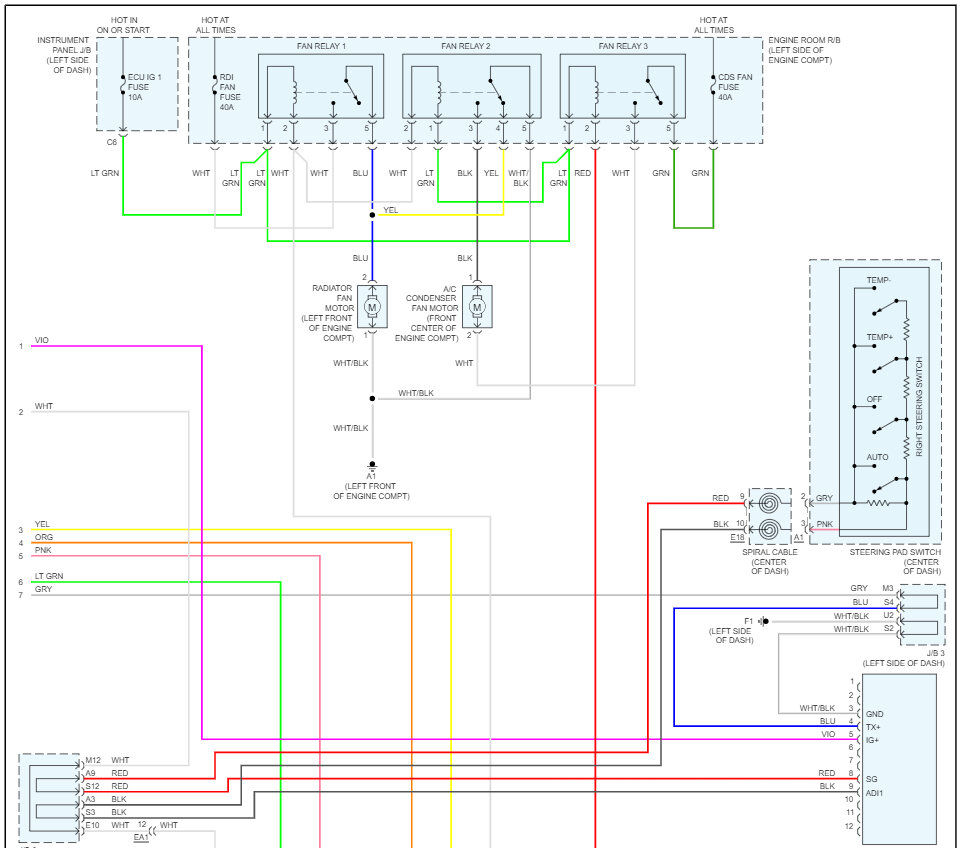

I have checked all the fuses and the power is good. I checked the positive and the negative lights in the blower is active but not working.

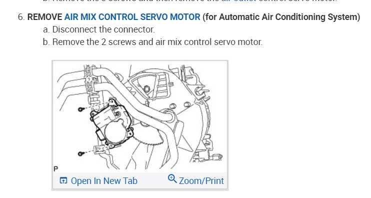

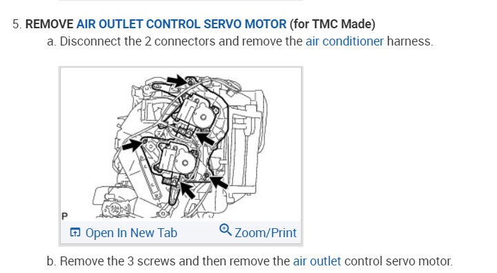

blower is active but not working. so, you can hear the blower working and there is no air coming from the vents? If so, it sounds like the mode actuator is not working.
Here is a guide to help and instructions on how to fix the problem in the images below:
https://www.2carpros.com/articles/low-or-no-air-flow-from-vents

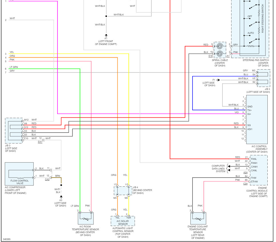

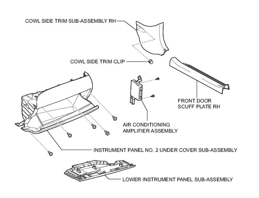

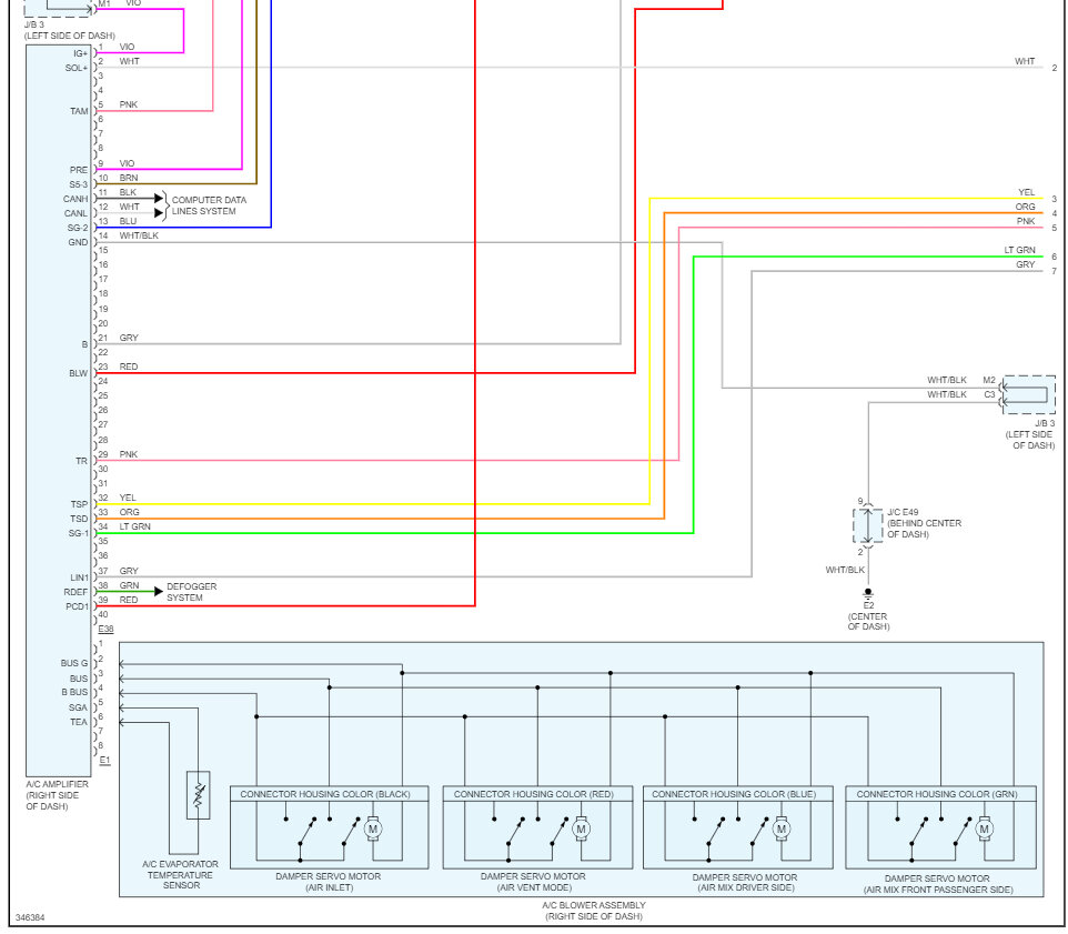

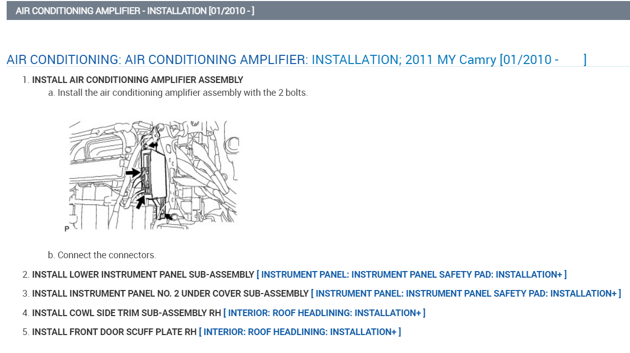

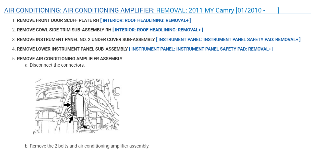

The blower is controlled by a HTR 50-amp fuse under the hood, ground and the AC amplifier. Here are the blower motor wiring diagrams so you can see how the system works.
This guide can help you check for power and ground:
https://www.2carpros.com/articles/blower-fan-motor-works-on-high-speed-only

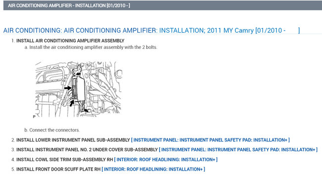

Here is how to replace the blower motor which usually goes bad and the location of the AC amplifier. Check the connections at the blower motor for heat damage as well. Check out the images (below). Please let us know how it goes.
