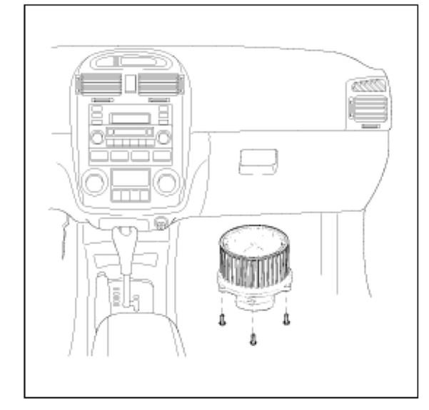

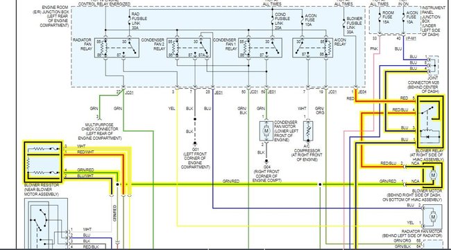

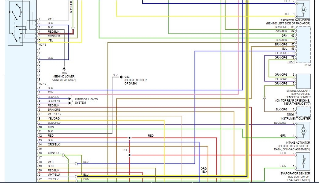

The ac comes on when it wants to at first, now it doesn't nor the defrost nothing blows.
May 26, 2020 at 8:36 PM
Experienced Mechanic
52,796 POSTS
Good morning,
This sounds like the blower motor itself or a connection since it has a mind of its own.
Do you have a test light or voltmeter to do some testing?
I attached a wiring diagram for you to view.
