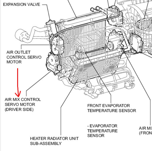

How to access the air mix control servo motor? I'm having a hard time to try and understand where its located and how to access it.

I noticed that the modes are not corresponding as well. the face, feet , defrost etc does not correlate to the selection buttons . Mode servo?
Mar 4, 2026 at 12:29 PM
  • 55,433 POSTS
Yep, mode servo, it is located right above the accelerator pedal. Use a flash light so you can get at it, also remove the lower dash panel on the drivers side.
Mar 5, 2026 at 12:44 AM
SIXTY6GTO
  • 95 POSTS
There are two control servo motors in the picture. Can you explain the purpose of each of them? Since I know I definitely have a problem with the location of the air coming out of a different vent than selected, I should try to change that first.
The one with the red arrow is the air mix control servo motor, and what does that do? Also, the other one, the air outlet control servo motor pictured above it, what does that do?
Mar 5, 2026 at 11:51 PM
  • 55,433 POSTS
Yep, so the air mix is for the temperature and the outlet is for the vent control, ie: floor, mid and defrost.
