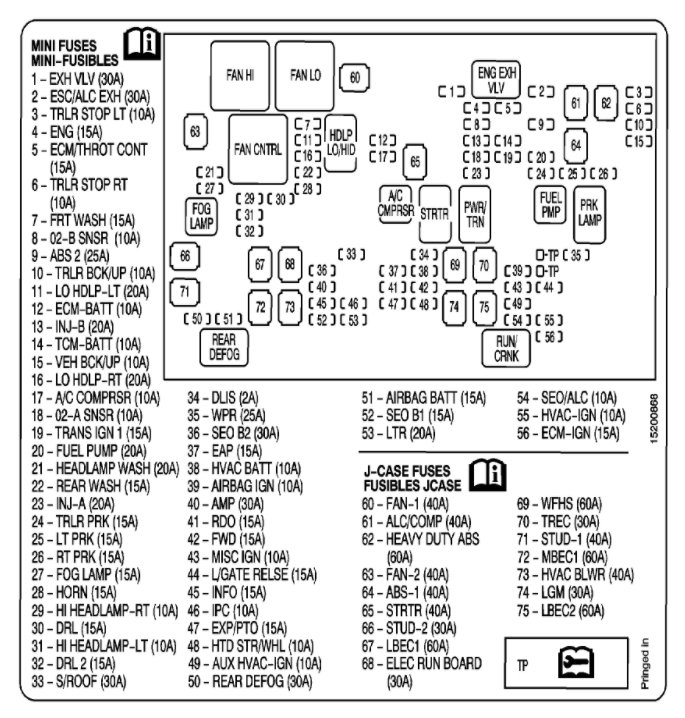

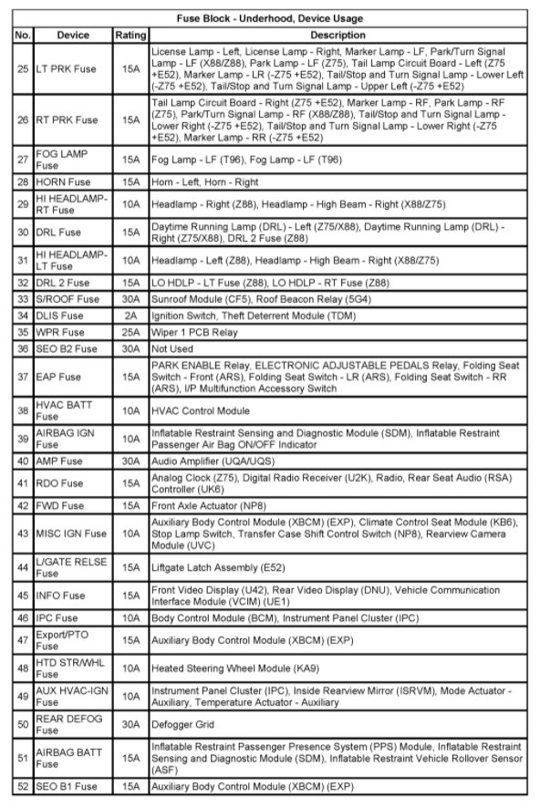

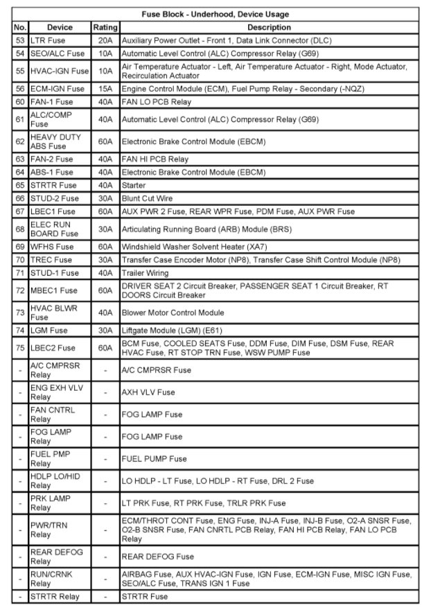

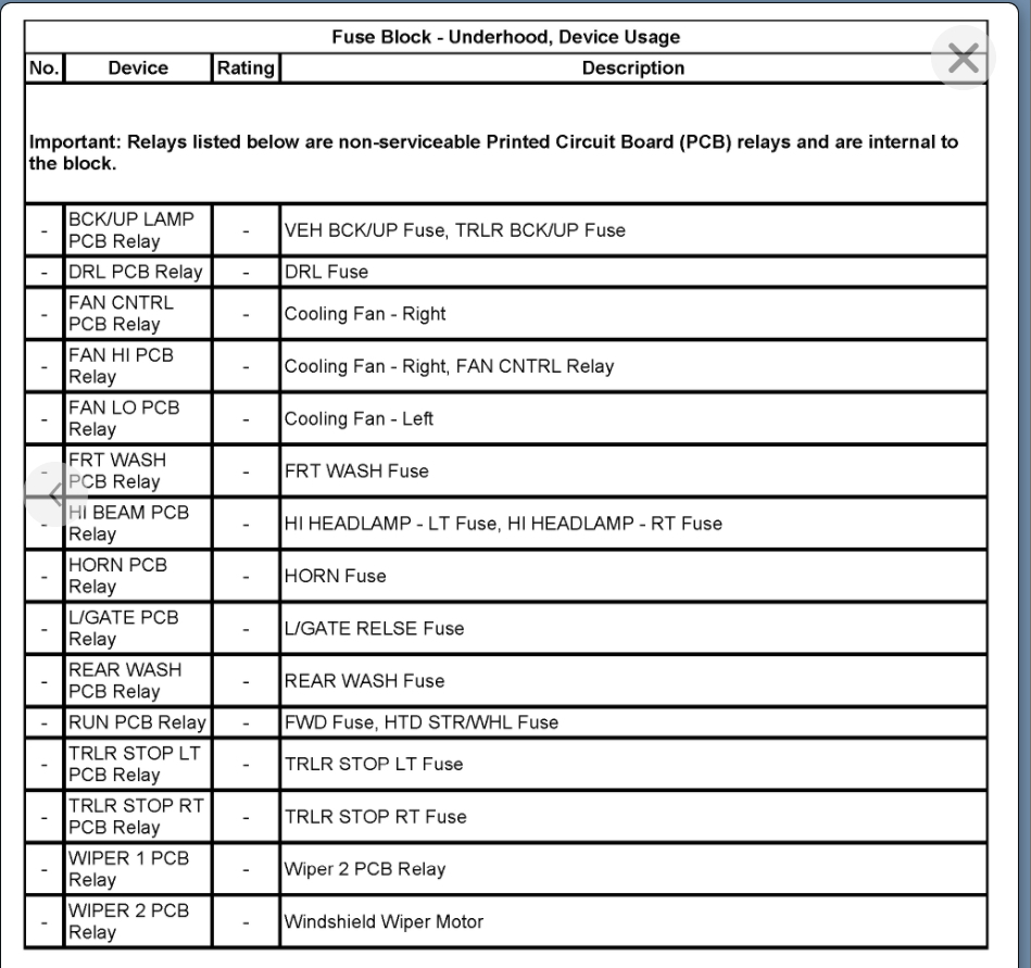

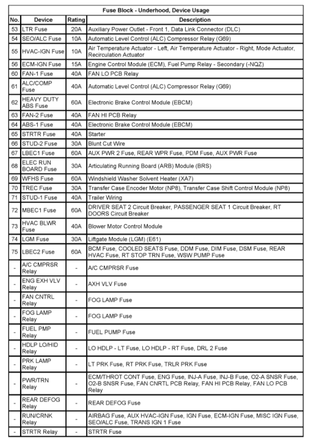

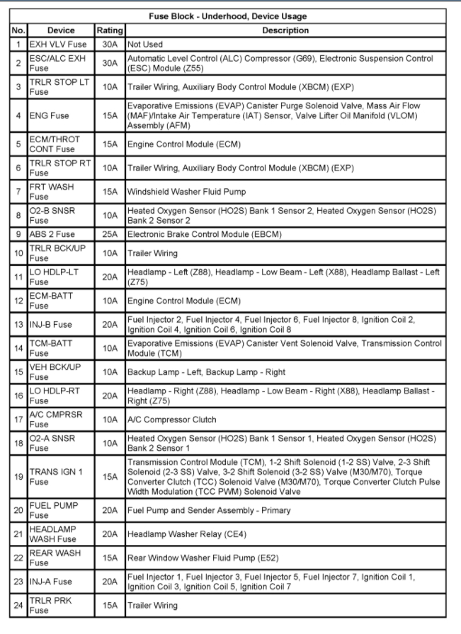

I need to know where the AC fuses and relays are. I need to test them.

Here are some guides that will give step by step instructions which will help with testing the fuses and relays:
Below are fuse diagrams that will help with the testing that you need. Please let us know what questions you have. Thanks
