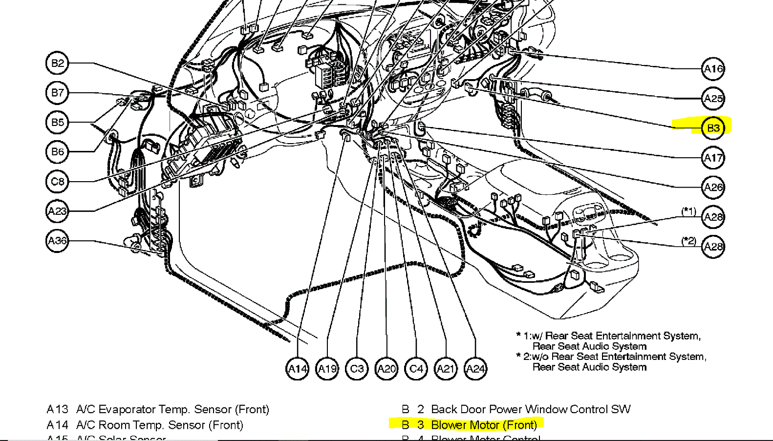

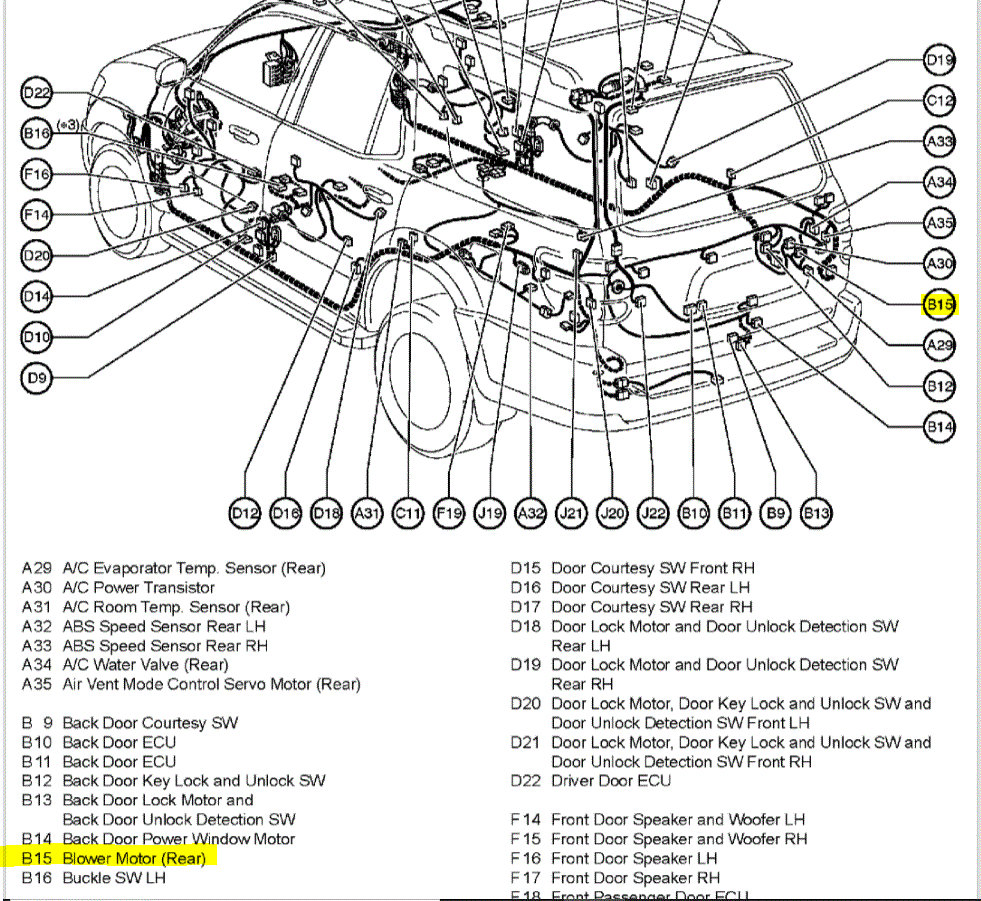

I need to confirm something. First, do you mean the blower motor isn't working on the front? Does the A/C cool the air coming from the rear vents?
There are two different blower motors on this vehicle. One is front and one is rear. See the attached two pics. Which one has been replaced?
Next, if the light is flashing, there is a fault in the system at some point. What may need to be done is to have the computer scanned to identify diagnostic trouble codes related to the HVAC system. This will point us in the right directions.
Let me know the answers to my questions so I have a better understanding of exactly what is happening and what was replaced.
Take care, and I'll watch for your reply.

I just replaced the blower and blower fuse. The rear blows air but not cold and the front barely blows at all.

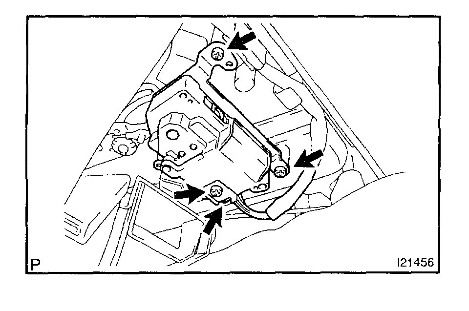

If the clutch is cycling on and off, then it should be producing cold air unless the air temperature door actuator isn't allowing the cold air to enter.
Do me a favor. Record the sound of the blower motor so I can hear it. Also, I'm attaching diagnostics for checking the air mix actuator. Make sure it is working.
2004 Toyota Truck Sequoia 2WD V8-4.7L (2UZ-FE)
Air Mix Servomotor
Vehicle Heating and Air Conditioning Air Door Actuator / Motor Testing and Inspection Component Tests and General Diagnostics Air Mix Servomotor
AIR MIX SERVOMOTOR
AIR MIX SERVOMOTOR
INSPECTION
see pic 1
1. REMOVE AIR MIX SERVOMOTOR
a. Disconnect the connector.
b. Remove the 3 screws and servomotor.
2. INSPECT AIR MIX DAMPER POSITION SERVOMOTOR
Refer to Heating and Air Conditioning; Testing and Inspection.
3. INSPECT AIR MIX SERVOMOTOR CIRCUIT
4. INSTALL AIR MIX SERVOMOTOR
