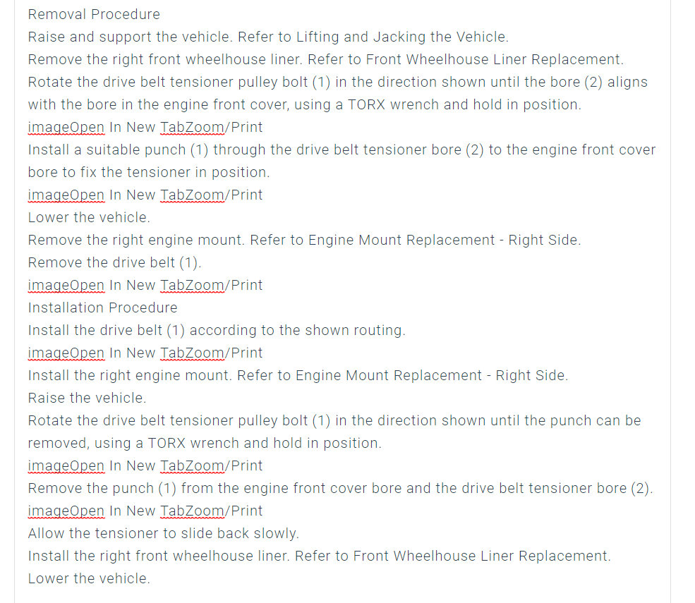

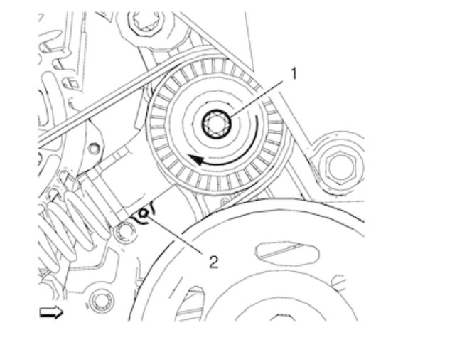

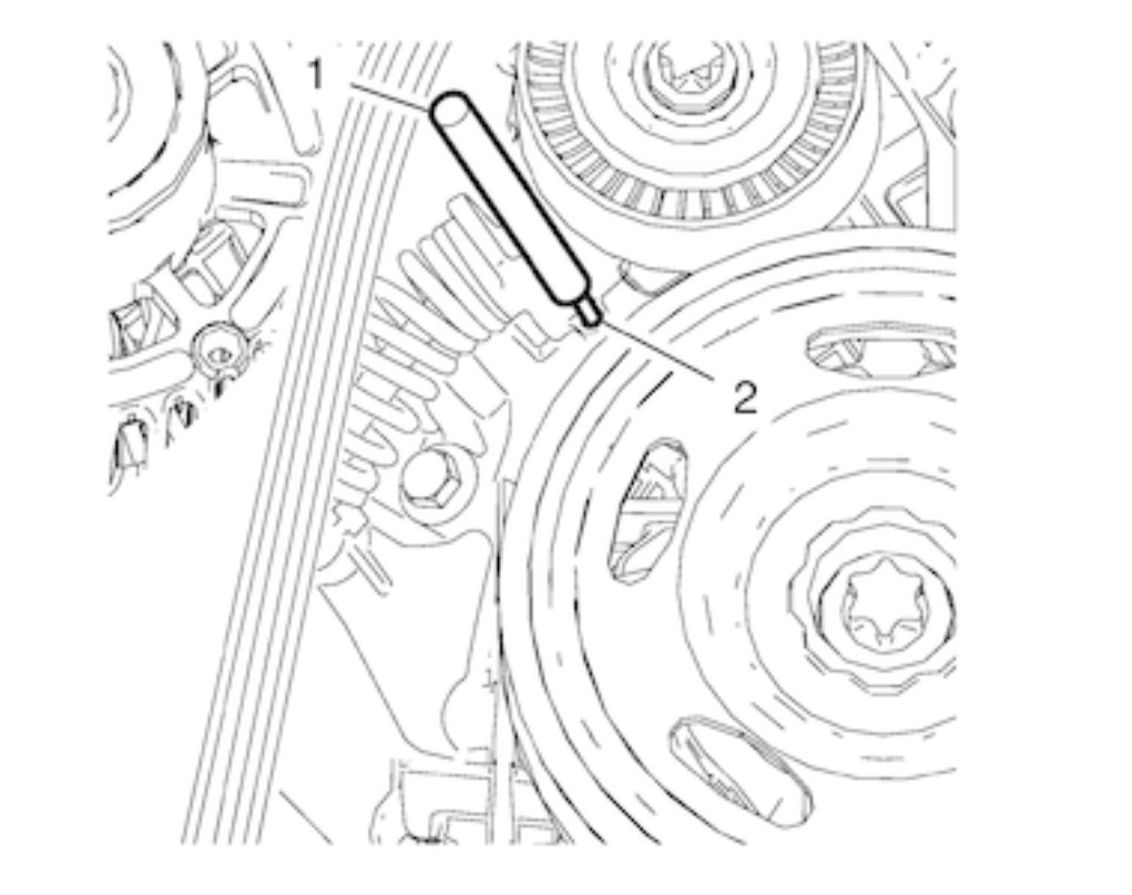

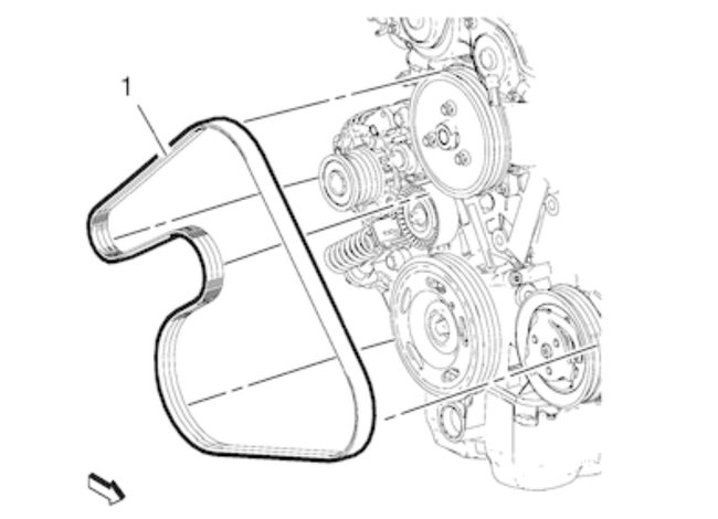

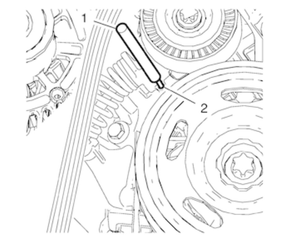

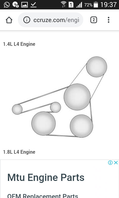

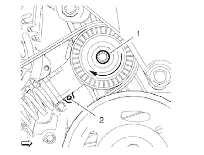

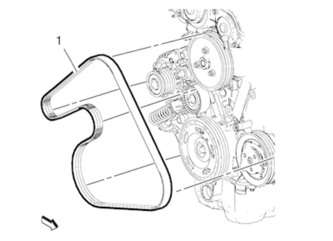

Hi, I want to replace the 2 belts (A/C and power steering) on the car listed above ecotec, but for the power steering belt can see any adjuster that i can slack. i read an article online that you have to cut off that particular belt!!! Is that correct? Any advice thanks...
Mar 13, 2021 at 1:11 PM
Good afternoon,
I attached the procedure for you below for the drive belt replacement.
https://www.2carpros.com/articles/serpentine-belt-timing-belt-timing-chain-diagrams
