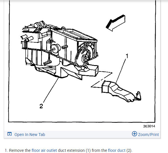

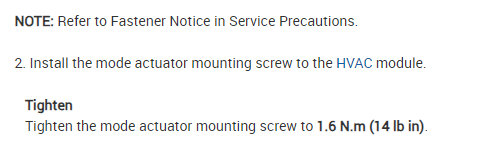

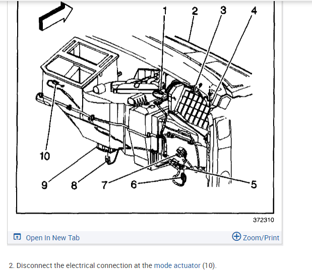

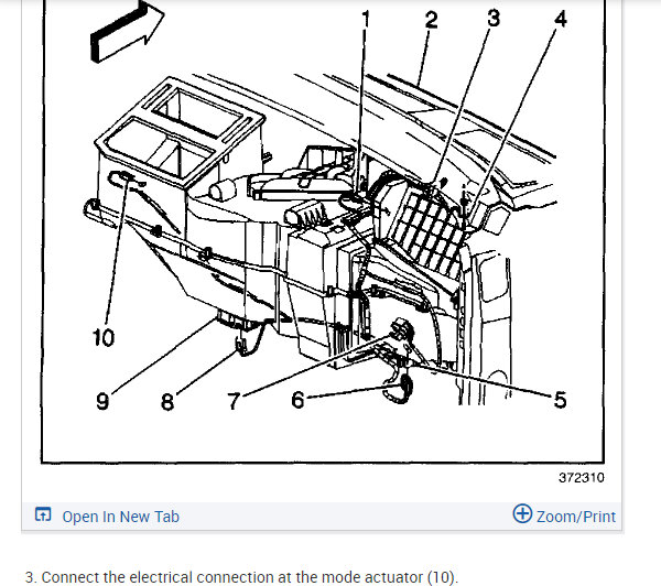

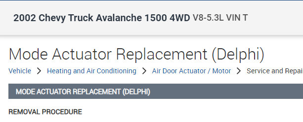

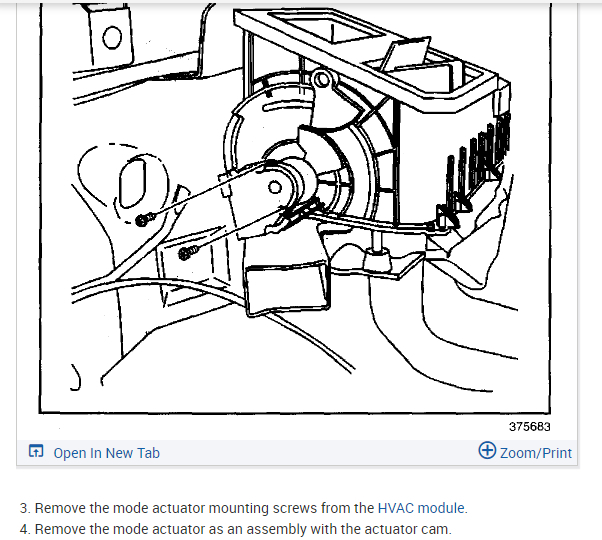

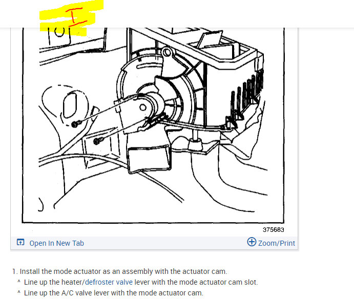

The mode door actuator is responsible for the air flow direction. Chances are it has failed or is failing.
First, take a look through this link to see if anything is helpful:
https://www.2carpros.com/articles/air-vents-stay-in-the-defrost-position

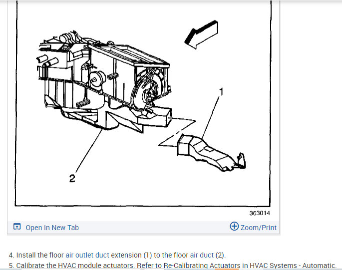

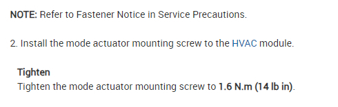

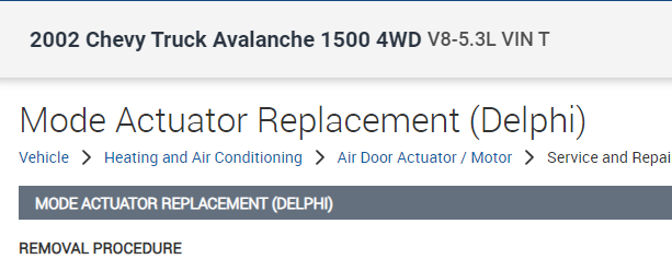

Next, I have attached pictures below showing the actuator location and the directions for replacement. Note that this if for a manual climate control system. If you have automatic climate control, let me know.

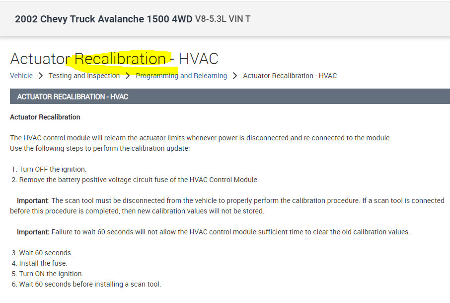

Also, I placed the letter I in one pic and highlighted it. That is the start of the installation process. The very last picture provides the recalibration procedures.
See pics below. Note: The arrow in the picture's points toward the front of the vehicle.
