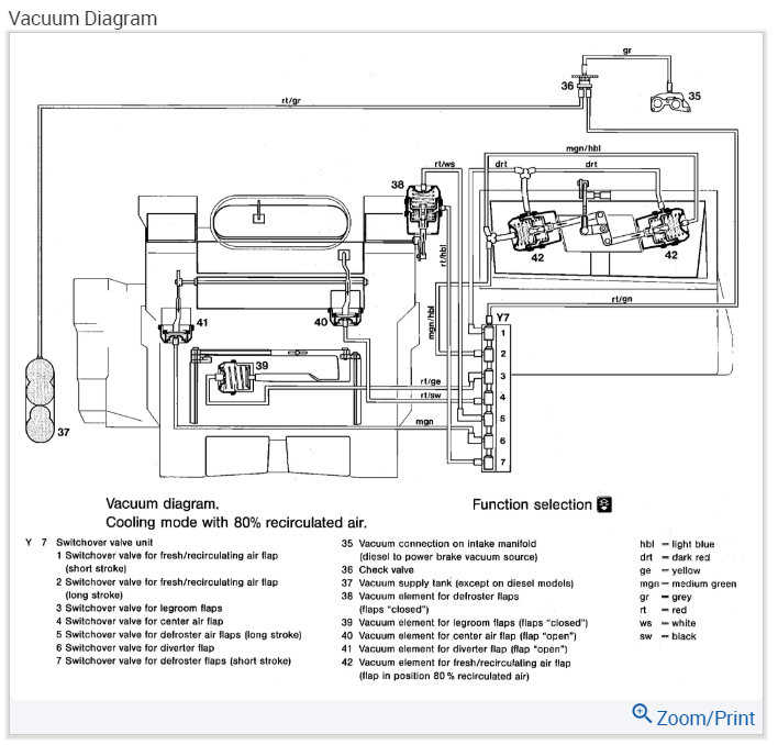

I have no heat or A/C. I have replaced the mono valve, condenser, compressor and climate control, and nothing has changed. What else could be wrong?

I have no heat or cold air. The fan works and is passing air through the vents, but the air will not change temperature.

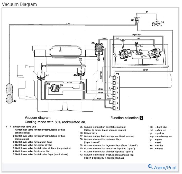

This system is vacuum operated. Here are the diagrams to show you how it works it sounds like you have a leak which is not holding vacuum and not moving the doors. Also, check under the hood to make sure the vacuum feed line is intact.
Check out the diagrams (below). Please let us know what you find.
