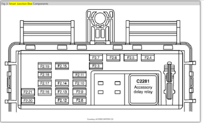

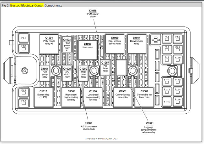

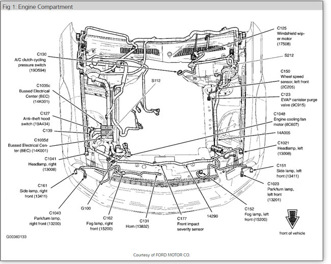

Hello, I have a 2005 Ford Mustang. My Air Conditioning stopped working, and I think it may be a blown fuse or relay. Do you have a fuse diagram for this vehicle? I checked both fuse boxes, and both say to see owners manual, which I do not have (Bought the car used).

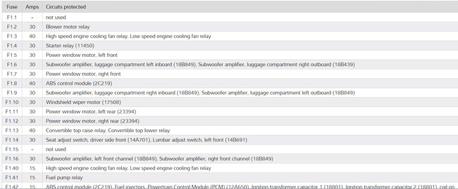

Here is a guide a the fuse panel diagrams which show the fuse and relay that runs the blower motor.

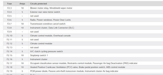

also for blower check relay in smart junction box rh kick panel f1.2 and fuse 2.3 they should be marked inside cover

Thanks for the info. The fuses were not marked and I don't have a manual so I just checked each fuse with a tester and found a blown fuse for the blower motor. Walla!!! Its now working.
