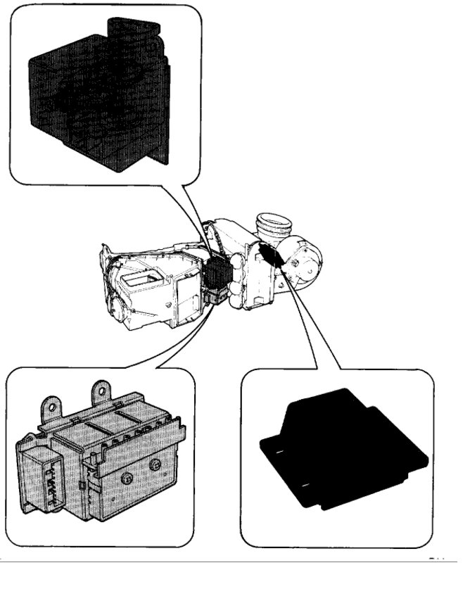

A/C cools fine.
When placed in "vent" position cold air comes out from heater position, not the dash vent. Is this the "blend door actuator" not working properly, and if so where is the "blend door actuator" located?
Thank you,
Eugene Whitley
Sep 8, 2017 at 2:33 AM
  • 55,423 POSTS
yes this sounds like a blend door actuator problem. Here is a guide and some diagrams (below) to help you get the part changed out.
Please let us know what happens and upload pictures of the problem.
