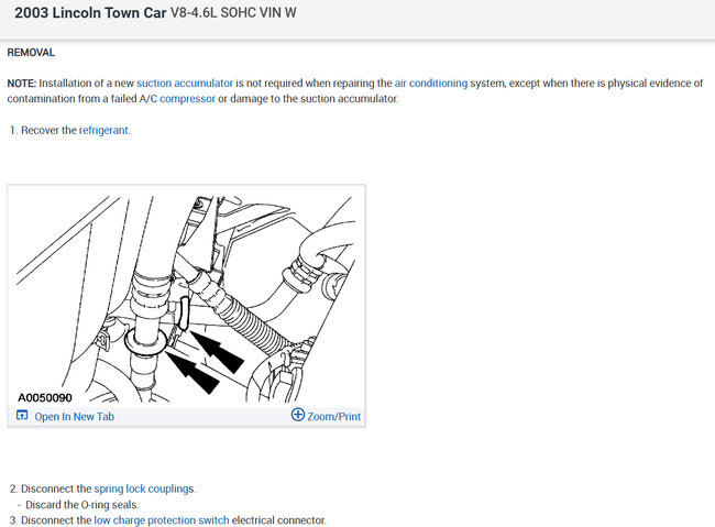

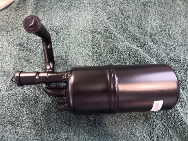

I purchased a replacement Accumulator (#218630)
How do I swap it out?
Thank you

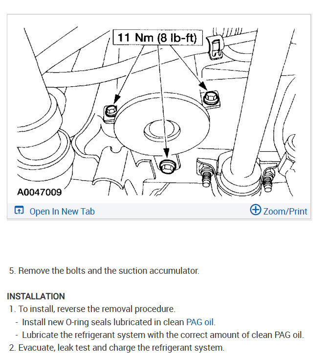

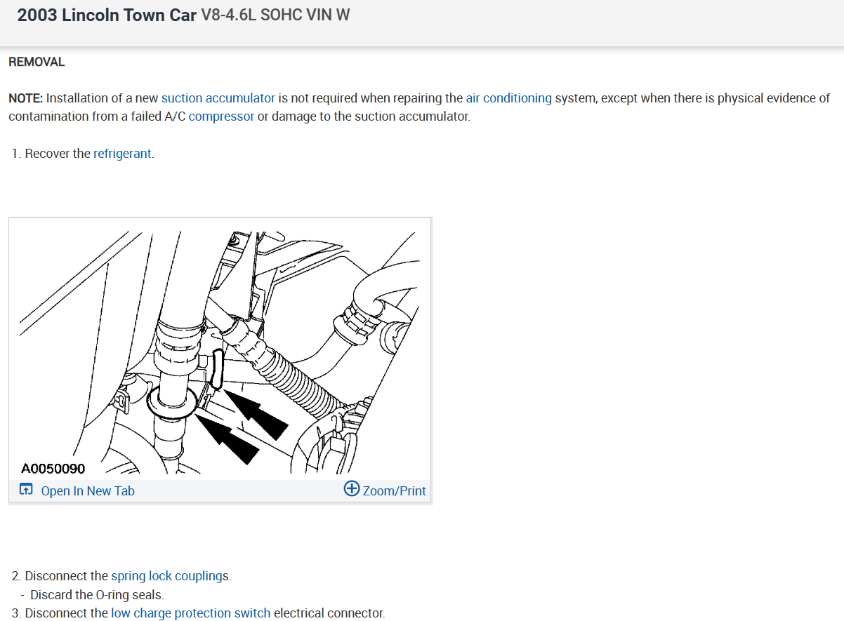

Good job doing this too, the accumulator is the filter/dryer of the system. Do you have the special release tools to change this part out? If not here is a great deal from amazon to get the tool kit for $24.00:
https://amzn.to/4jJyT86
Of course, you will need to vacuum down and recharge the system. Please watch this video:
https://www.youtube.com/watch?v=4EqdrBVb0sY
Make sure you use PAG oil on the O rings to help with the reassembly. Check out the images (below). Let us know if you need anything else.
