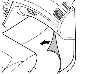

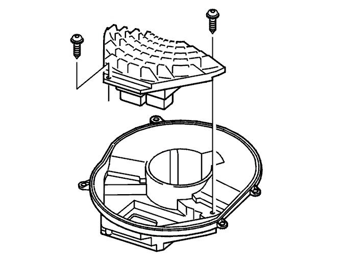

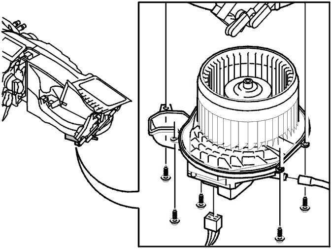

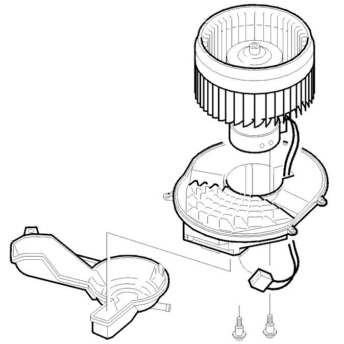

For starters the fan blows air when it wants to. When it does blow air, only the passenger side blows out cold. The driver side blows depending on the climate outside. But the fan seems to only work when it’s cool outside, not in hot weather. I am talking about the blower fan for the air conditioning not the radiator fan. I can hear the refrigerant moving through the lines. There is no Volvo dealership in my city in Texas unfortunately. Any tips where I can start fixing this problem?

For starters the blower motor transistor would need to be replaced to address the fan coming on when it feels like. Will post instructions and images below. As for one side cold and one side warm, you would need an advance scan tool to communicate with the climate control module and do a simple calibration of the damper motors to start with. Here are the instructions for the transistor.

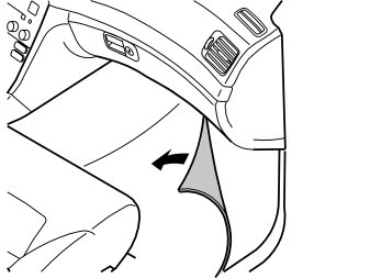

- detach the drain hoses from the engine and the filter housing. Move the drain hoses to one side
- detach the floor carpet at the front. Fold the carpet back.
Engine
Remove:
- disconnect the connector
- the 5 screws for the blower fan motor
- detach and remove the blower fan motor.
Engine
Remove:
- the connector
- detach the cover from the motor
- the 2 screws on top
- press and pull out the motor and fan hub. Use a screwdriver for example.
Installation
Install in reverse order.
Power unit
Removal
Remove:
- the blower fan motor with the fan hub as above, see Fan motor
Remove:
- the power unit, 2 screws.
Installation
