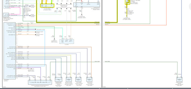

In order for my car to cool i have to put climate in the middle it blows cold i put it on high it blows cold but it feels like the inside of the car is not cooling. My fans runs low but when i put climate on high the fans run high but cuts off and goes back to turning slow and continue the same thing.When i unplug the temperature sensor my fans runs high and doesn't cut off and my A/C blows good and cold on all climate levels and my etc light comes on. I plug temperature sensor back in it goes back to doing what it was doing before.. If any one could help me it would be greatly appreciate it..
Aug 8, 2019 at 3:34 PM

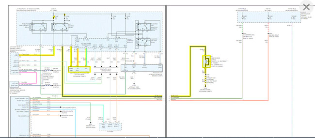

I attached a wiring diagram of the system for you to view.
I circled the fuses that control the compressor operation.
Do you have a voltmeter to do some testing?
