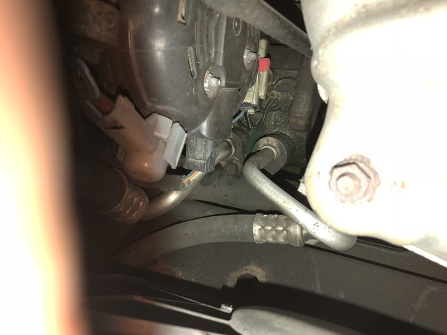

Leak in low side hose in front of A/C unit. O-ring?

I need to see some pictures to determine if the hose is leaking or the o-ring.
Can you post some pictures?

Looked like leaking from connection.

Correct. Recover the Freon and vacuum down and remove the connection. It may take o-rings or a flat seal. Make sure the area is clean of all debris before installing it.
