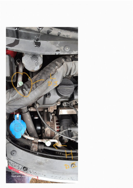

Is this the low pressure service port for topping up the A/C refrigerant gas on the vehicle listed above? see picture.

I think the picture uploaded this time?
The caps are more greenish than blue, they are marked up, the larger diameter pipe has a large 'L' with 'DI' below and the smaller diameter pipe has large 'H' with 'DI' below. So I'm guessing that indicates Low and High pressure.

Yes, the larger diameter line "L" is the low side port you will use to add refrigerant. Here is a tutorial show how to recharge your A/C system:
