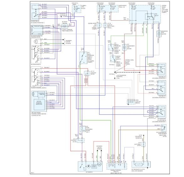

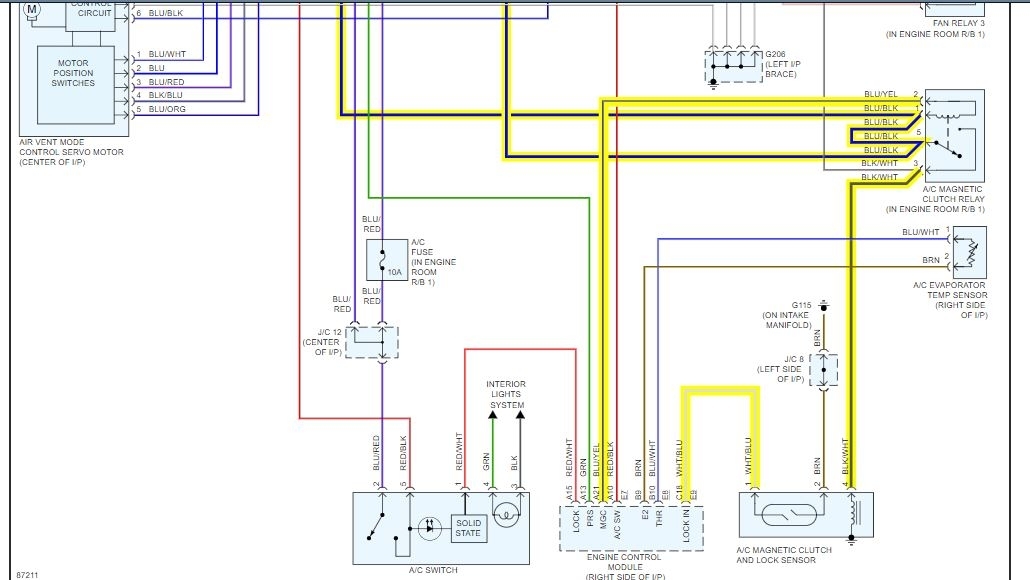

After starting my car and letting it warm up I can turn on my A/C and it'll blow cold and just fine. sometimes i can make a whole trip and and it blows cold. Sometimes it'll blow cold then cool an the light on my A/C button would start blinking. I changed my A/C fan because the motor went out. but it is still doing the same thing.

Okay, at this point, it does not work at all?
I would like to see the high and low pressures to see what the Freon is doing.

Yes, it works but sometimes it stop blowing cold and the light on the A/C button start blinking and the A/C start blowing cool. The A/C fan has been replace and the Freon has been checked.
Sep 20, 2019 at 3:51 AM
Okay, the blinking light tells me the A/C is not working.
That is why I need the high and low side pressure.You can rent a set of gauges at a parts store.
