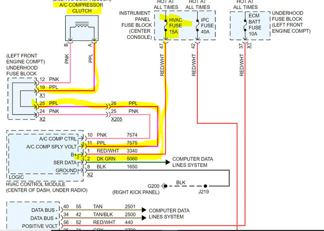

I don't know if it has a short or if it's a fuse..

Did this happen all at once? Does anything work with the HVAC system?

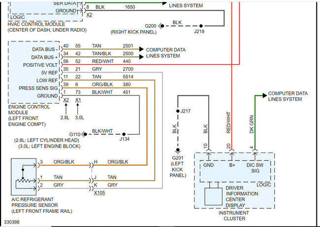

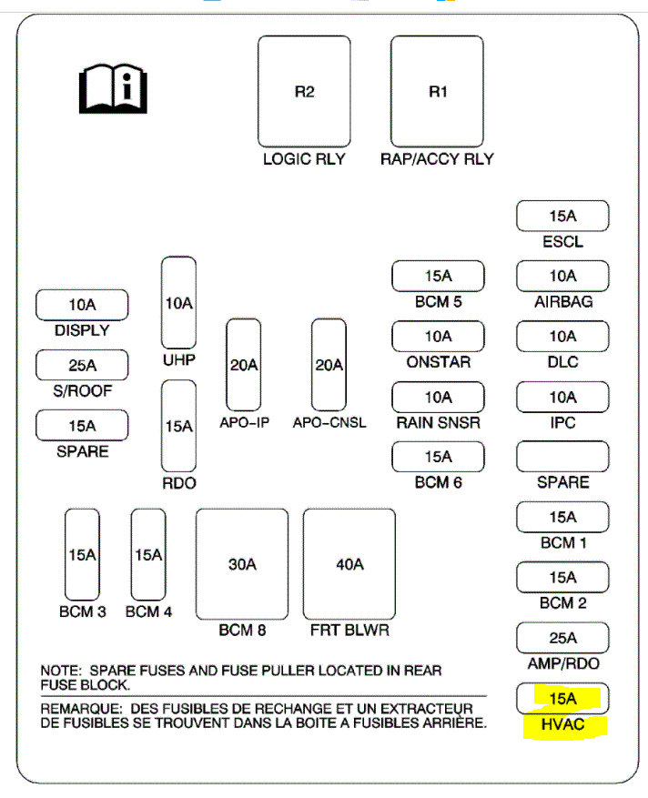

I attached the wiring schematic below. I highlighted a fuse to check to get started. Here is a link you may find helpful:
Let me know what you find. Also, let me know if the A/C was working properly prior to this happening.
See pics below Note: I had to cut the wiring schematic in half to make it readable. I did overlap them so you can follow from one to the next.

Yes, my A/C was working... My husband went to turn on the A/C last month and that's when he noticed that it wasn't working. Then I drove out to a friends house and she got it to work for a little bit. Then it would stop for a little bit then it would would start working for a little bit and now not at all.

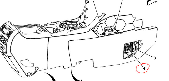

Is the fuse box under the hook and where?
Jun 8, 2021 at 6:03 AM
  • 110,244 POSTS
It's in the vehicle's center console. If you look at pic 1 below, I circled the number 4 which is pointing at the fuse box. Pic 2 shows the fuse you are looking for.
