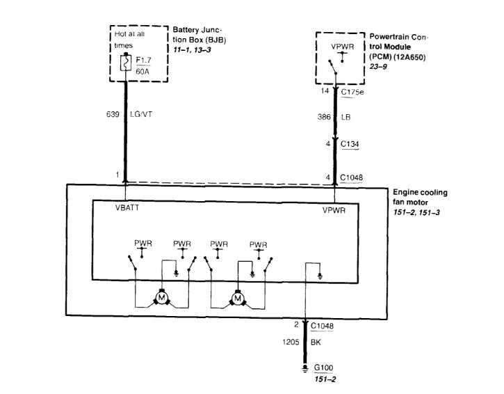

Replaced A/C compressor, evaporator, and expansion valve.
When the system is running and gets hot, it is trying to shut down and no cool air comes out. There is no blockage, compressor is fine, Freon is on point. I was told that something electrical is getting hot and is not letting A/C run right.
Please help

Is the cooling fan working in front of the radiator with the AC on?
What are the high and low side pressures while the AC is on? Want to be sure the pressures are correct.
Is the cooling system working correctly in the van? No overheating?
