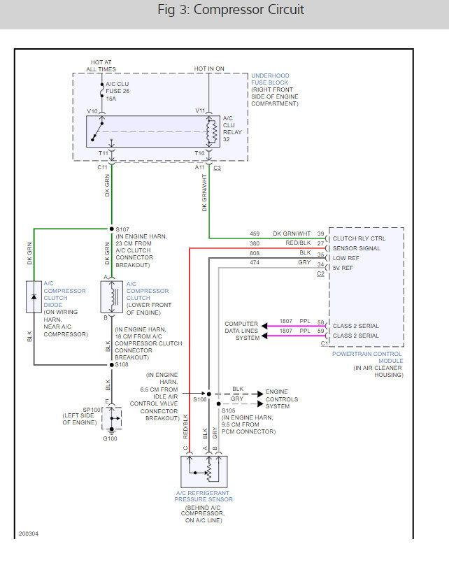

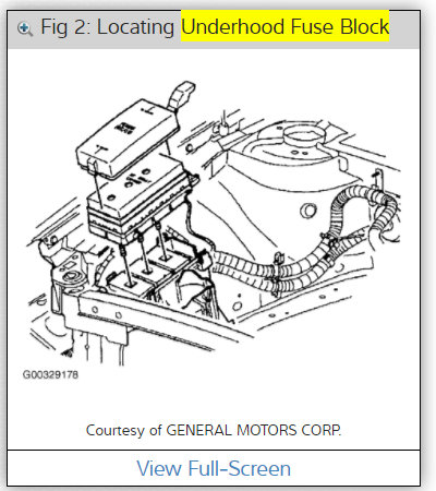

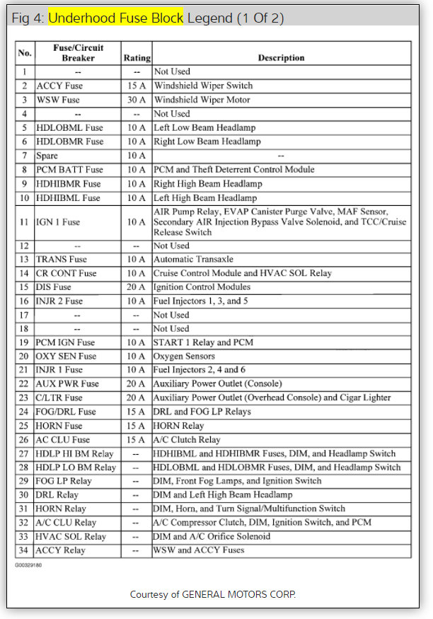

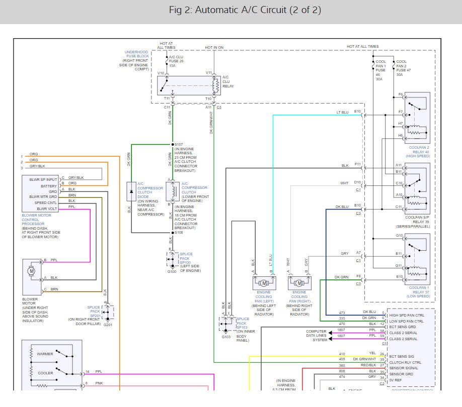

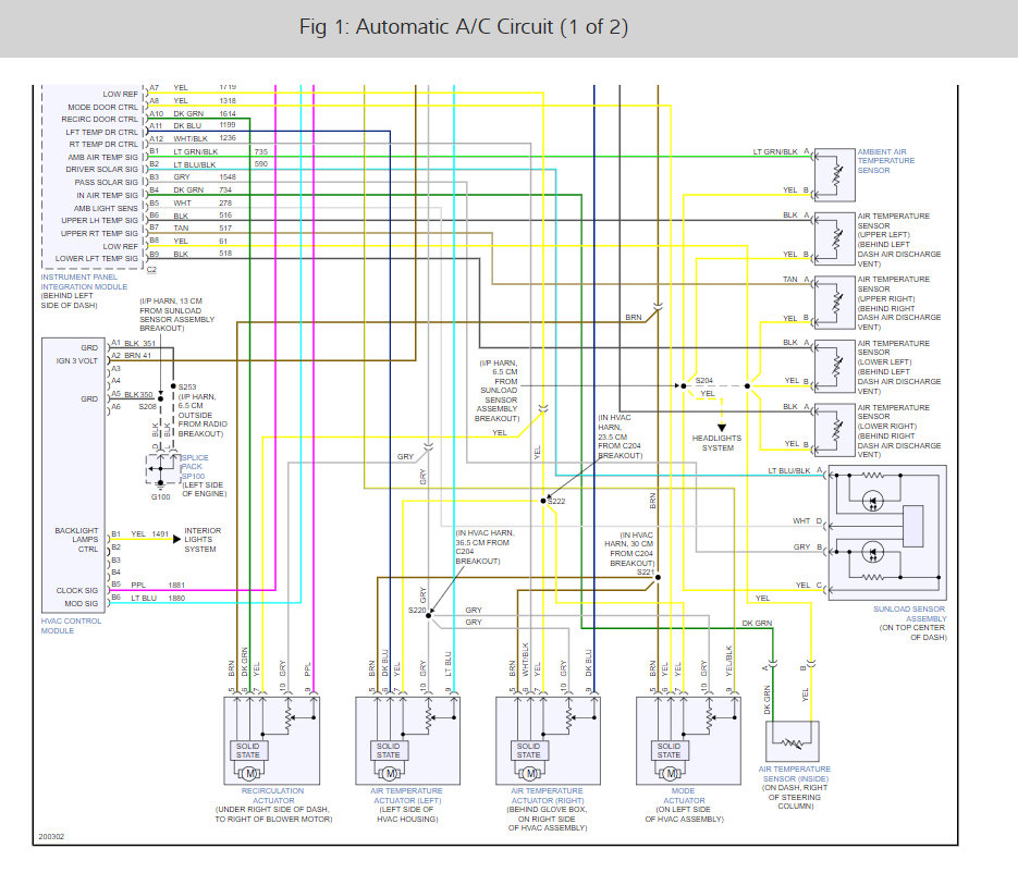

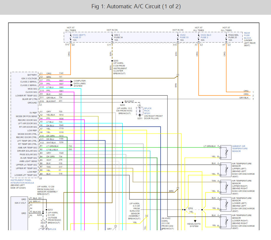

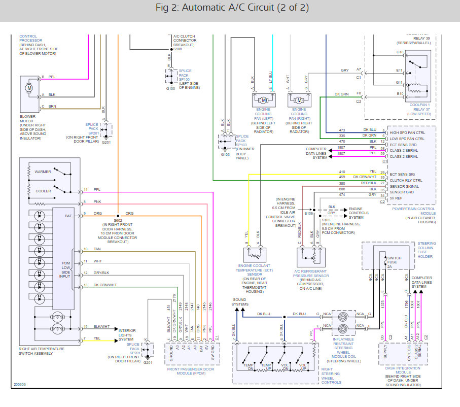

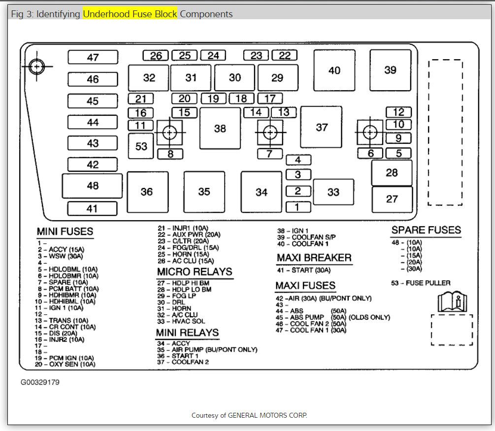

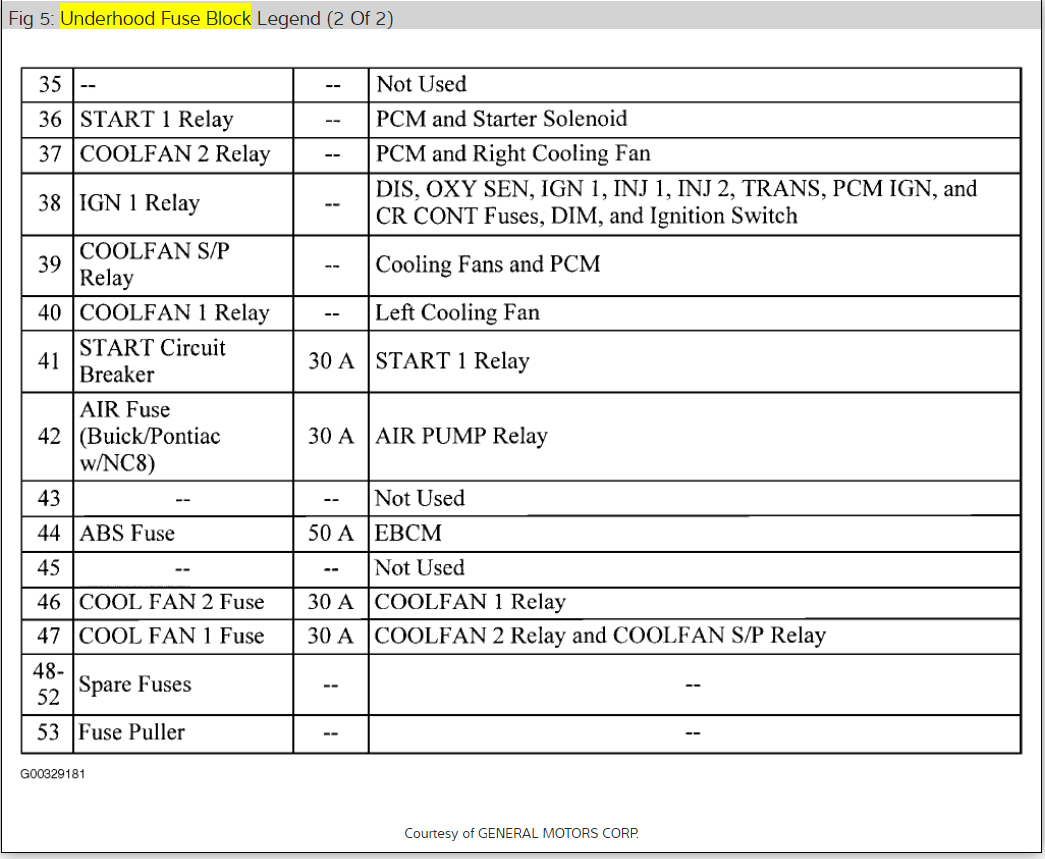

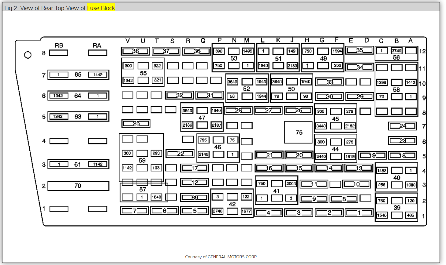

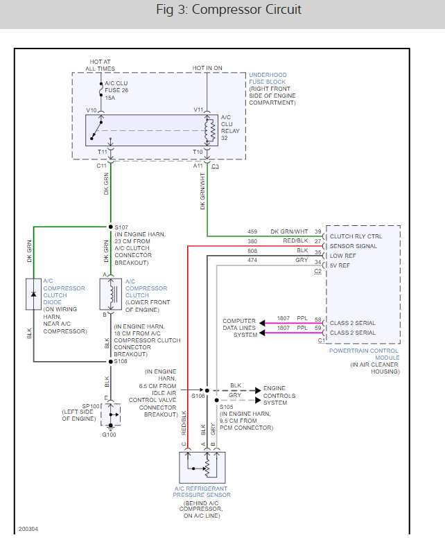

A/C clutch engages but gauges do not show a change of pressure when clutch engages. No cooling at all can you help me fix it?
May 6, 2018 at 10:24 AM
Good morning.
This sounds like the compressor has gone out or the system is low on charge or a fuse is bad, these videos and guides can help us fix the problem with diagrams below to show you how on your car. I have included the AC wiring diagrams as well so you can see how the system works.
