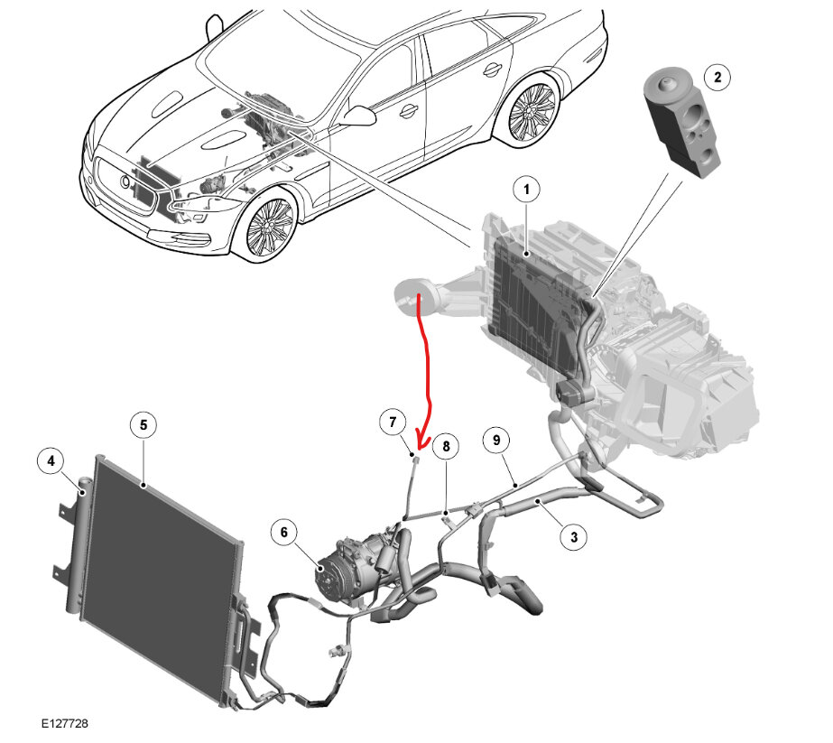

My A/C blowing hot air and cooling fan not coming on when A/C is on. I'm not sure if compressor working can't find it. Thank you

Most of the time when this happens it is because the A/C system is low on refrigerant.
Here is a video to show you how to check the system:
https://youtu.be/uZrQCGwXfek?si=76AQumUc8Lckbxin
If the system is empty, you have a leak.
https://www.2carpros.com/articles/air-conditioner-leak-detection
There is a guide to help as well:
Let us know what happens and please upload pictures or videos of the problem so we can see what's going on.

I want to add coolant not sure where low pressure port is.

This video will help, and I have an image to show you as well:
https://youtu.be/ON2dYcmXIAw?si=5kv594W4gIA7f6Y_
