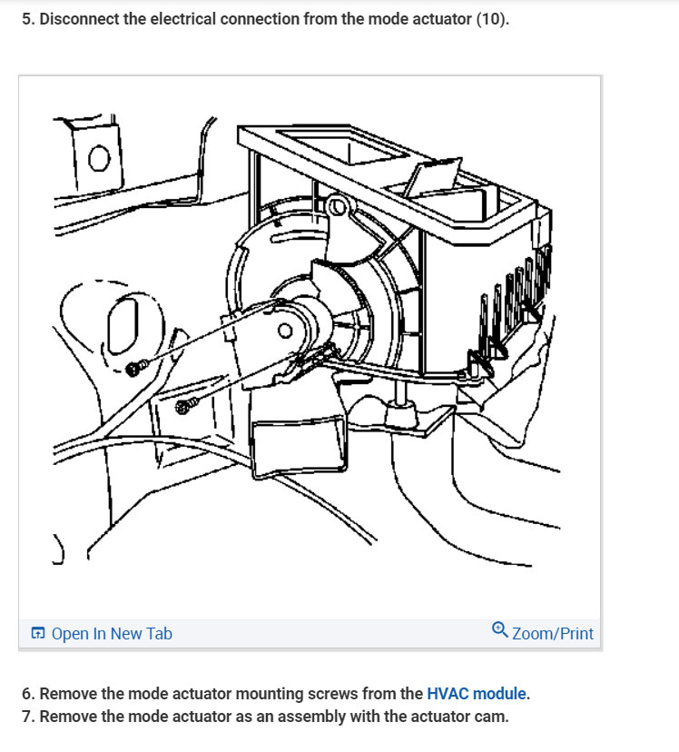

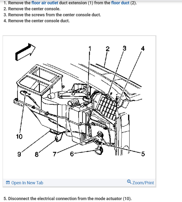

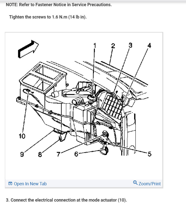

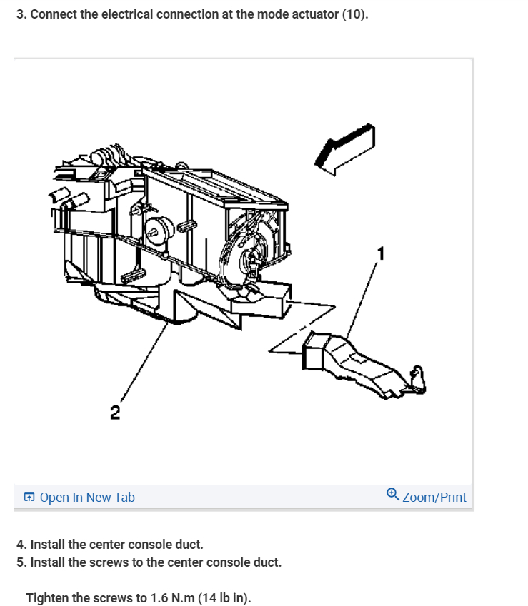

When I turn my AC on the front doesn't work. Doesn't blow hot or cold nor does it blow through defrost vents. It doesn't blow on front floor vents but it does blow through center vents.
Jul 31, 2023 at 10:17 PM
  • 55,456 POSTS

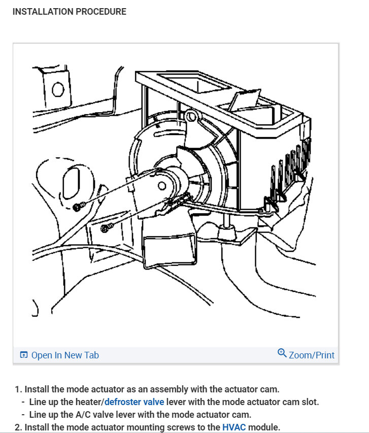

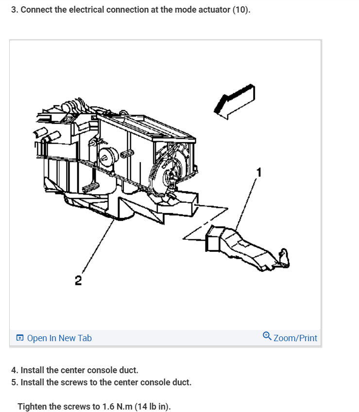

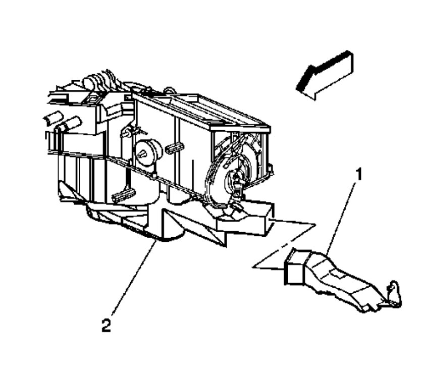

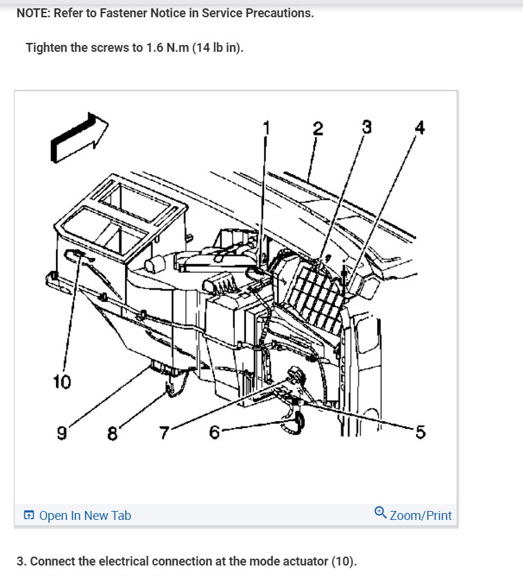

Yep, this happens when the mode blend door actuator goes out. Here is a guide to help with instructions in the images below to help you with your car:
Check out the images (below). Please let us know if you need anything else to get the problem fixed.
