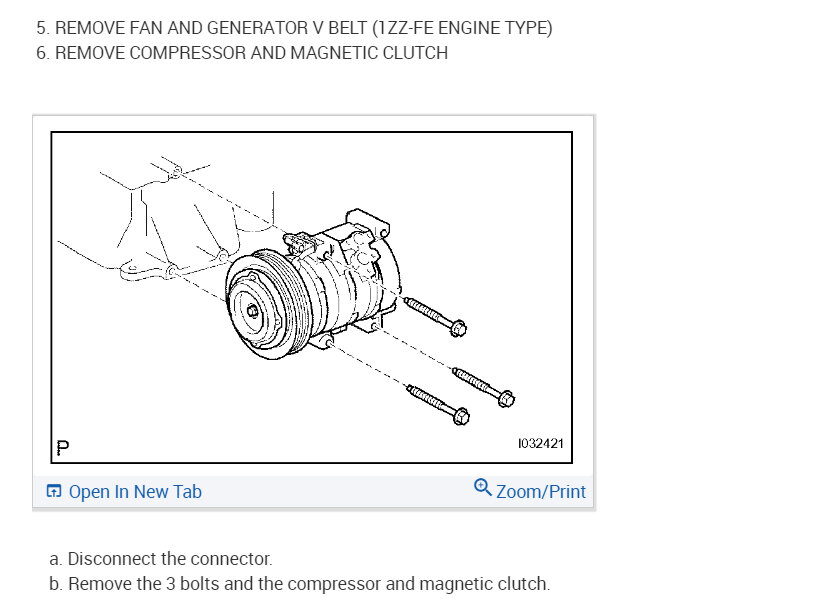

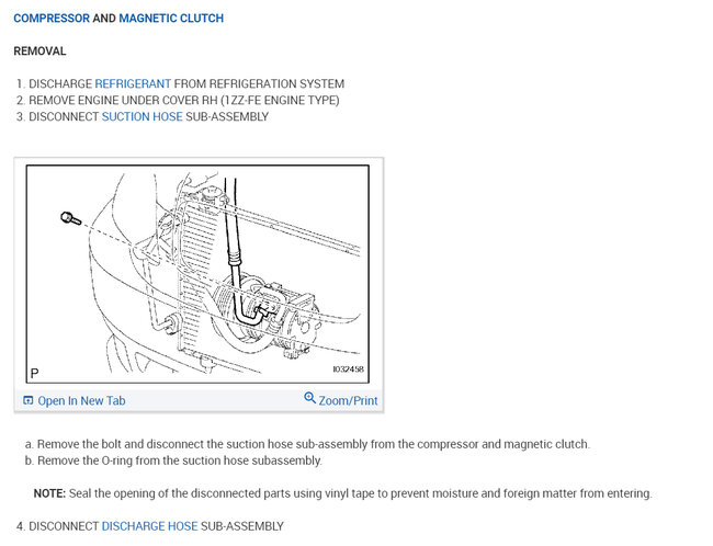

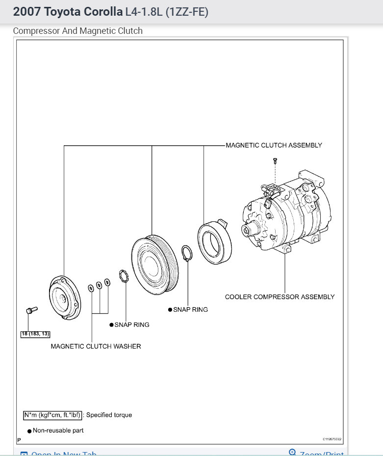

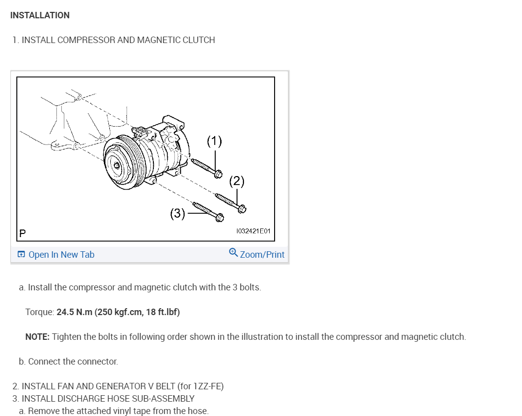

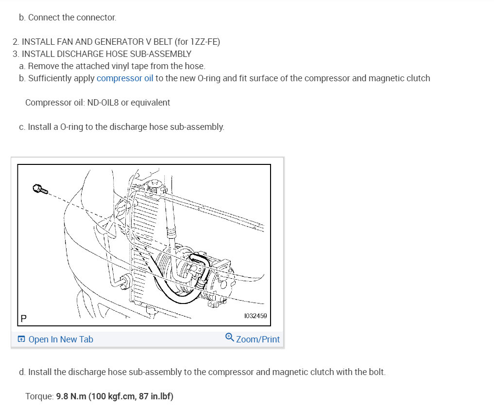

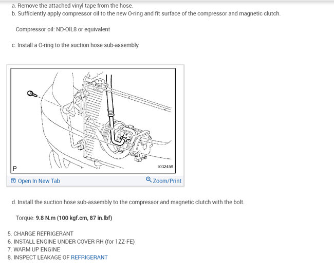

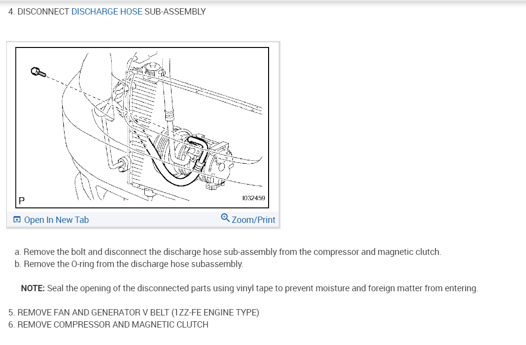

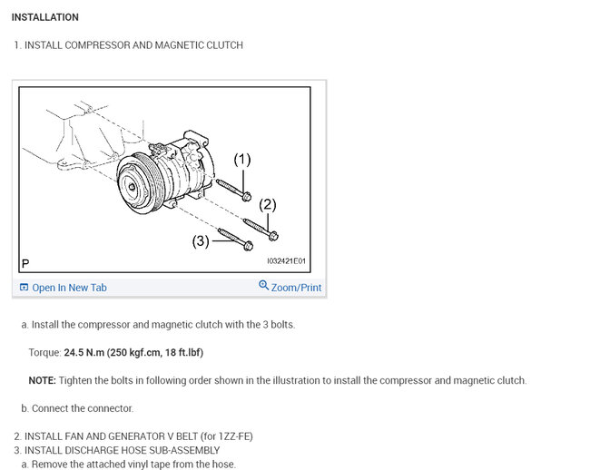

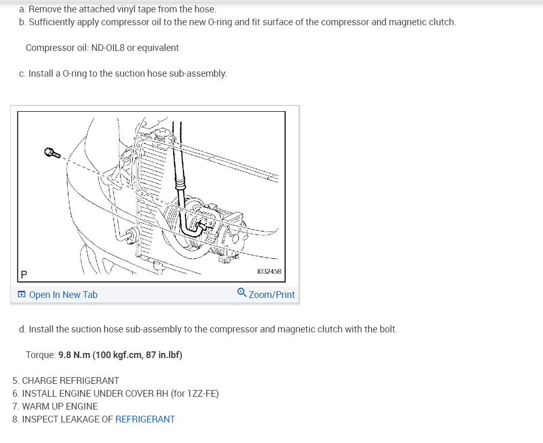

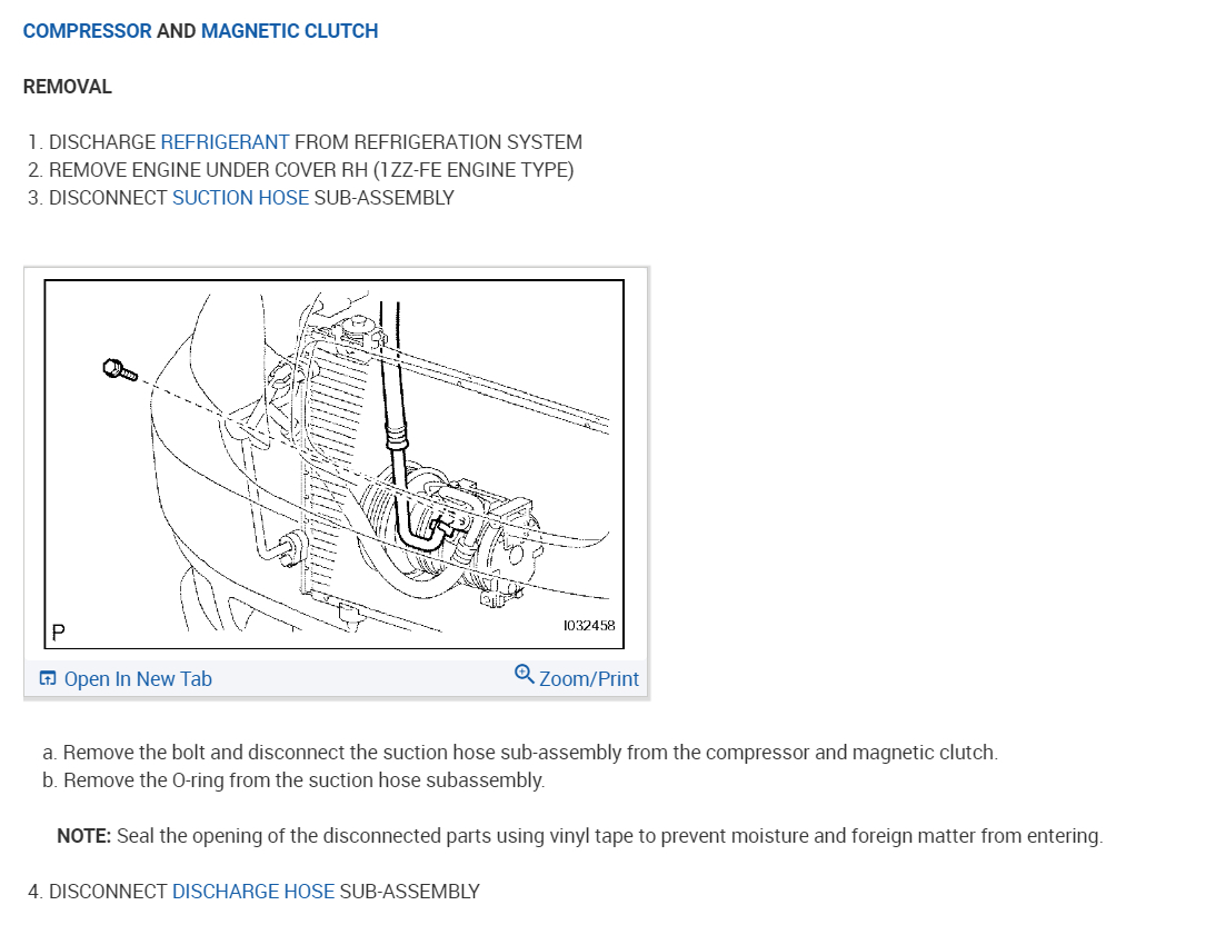

Okay, you have found the problem; the compressor coil is bad and needs to be replaced. You may need to remove the compressor which at this time you may consider replacing it as a whole unit. Here is how the job is done step by step and I have included instructions in the images below for your car.
https://www.2carpros.com/articles/comprehensive-guide-how-to-replace-an-ac-compressor-clutch-on-a-car
You will need to follow this video:
https://youtu.be/4EqdrBVb0sY
May 25, 2023 at 3:36 AM
