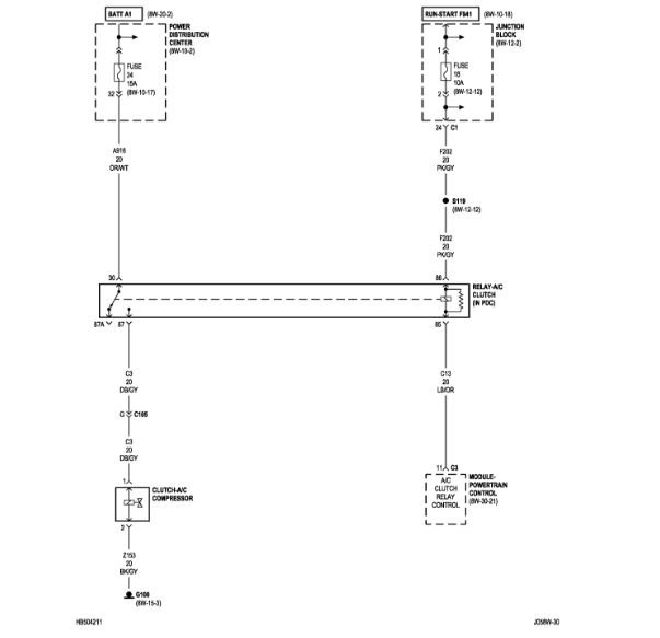

New A/C compressor stopped working
2005 DODGE DURANGO
174,000 MILES • 3.6L • V6 • 2WD • AUTOMATIC
BILL FOSTER2
New compressor. Kept going on and off on and off. Was cooling great, then just quit working. Compressor will not come on. Will not take any more Freon.
Jun 14, 2018 at 6:37 PM
Good morning.
What are the high and low side pressure in the system?
Did you check for voltage at the compressor?

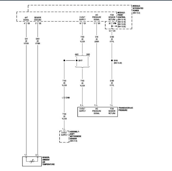

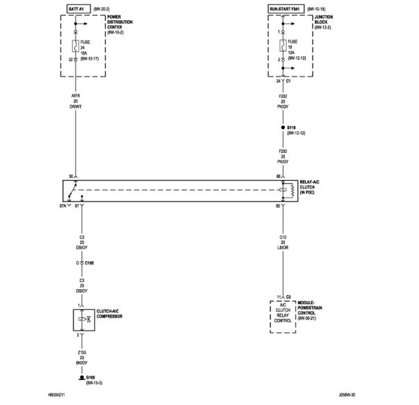

I attached a wire diagram. Make sure you have power to the relay and 5 volt reference to the pressure switch.
