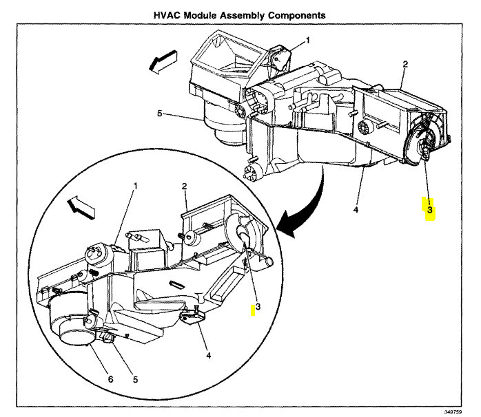

I have 2 HVAC issues.
1- I charged the A/C yesterday and the air still isn't very cold like it should be.
2- the air flow doesn't change from defrost to vent when I change the selector.
Jun 3, 2023 at 10:07 AM
  • 110,248 POSTS
The airflow direction is controlled by a mode door actuator. It is located on the passenger side of the HVAC unit under the dash. See pic 1 below. When you switch air flow direction, see if you can feel that moving.
As far as the A/C, are you sure it is fully charged? Also, take a look in front of the coolant radiation at the condenser. Make sure it is clean and there are no obstructions.
Do this and let me know what you find.
See pic below.
