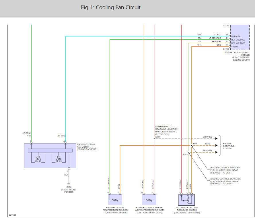

A/C blows cold air on highway but in stop and go traffic it blows warm air
2006 FORD FIVE HUNDRED
118,000 MILES
DAVIDBRYANT36
I am having trouble understanding why after charging system if I am driving down the road the A/C is working and yet if we are in town light to light it will blow hot air as we set there waiting on lights. I am thinking the fan after your video I watched, but not positive here.
Jul 16, 2018 at 3:45 AM
  • 55,433 POSTS

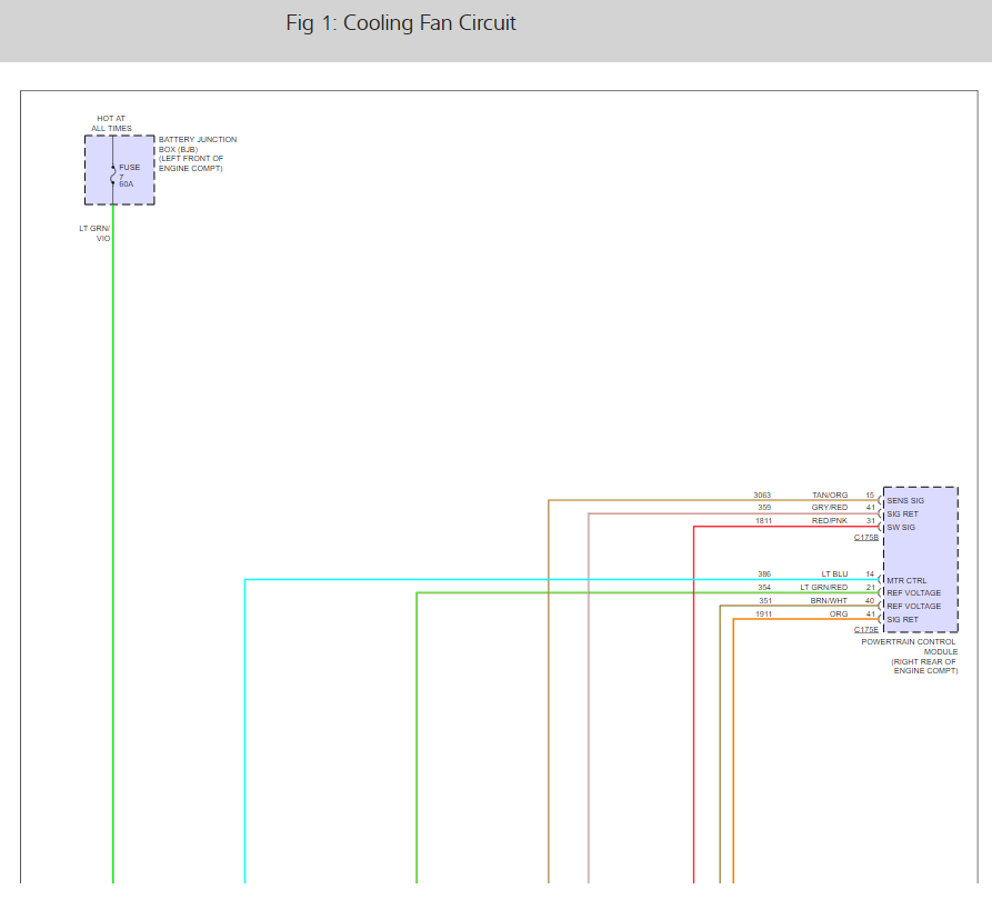

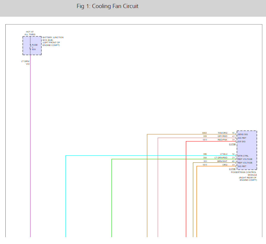

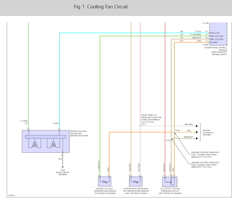

Yes, it sounds like the cooling fan is not coming on. Can you start the car (cold) and turn on the AC you should hear the fan kick on within one minute?
Here are the fan wiring diagrams so you can see how the system works.
Please report back.
