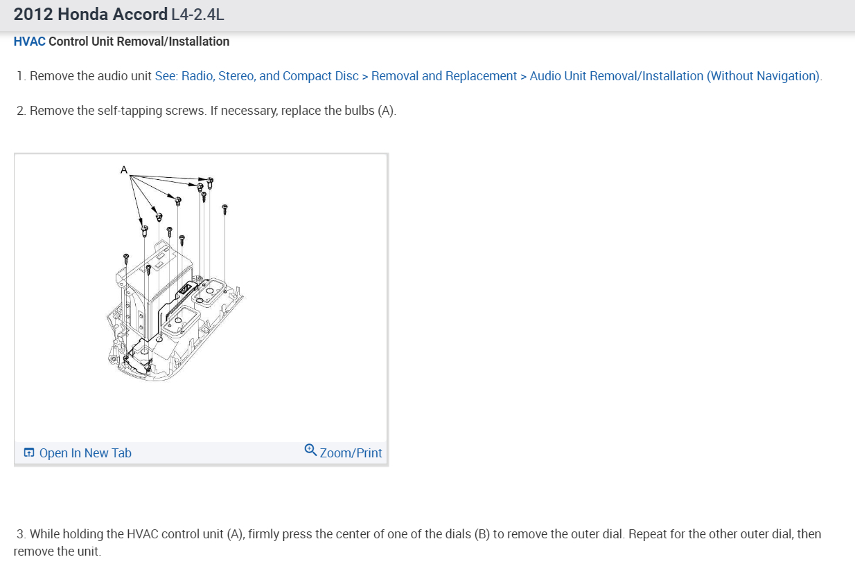

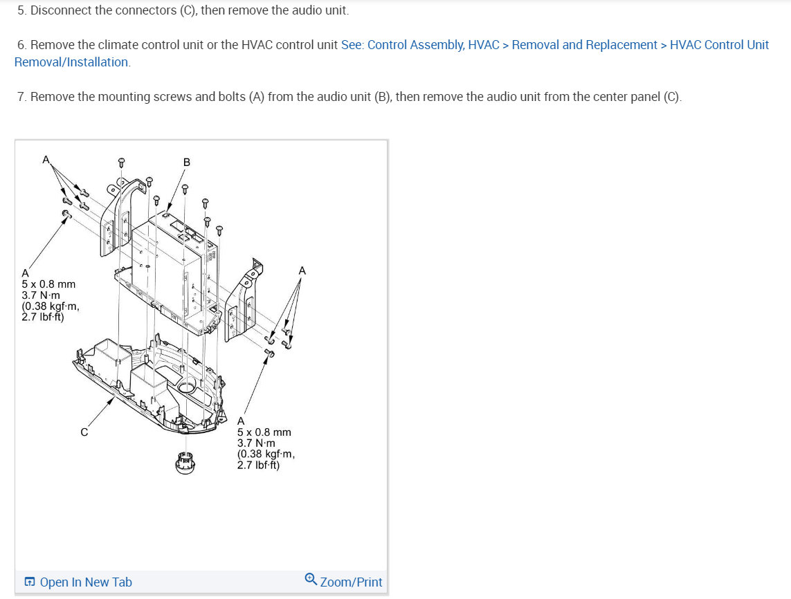

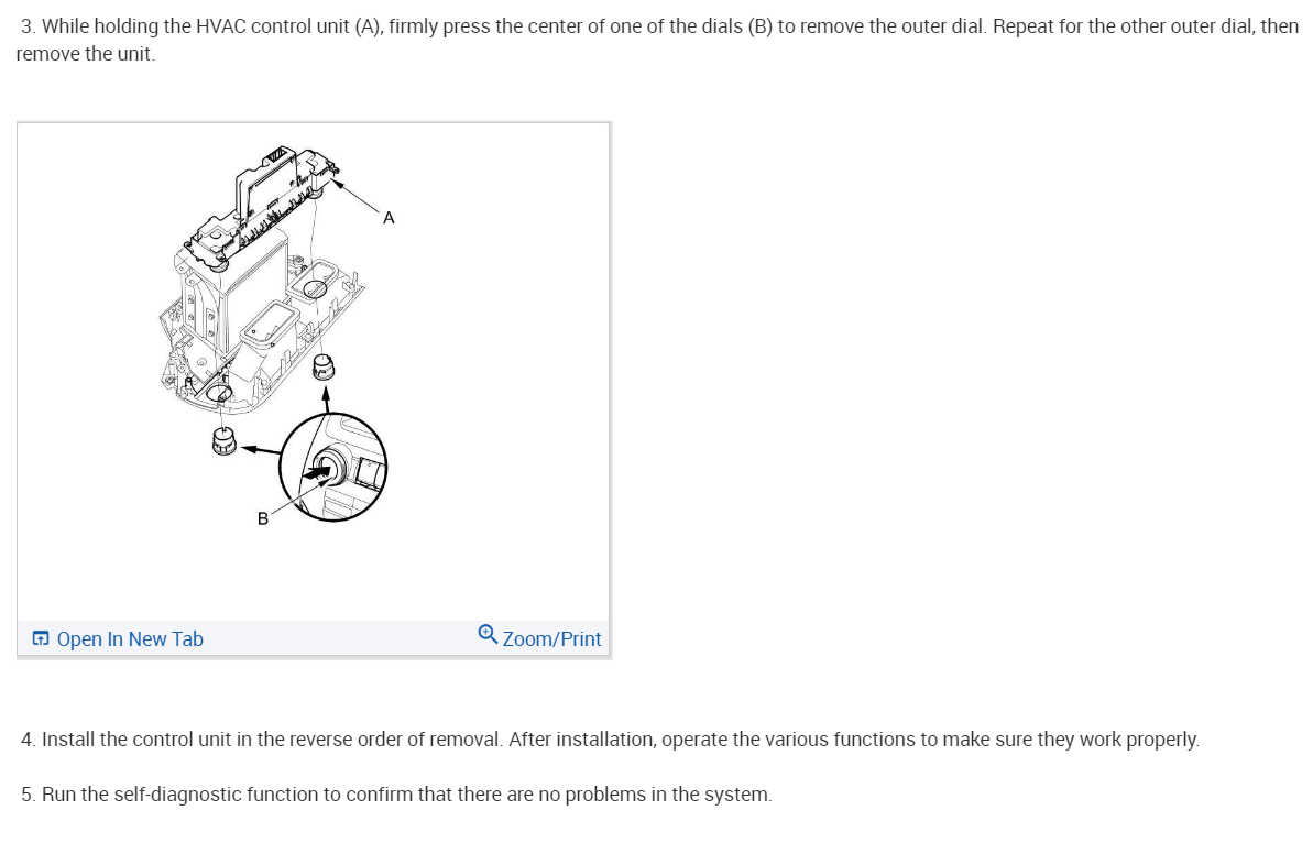

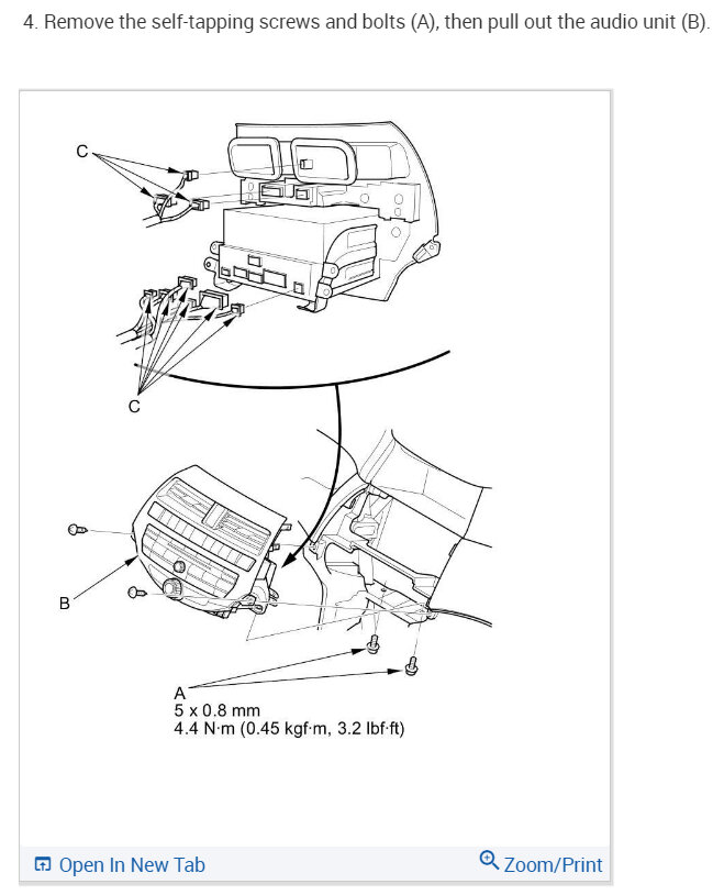

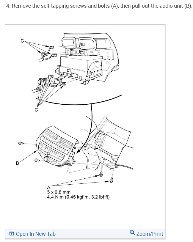

It sounds like the HVAC controller is resetting, I would run a CAN scan to confirm the issue. You can get a CAN scanner (Controller Area Network) which will work on most cars from Amazon.
here is a video to show you how:
https://youtu.be/u-4syLc-ifQ
here is how to change the HVAC controller out in case a code comes up for it. I would check the clutch coil for the compressor. I have seen defective units cause all kinds of strange problems. Check out the images (below). Let us know what happens and please upload pictures or videos of the problem so we can see what's going on.
