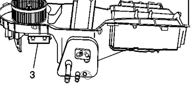

Where is the A/C evaporator drain plug located?

Good afternoon,
The drain for the evaporator is located next to the heater hose where it attaches to the heater core under the hood. It should be a rubber line. Check out the diagrams (Below). Please let us know what you find. We are interested to see what it is.
Image (Click to make bigger)
