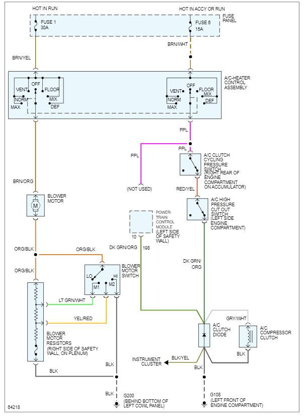

I need to wire in a trinary switch to my A/C for electric fans?
1995 FORD F-250
341,000 MILES • 7.5L • V8 • 4WD • AUTOMATIC
QUADRACER777
I need to wire in a trinary switch to my A/C for electric fans. I have Ford factory electrical manual, it shows a R/Y and P coming from cycling switch. I have a B/Y and P (this is factory). Is the B/Y going to be the same as the R/Y in the manual ???
Aug 28, 2023 at 11:34 PM
  • 55,224 POSTS

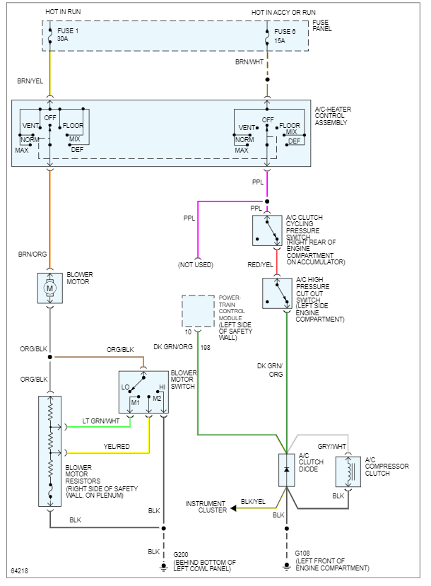

It should be though I show the R/Y as well, here are the A/C wiring diagrams to help you complete the task. Check out the images (below). Please let us know if you need anything else to get the problem fixed.
