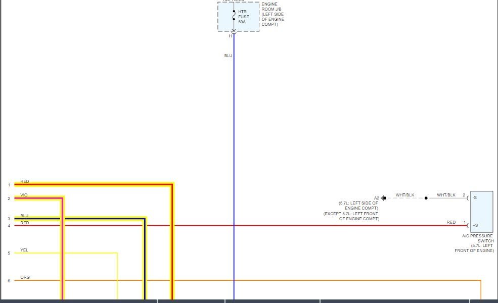

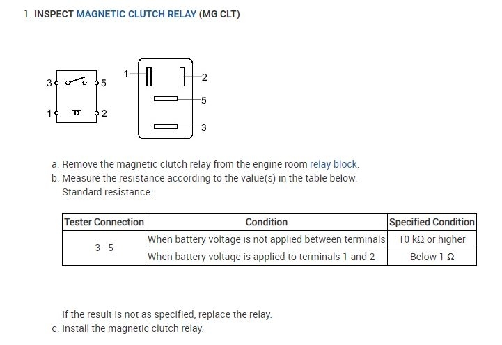

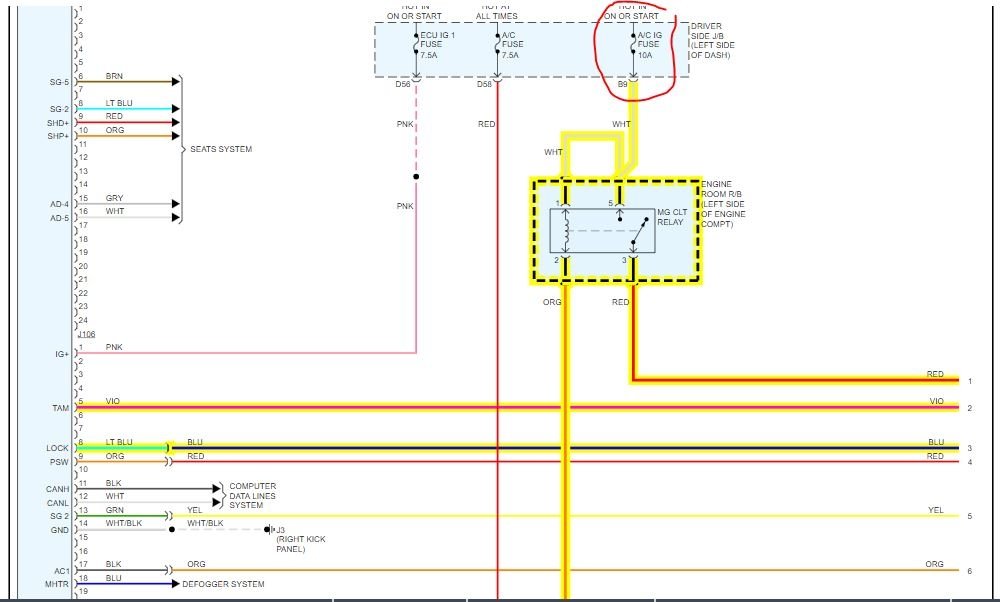

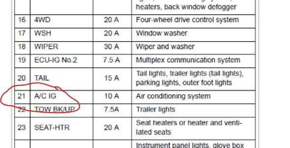

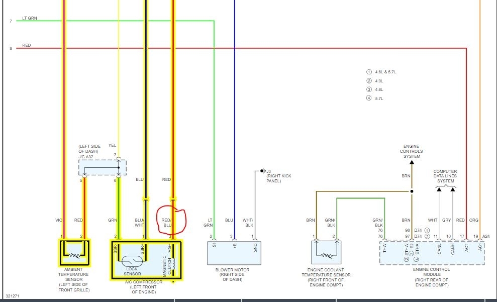

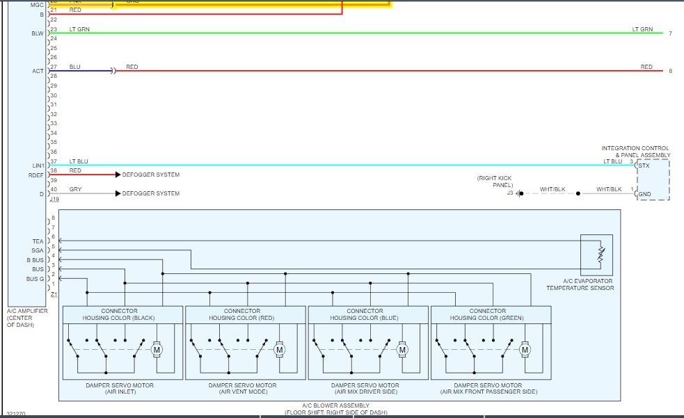

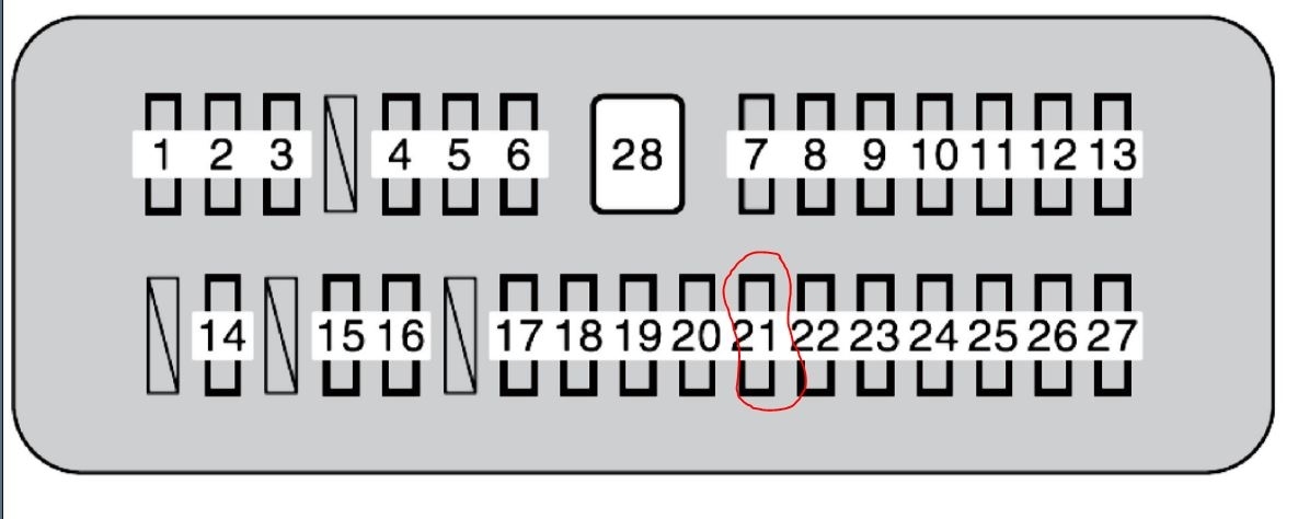

Once I repaired a loose negative battery connection the air conditioner stopped working.
Mar 29, 2021 at 7:49 AM
Experienced Mechanic
52,796 POSTS
Good evening,
I attached the diagram of the system for you. I circled the fuse that controls the clutch. Check it for power on both sides.
