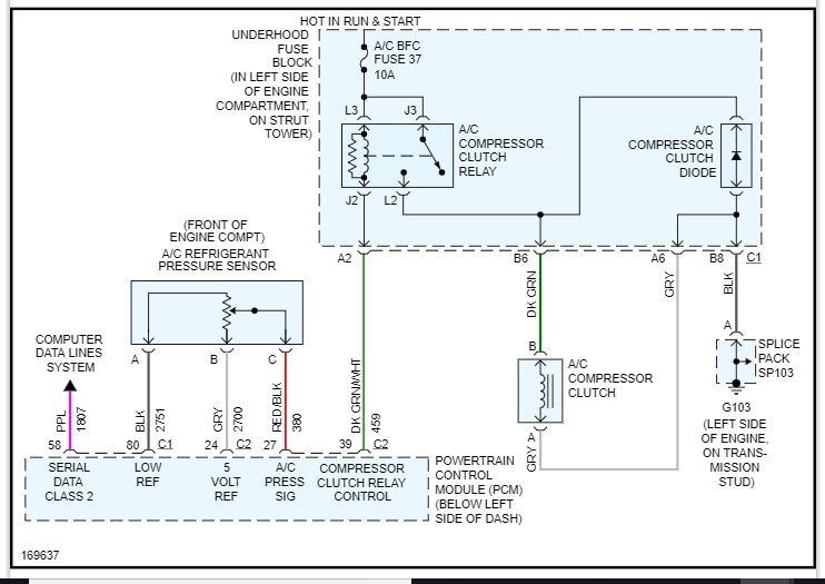

The Freon is full, the compressor turns, the front grills are clean and the fans turn.
Feb 11, 2019 at 6:51 AM
Experienced Mechanic
52,796 POSTS
Good afternoon,
Does or is the clutch engaged and turning?
Do you have a set of gauges to give me the pressures?
I attached a wiring diagram for you to view. Can you test for some voltages? Check the fuse listed for the compressor.
