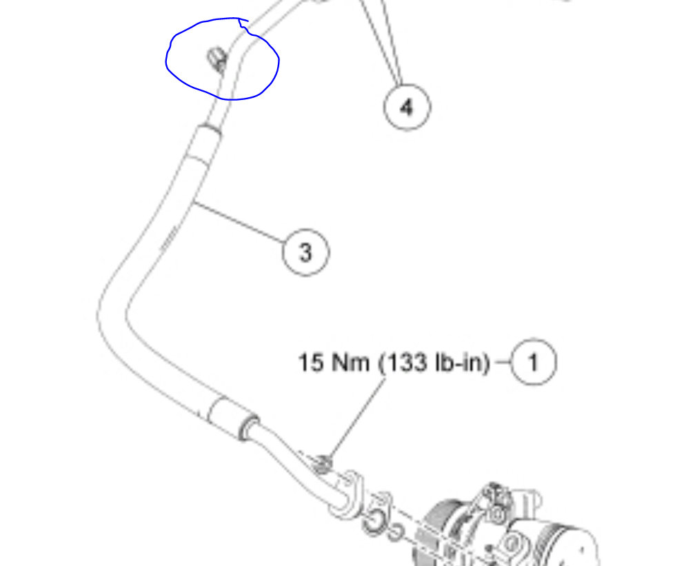

The A/C in car won’t work. When I first turn it on it blows out cold air and then it comes hot. I want to try and recharge it but I can’t find the low port to charge it. I have looked everywhere for it.

Good afternoon,
I attached a picture of the line that has the fitting.
Look under the car passenger side. It is inside the fender well.

Here I have the port circled. Do you know where the other port is by chance ?

Okay, I attached the location of the high side service port for you. It is right at the line where the evaporator is bolted to the manifold line assembly.
