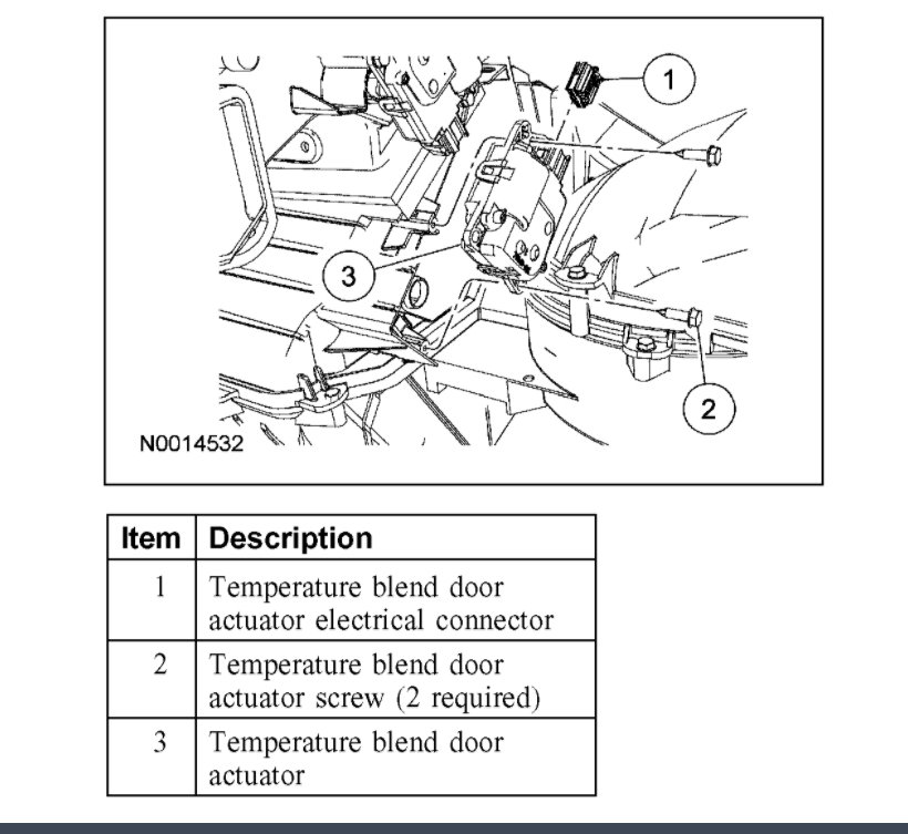

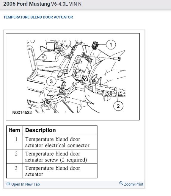

When you command heat and cool, can you hear the blend door move back and forth in the dash?

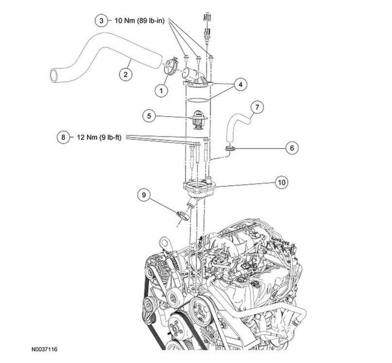

https://www.2carpros.com/articles/how-an-engine-thermostat-works
Removal and Installation
1. Lower the glove compartment.
2. Disconnect the temperature blend door actuator electrical connector.
3. Remove the 2 temperature blend door actuator screws.
4. Remove the temperature blend door actuator.
5. To install, reverse the removal procedure.

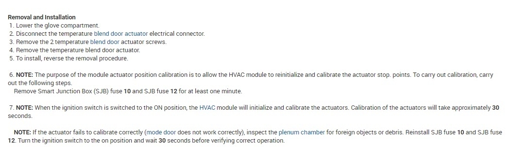

6. NOTE: The purpose of the module actuator position calibration is to allow the HVAC module to reinitialize and calibrate the actuator stop. points. To carry out calibration, carry out the following steps.
Remove Smart Junction Box (SJB) fuse 10 and SJB fuse 12 for at least one minute.
7. NOTE: When the ignition switch is switched to the "on" position, the HVAC module will initialize and calibrate the actuators. Calibration of the actuators will take approximately 30 seconds.
NOTE: If the actuator fails to calibrate correctly (mode door does not work correctly), inspect the plenum chamber for foreign objects or debris. Reinstall SJB fuse 10 and SJB fuse 12. Turn the ignition switch to the on position and wait 30 seconds before verifying correct operation.

4. Remove the 3 upper thermostat housing bolts and position aside the thermostat housing.
- Discard the thermostat O-ring seal.
- To install, tighten to 10 Nm (89 lb-in).
5. Remove the thermostat.
6. To install, reverse the removal procedure.
- Install a new thermostat O-ring seal and lubricate with clean engine coolant.
7. Fill and bleed the cooling system.

The first thing to check is the coolant level. The heater cannot operate without warm coolant flowing into the heater core. The next most common thing on these vehicles is a faulty temperature blend door actuator, if your car was making a "click click click" sound in the past, most likely this is the culprit. And last but not least most common failure is a stuck open thermostat, this will not allow your engine coolant to reach full operating temperature. Here is guide that can also explain with pictures. I've also added the instructions on how to replace the blend door actuator if needed.
