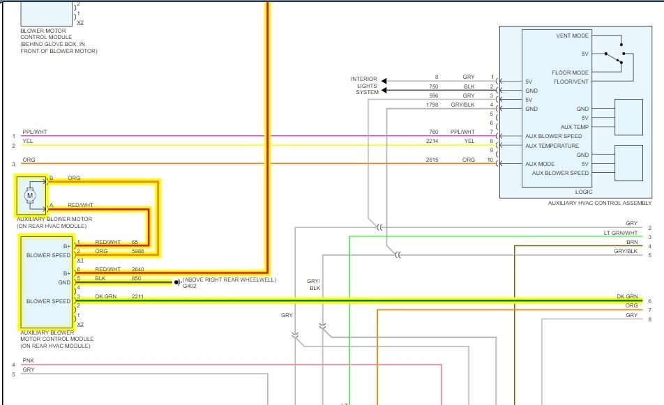

No blower working in rear for heat or A/C.

Can you do some testing for the rear blower with a test light or voltmeter?
I attached a wiring diagram for you to view.

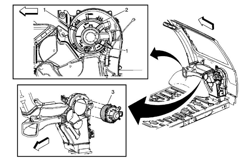

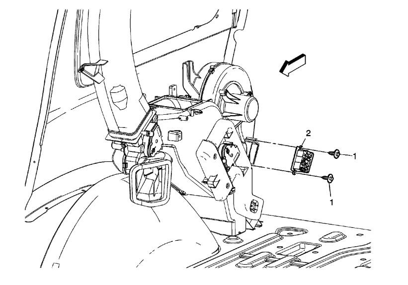

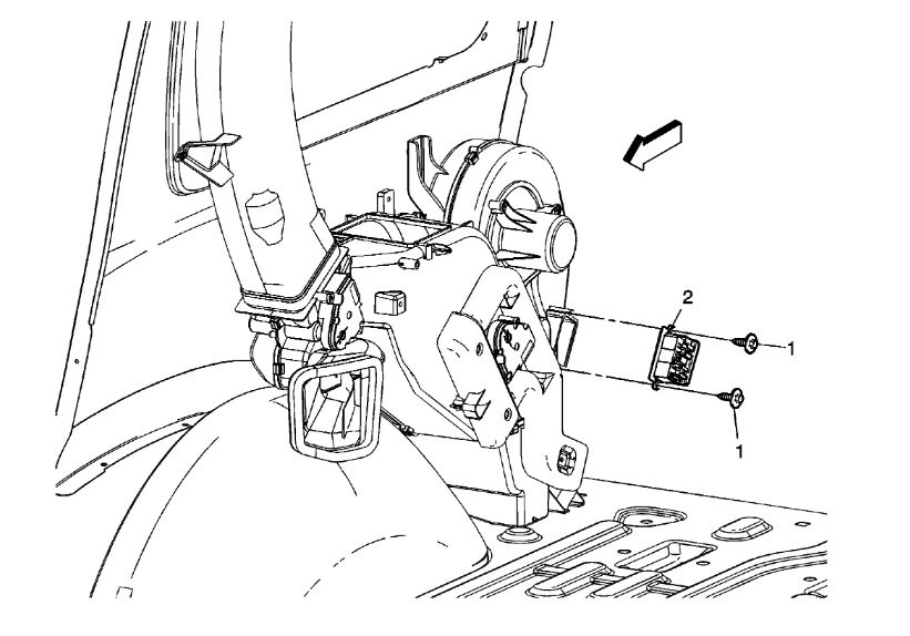

And the blower motor is in right rear of car?
Sunday, December 22nd, 2019 AT 1:45 PM
MECHANIC
52,797 POSTS
Correct. I sent pictures of the location for you.
