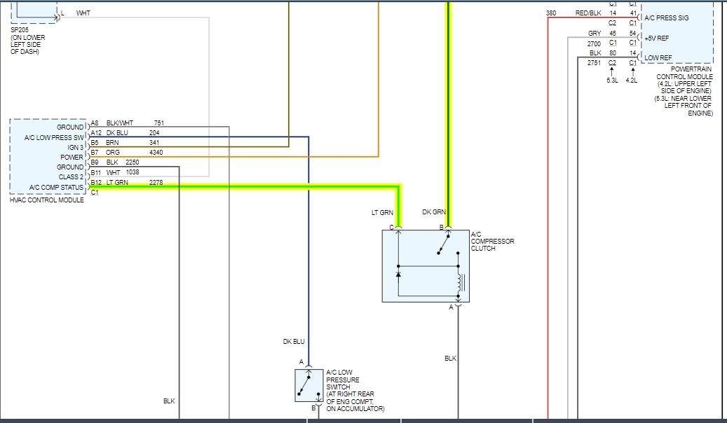

It worked fine last year. the Freon has full charge. i jumped the relay and the clutch kicked in, but will not engage otherwise.
Jun 20, 2020 at 12:07 PM
Good afternoon,
How do you know it is fully charged?
Do you have gauges to give me the high and low side readings?

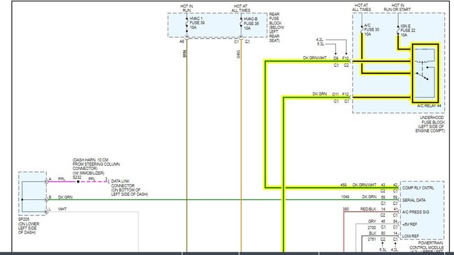

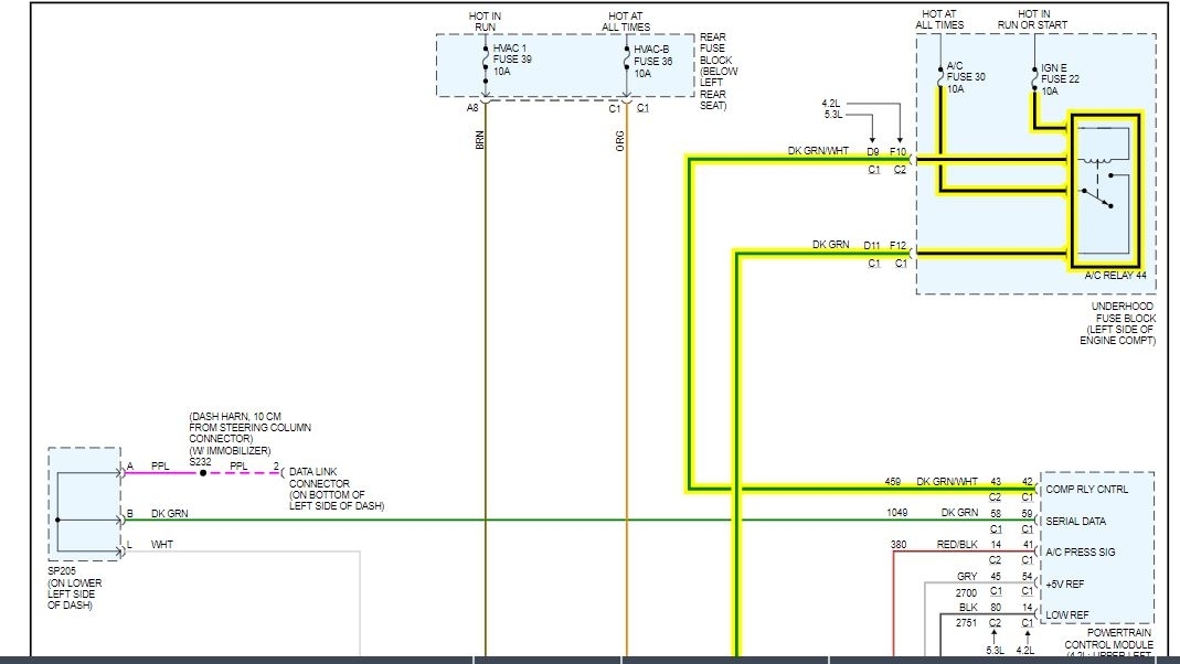

I attached a diagram for you to view. Do you have a voltmeter to do some checks?
