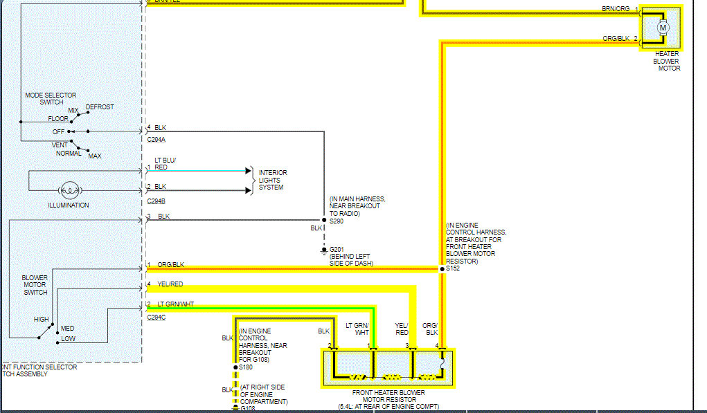

air will not blow out vents until you turn blower motor to low.
Aug 7, 2020 at 7:53 AM
Good afternoon,

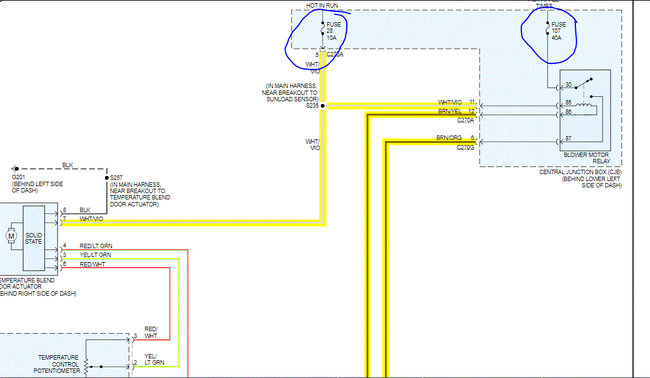

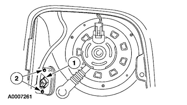

I attached the wiring diagram for you of the blower motor and resistor. In most cases, it is the resistor but the reason it fails is high draw from the blower motor. I would replace the blower motor and resistor. They are right next to each other under the dash.
https://www.2carpros.com/articles/blower-fan-motor-works-on-high-speed-only
Check the fuses I circled as well for power on both sides.
BLOWER MOTOR RESISTOR
REMOVAL
1. Remove the RH rear quarter trim panel access panel.
2. Remove the heater blower motor resistor.
1 Disconnect the electrical connector.
2 Remove the screws and remove the blower motor resistor.

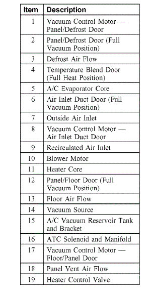

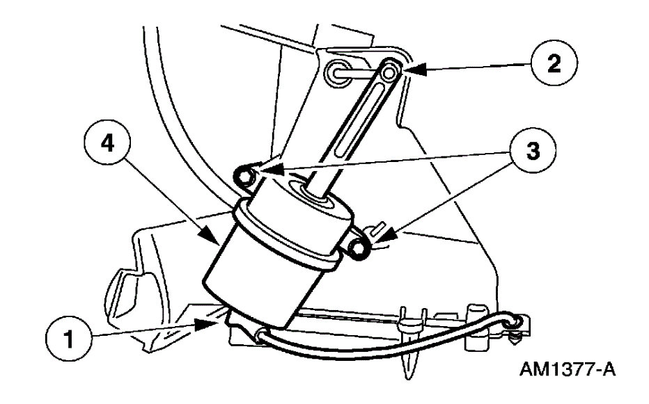

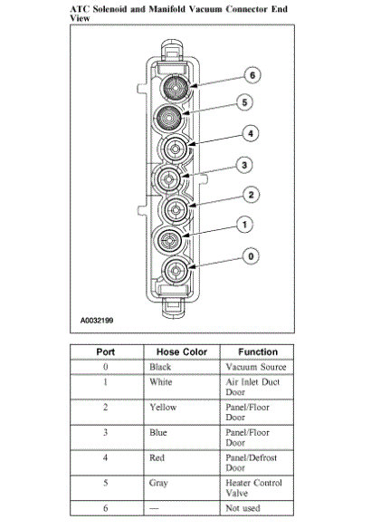

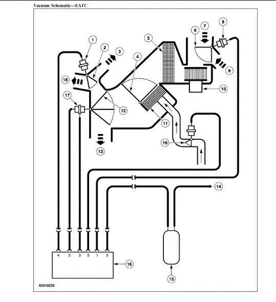

The blower motor blows on all speeds but the mode door vacuum actuator does not pull in completely to put air through the vents unless you turn blower motor to low speed then it will fully actuate the vents.
Aug 7, 2020 at 11:56 AM

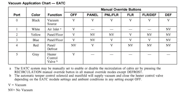

Okay, the way you worded your question, it sounded like the blower was only working on low.
Do you have a vacuum gauge to check the vacuum to the motors?
I attached the vacuum diagram for you to view. You will need to test for the vacuum at the proper times.
From your description, it sounds like the control head is bad.
Aug 7, 2020 at 10:40 PM
PORTAFISHING
  • 37 POSTS
I put a vacuum gauge on it and it's showing 5" of vacuum.
what is it suppose to be? It's identical to the first image you sent me of the vacuum actuator.
Aug 8, 2020 at 11:13 AM
The vacuum is low. It should be more than that. It comes from the control head.
When you hook up the hose, does the arm move?
Aug 8, 2020 at 9:18 PM
PORTAFISHING
  • 37 POSTS

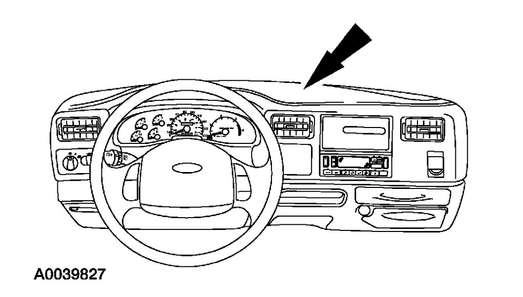

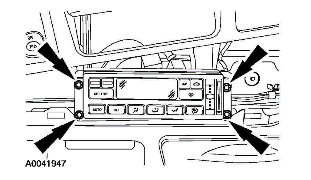

yes it does but only part way. If blower is on low sometimes it will switch. Where is control head?
Aug 8, 2020 at 10:52 PM
It is in the dash. That is what you turn on to make the system work. I attached pictures of it in my previous posts.
