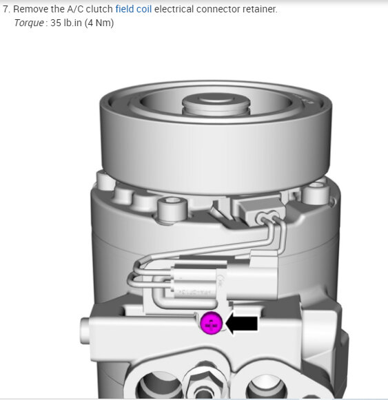

When we turn on our car it starts normally, but the A/C is blowing hot air. My husband checked to see if it needed to be recharged and that was good, so we checked to see if the fuse was blown, and it was. My husband has been checking the compressor. He unhooked the compressor and changed the fuse to see if it would blow again. It has been running for about 5 minutes and the fuse has not blown. Could this be the whole compressor that needs to be replaced? Or a different issue?

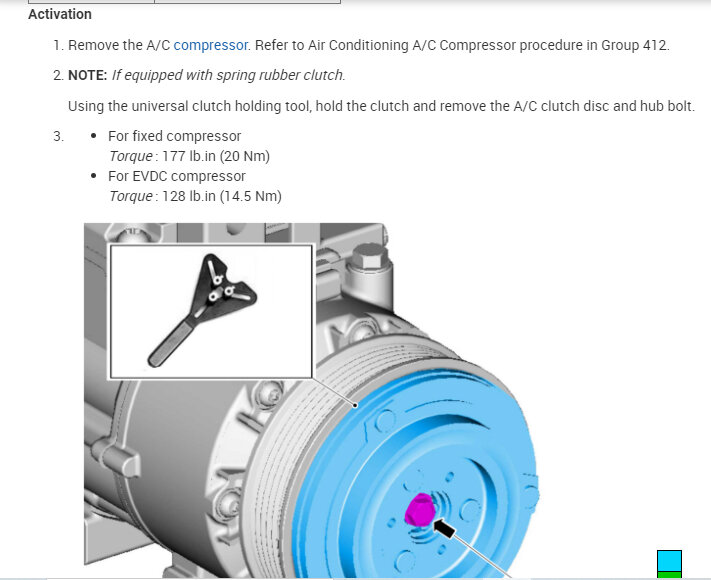

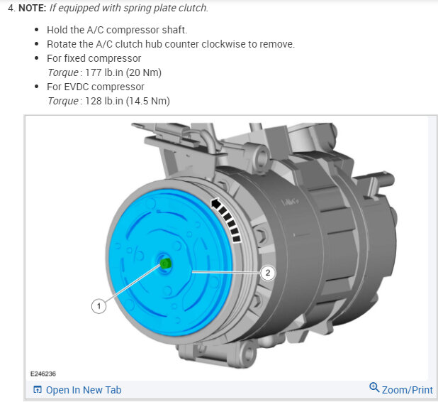

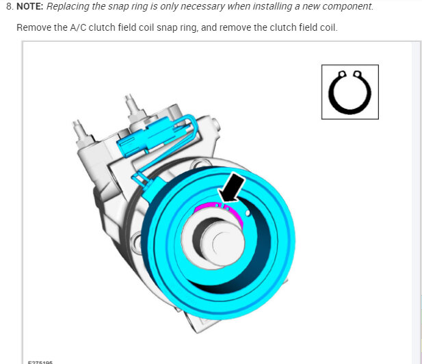

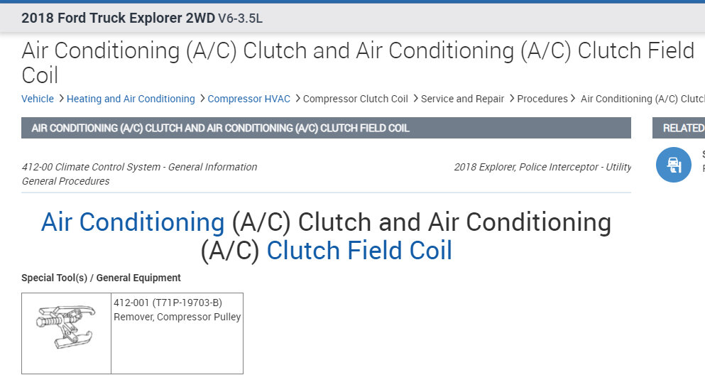

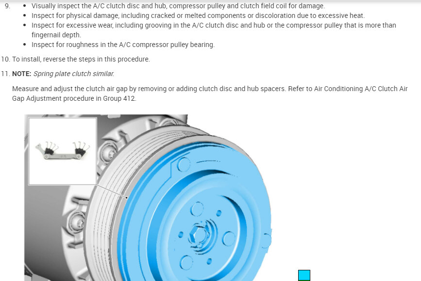

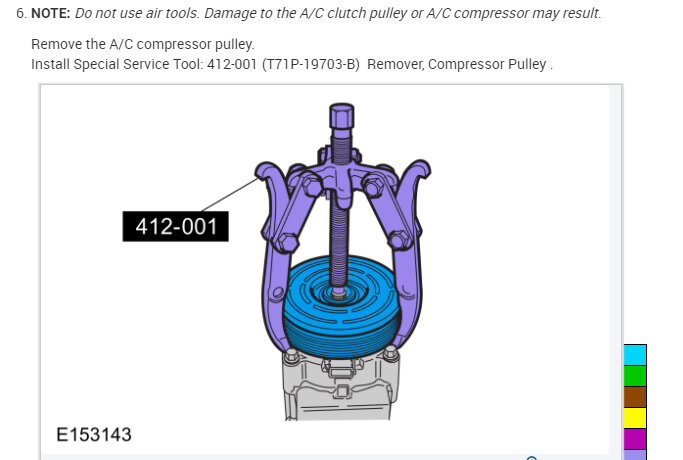

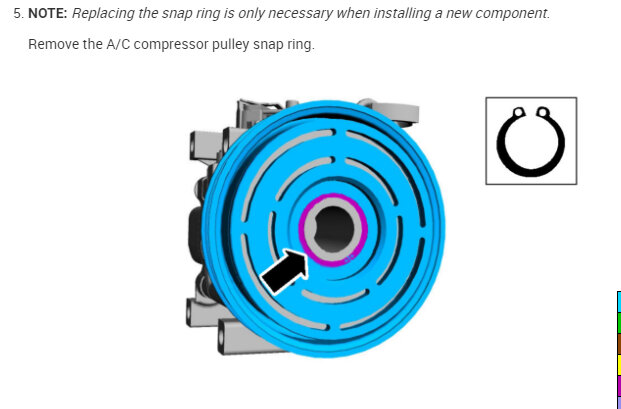

If I understand correctly, if you disconnect the power supply to the compressor, the fuse doesn't fail, correct?
As far as the possible cause, there is a chance it is the clutch coil that is shorted internally.
If you look below, I attached the directions for replacing the A/C clutch/coil assembly. The compressor will need to be removed, so the refrigerant will need to be recovered. Then the system will need a refilled.
Let me know if this helps.

If the fuse failed when the compressor was disconnected, then the compressor isn't causing it to fail. The compressor itself isn't electric. The only electric component is the clutch coil. That can cause the fuse to fail, but if it is disconnected, that wouldn't make sense.
Also, if the clutch coil is bad, it can be replaced rather than the entire compressor unless there is a known problem with the compressor.
