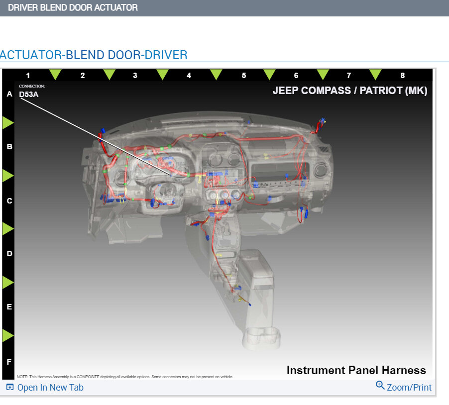

I watched the video at the link you provided but I already checked the level of refrigerant in my A/C and let the excess out and I did put it in the bottle that was used to recharge my A/C but I think it may be either my door actuator or the door that lets the heat from the engine in. It's running and feels cold until my engine heats up then I can't get any cool air. I just don't know where it is to close, or I would have done it already and I have searched the internet for days looking for anything to help. What do you think?
Jul 27, 2023 at 3:53 PM
  • 55,743 POSTS

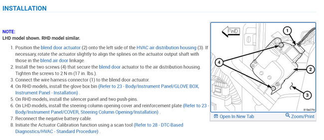

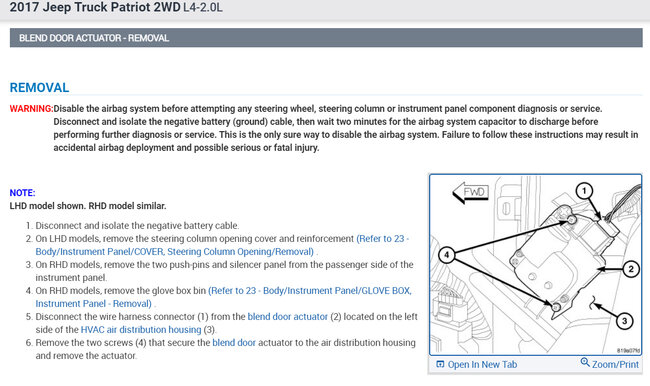

With the A/C running grasp the large refrigerant tube coming from the firewall to the compressor, if it is cold then yes, I would say the blend door actuator could be going bad and cause the problem you are having. Check out the images (below). Let us know what happens and please upload pictures or videos of the problem so we can see what's going on.
Jul 28, 2023 at 3:49 AM
