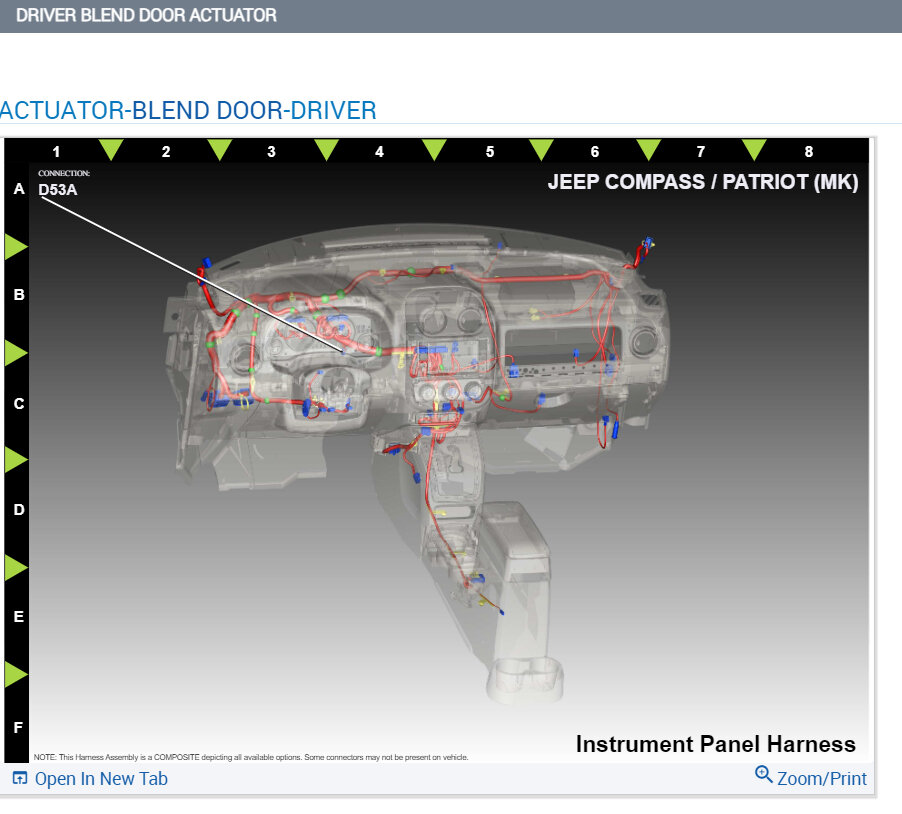

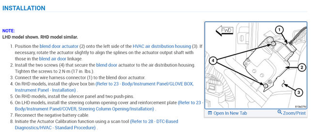

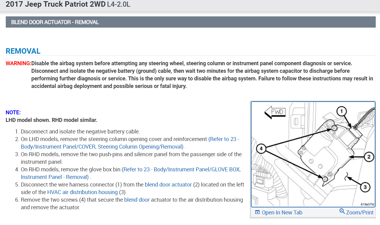

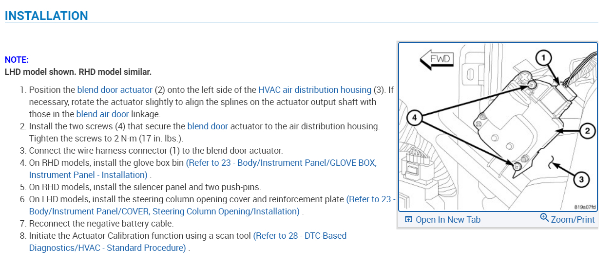

  • 55,402 POSTS
With the A/C running grasp the large refrigerant tube coming from the firewall to the compressor, if it is cold then yes, I would say the blend door actuator could be going bad and cause the problem you are having. Check out the images (below). Let us know what happens and please upload pictures or videos of the problem so we can see what's going on.
