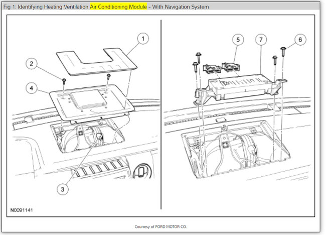

When on the A/C will switch from max A/C to just the regular hi speed on its own, and then come back on to max A/C again and sometimes it goes to defrost on its own, air is cold but switches back and forth on its own.
Jul 15, 2018 at 7:59 AM
  • 55,797 POSTS

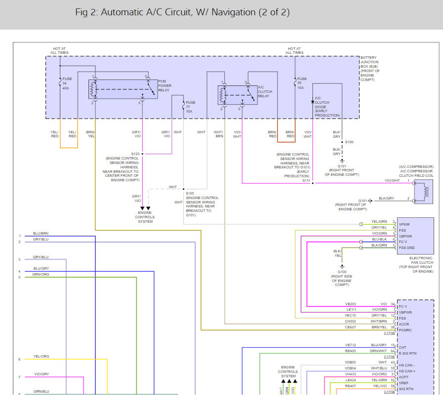

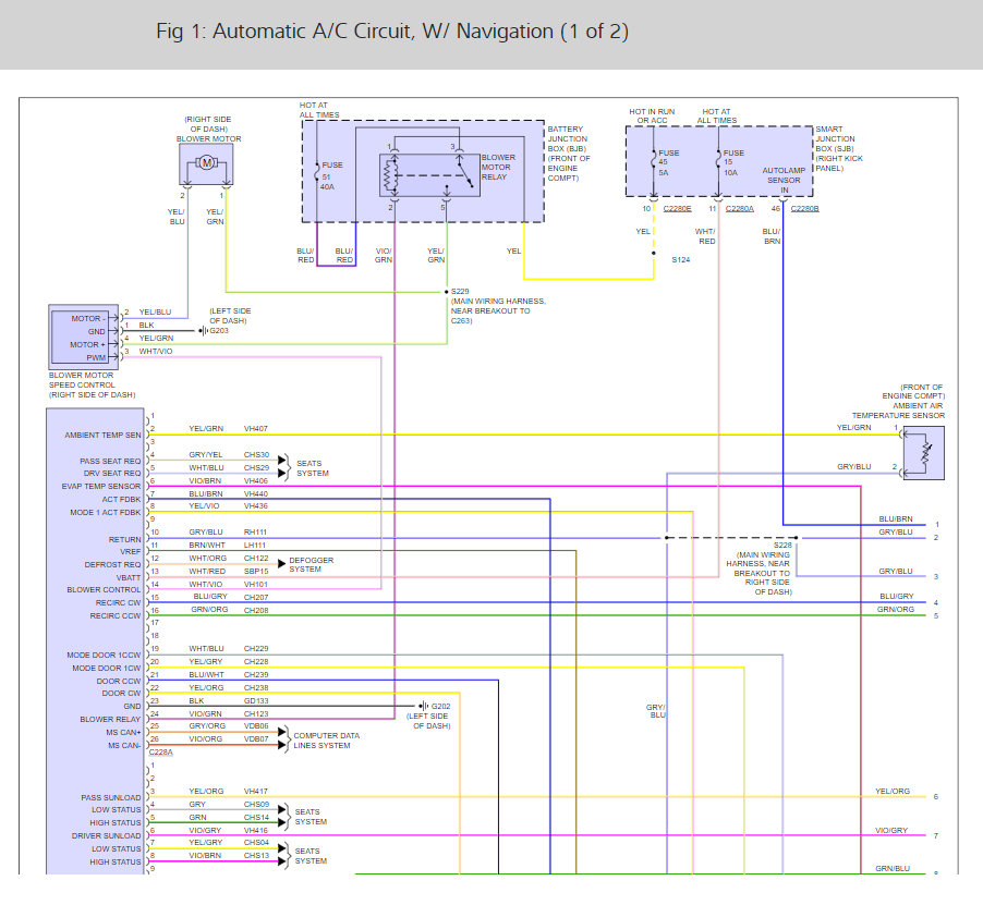

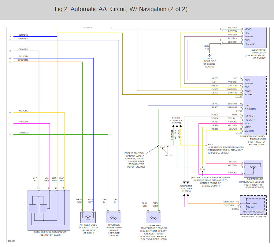

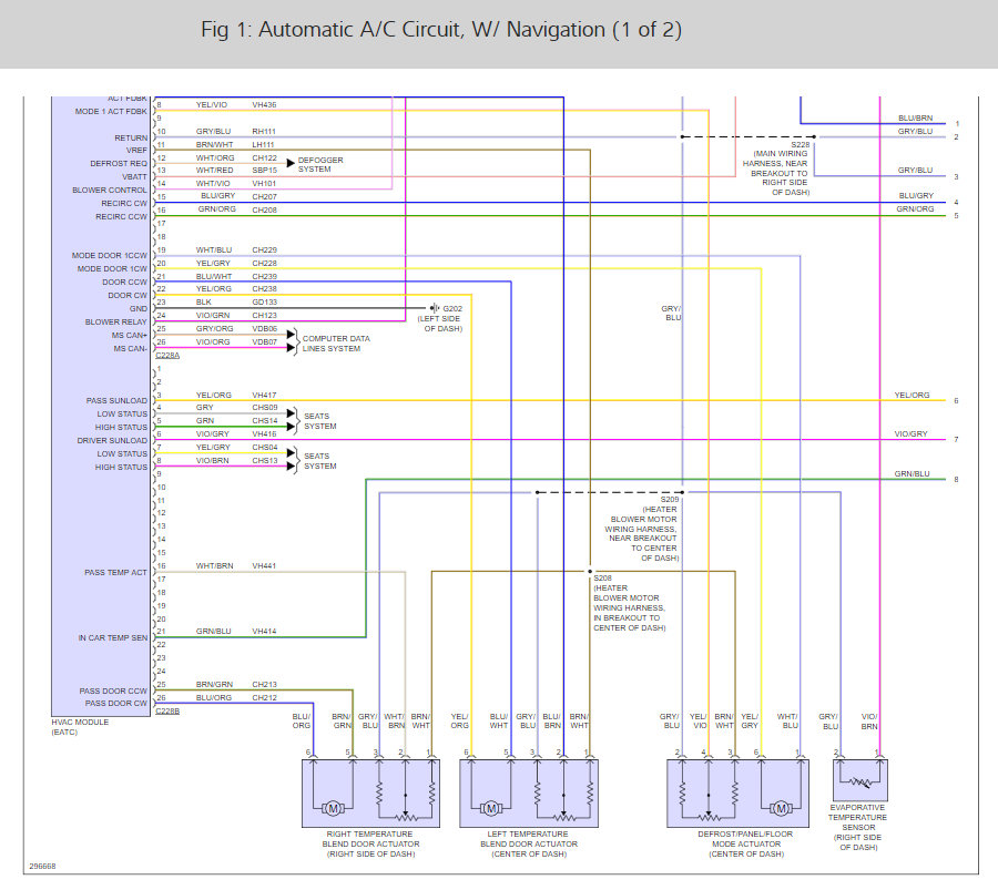

This sounds like the controller is bad causing the problem you have described. Here is a wiring diagram for the system so you can see how it works and the panel removal instructions. You can see the compass is tied to the HVAC system. I would try a used unit to see what happens use may need to get it initialized.
Check out the diagrams (below). Please run some tests and get back to us.
