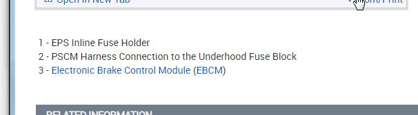

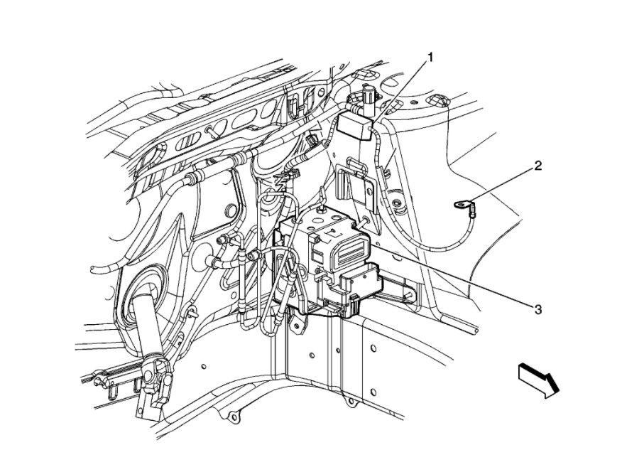

I cannot find the 80 amp mega fuse. We had to jump the battery and now the power steering and the gauges in the dash will not work.
Sep 21, 2017 at 2:27 AM
Experienced Mechanic
18,907 POSTS
Your 80A fuse is located on the left front struct tower near the A/C line.
Please see the attached documents below that will give more detail on where it is. Let us know if you need more info. Thanks
